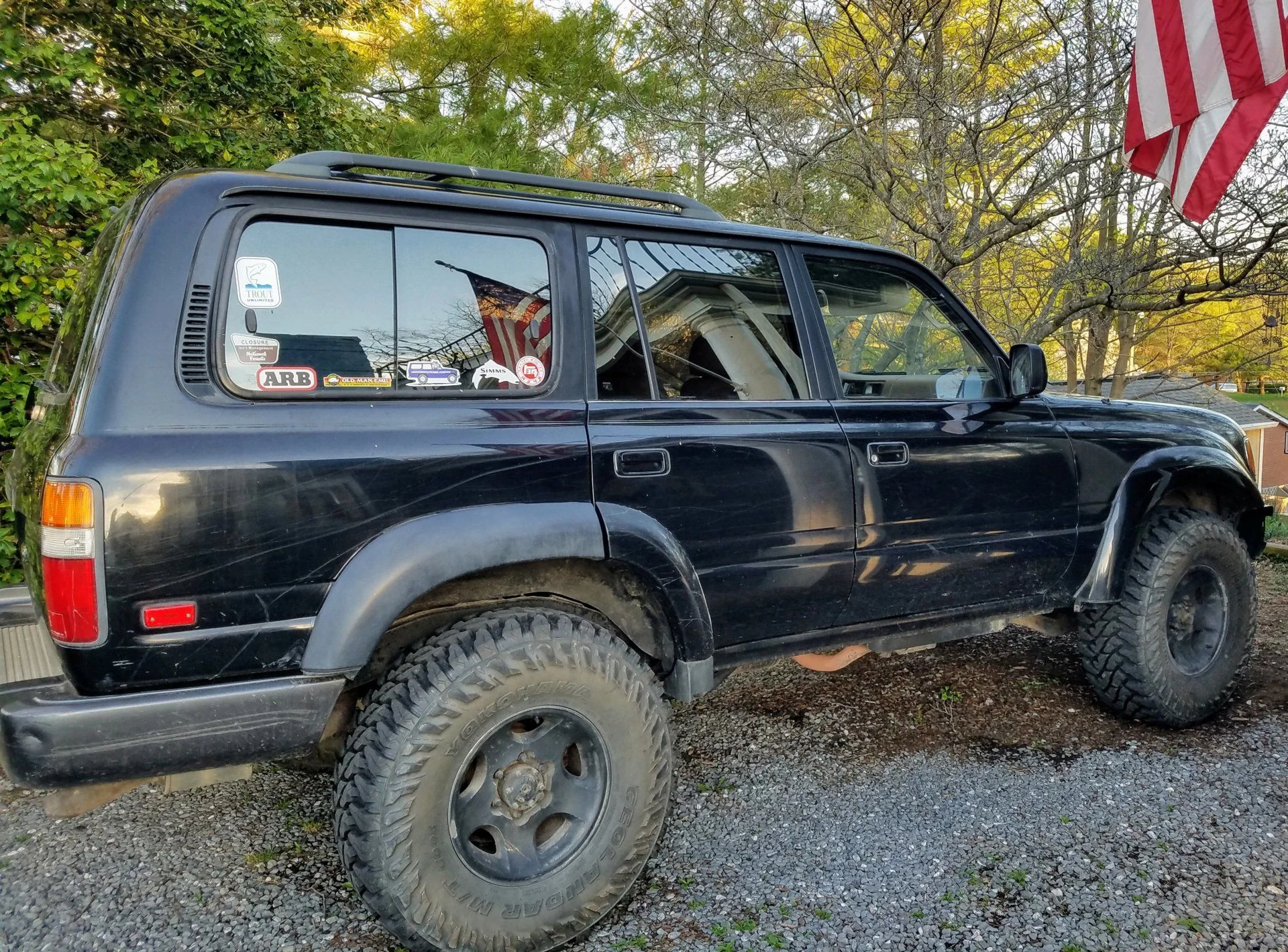

As was mentioned, many many have put 315/75 R16 tires on the factory rims without issue. Proof, here's mine when I still ran the stock wheels
IMG_8404 by Adam Tolman, on Flickr

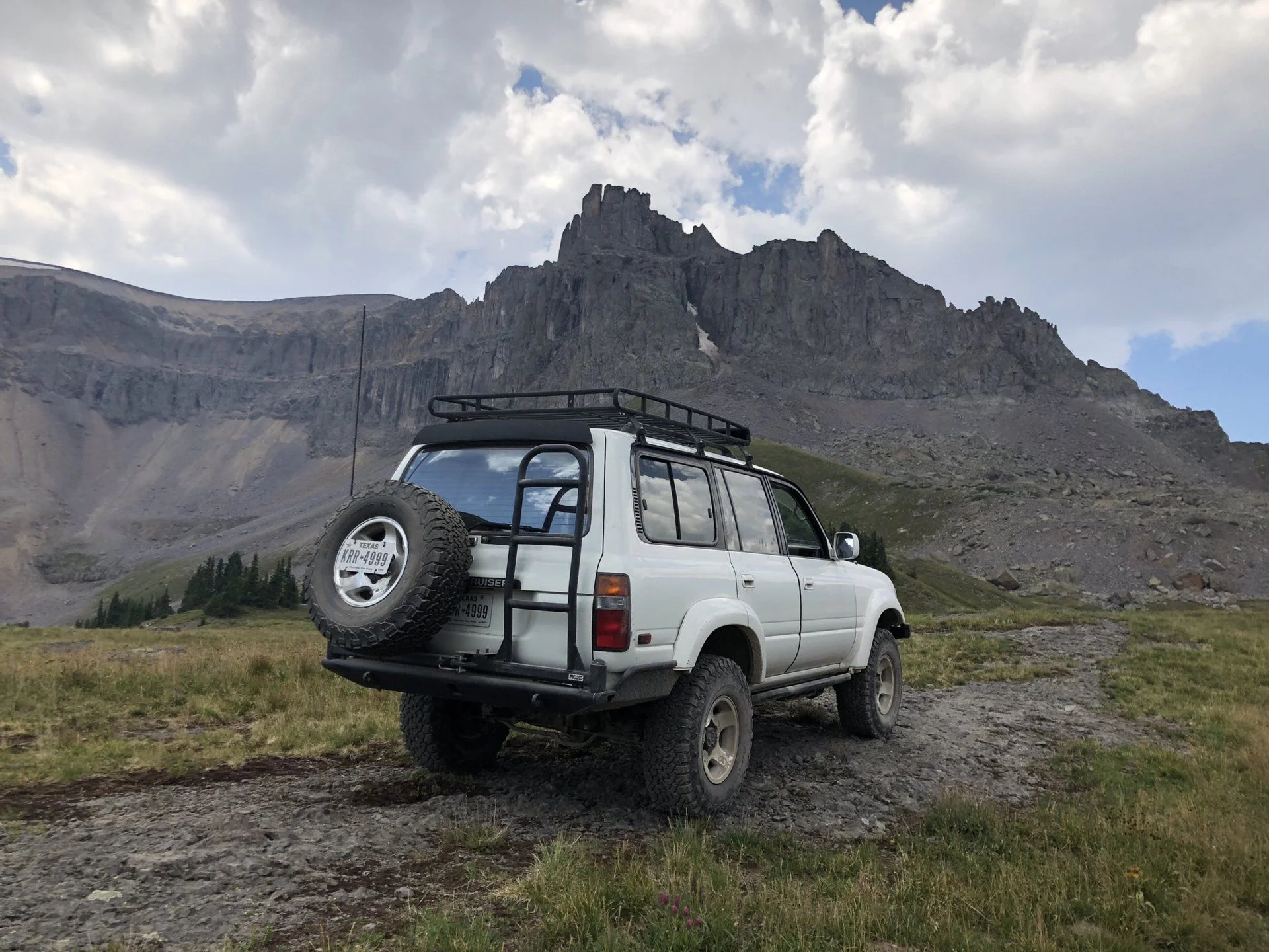

Totally highjacking this thread... but your build is awesome. That picture you posted was somewhere on the internet a few years back and I had saved it. That’s when I realized, I wanted to build an 80 too. Your cruiser was one of my inspirations. I still have a way to go...
Nice! Looks like you're well on your way. Looks great.
