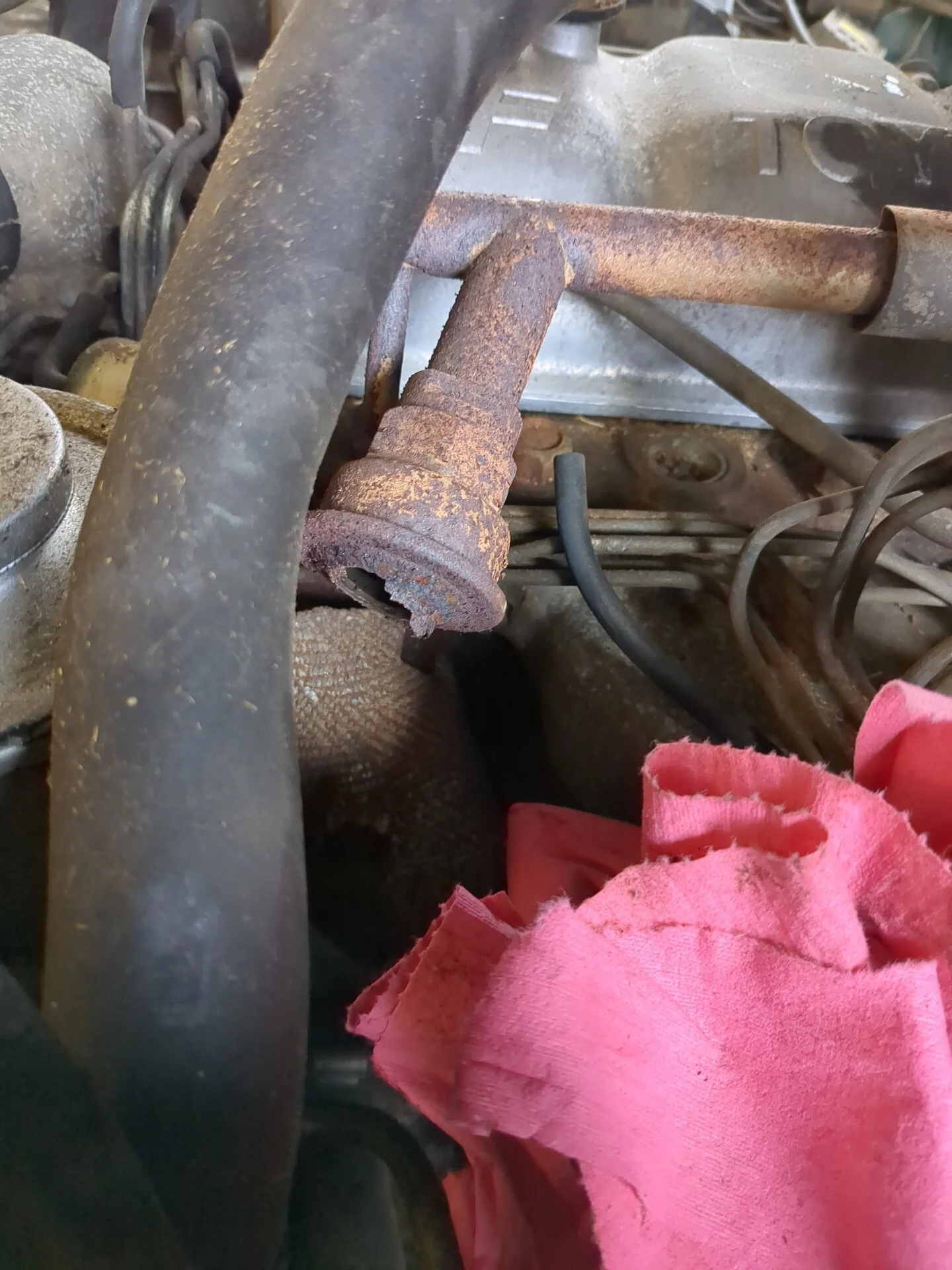

Can anyone help me name this part?
Dec 6, 2016
8
23
Colorado
I am trying to do a sniper install using the Mosley motors kit and noticed this part is broken. I am at a loss for what it's called and all the Mosley photos don't show it as being there. Can someone identify it? Also, is it supposed to be deleted as part of the install?
Thanks
Thanks
Air rail. It’s smog part. Companies on mud sell plugs for it once removed
Toss it if you don’t need to smog! Simpler and cleaner engine bay to boot!
Start squirting those 'Unions', the bits that are threaded into the head and the Air Rail attachments NOW with a good rust penetrant, like Kroil, Blaster, Liquid Wrench, etc. Spray a few times a day for at least a few days. When you wet the unions, tap lightly with a hammer to set up vibrations and capillary action to bust the rust on those unions. Last thing you want is one of those to bust off in the head.
Also, if you can manage to remove the Air Rail without damage, you can sell it. Hard to find intact, these days.
The plugs that OSS shows above, thread into the holes left when you remove the Nipple (Union). You can sell the undamaged air rail to pay for the plugs as they're about $8 each, now.
Good luck.
before I knew about the Toyota plugs, I used 3/8" or 5/16", can't remember which size right now, brass plugs from my local Ace hardware used red locktite on them and screwed them in. never had an issue with one not holding.
get the ones with an allen not the screwdriver slot.
X2 on selling the air rail as the check valve can be replaced, it is the same one that is on the tube coming up from the exhaust.
use 2 wrenches on the unions as the little tubes will twist and break off

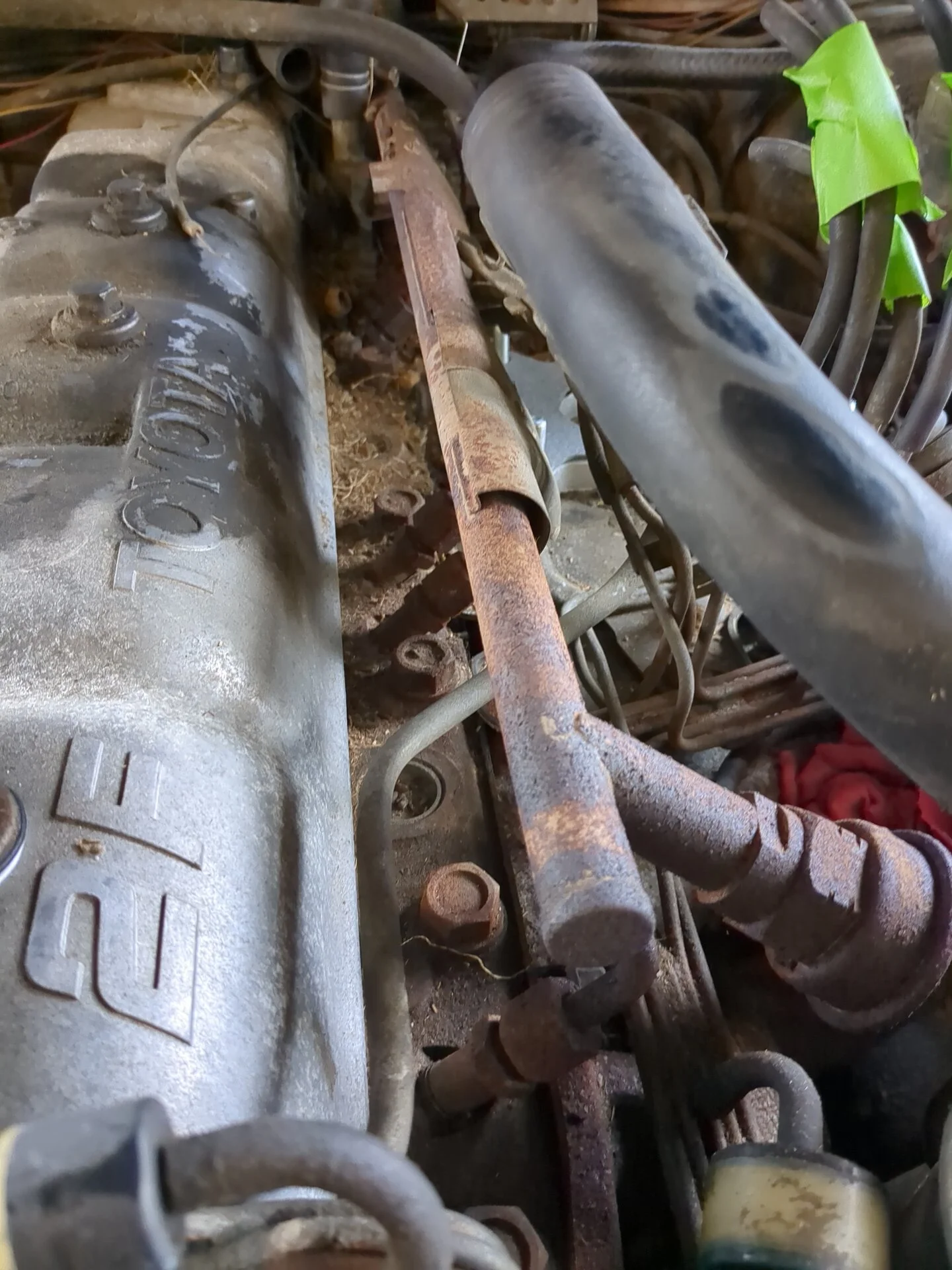

Ok, so I notice an air hose running over the air rail at the broken valve end. BTW air rail is slang for what OSS already mentioned is actually the "air injection manifold". SO.....
you should really educate yourself on removing and plugging the hoses going to your air cleaner and removing the smog pump and the ABV/ASV or air valving on the drivers side inner fender. Really a partial or complete desmog is in order and there is a wealth of info here on this forum as to how to desmog. It can be an overwhelming amount of info. To partially desmog you can keep the EGR valve and the associated vacuum lines and valving that operate it along with keeping the EGR exhaust piping and piping going to the intake from the EGR/PCV. If you decide to remove the EGR and it's valving you will also need to plug the exhaust/intake and re-adjust the carb and the dissy.
Y'all have provided some amazing info, I am definitely in over my head but trying to get my ducks in a row as I wait for the plugs to arrive. I am doing the sniper EFI from Mosley so I know some desmog is going to happen. The amount of info on here is amazing but often conflicting on what to keep/remove.
