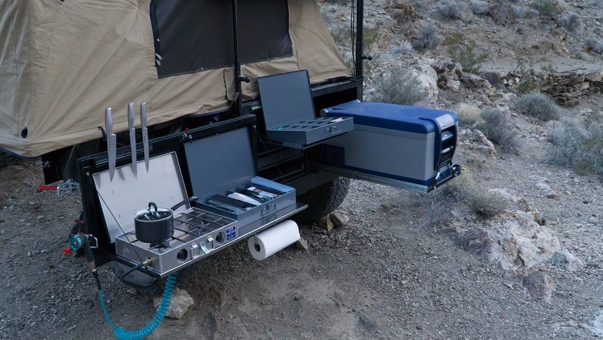

I like the batwing and tent on this one, and the kitchen setup. I would want the sides of the trailer taller and no top access to inner storage. I would also want to be able to raise and lower the sides of the tent platform.

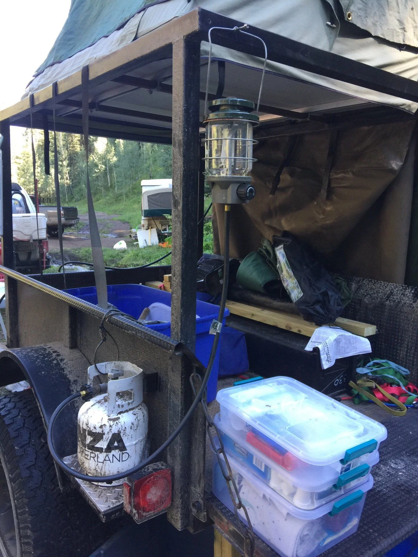

This is the one that @UZJ40 built. Lot of great ideas there.
Off Road Trailer Build

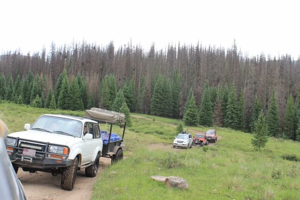

I've built 2 and sold both of them. See "offroad trailer build" below. Things I learned. RTT are great but setting them up in the dark and in the rain in Colorado is a PITA. The cover is hard to unzip in the rain and in the dark, especially if mounted up high so you can use the annex room that attaches to it. Annex room, a super, major PITA to attach in the rain and in the dark. Then after 3-4 days of rain, you have to pack it all up and get the hell out of there! lol
I had a instant hot water shower attached to mine. It was a ecco temp or something like that. It worked great here in Oklahoma in the heat, once we got to camp in the mountains, it barely heated the water from the tank. I wouldn't suggest that one for sure. I'd go with the turtle trailer idea with an actual 6 gallon hot water heater, like I did on my first trailer built "hot water box build". see link below
I pulled mine through and over Stoney Pass, Colorado (60 miles or more), it did great! Although I about tipped it over on a very crossed up section.
Suspension wise, both were simple leaf springs, nothing fancy, seemed to work just fine on and off road.
I pulled mine from OKC area to Ridgeway, Co area. Driving an 80 with 315's fully loaded with 4 peoples stuff is hard enough, then add a trailer with a RTT and some good ole Oklahoma head wind and you have yourself a trip from hell! I had it floored most of the way there and back.
My experience isn't like everyone else but I decided to sell it when we got home, 4 people in a RTT/annex room in the rain and cold in the mountains just plain ole sucks.
My cousin who lives in Colorado has a popup that he drags literally everywhere with his 80. Stock suspension, stock size tires. I literally had popup envy as he pulled up, unhitched, raised the roof and pulled the beds out. Then he flipped on the heater.....meanwhile I'm soaked and cold with nowhere warm or dry to go....any whooo that's my 2 cents!!
