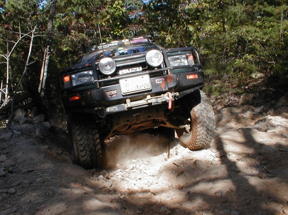

FYI, the tie down tabs appeared to be similar in strength to the tabs on the older ARB. I've seen those tabs used as attachment points many times. See shackles in pic below ( not greatest, but I don't have many picsf my old troop).
