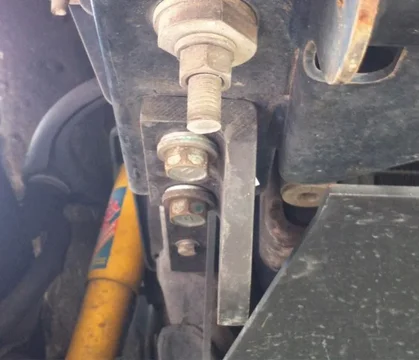

The issue isn't the bumper as much as it is the bracket. The older version I have requires a mUCH longer bolt to install. That is where Spresso is concerned because the ARB bumper affixes to the same recovery point holes, requiring the bolts to be even longer.
How is that any different than any ARB bumper? My 03+ bull bar bumper use the same mounting spot at Dan's brackets and I have zero issues. Granted I have the V2.0 of the brackets, maybe that is where the concern lies...with V1.0 only?
You are correct. The difference lies in the bracket itself. I forgot to post the photo. You will see that this bracket is MUCH thicker than the more recent versions.

I designed the original recovery bracket ("FRBv1") a bunch of years ago and had a batch or two machined from T6-6061 aluminum with black mil-spec hard anodization. These are the units with the dog leg. Then calamaridog asked permission to, because of demand, have them fabbed from steel. And then someone else did the same from my original design a few years ago (agaisin?).
I discovered thereafter the original design wouldn't work with some ARB bumpers do to clearance issues with their mounting "well" and/or the goofy (sorry Sahara and Ironman owners...but it is a damn goofy design) 30mm U shaped spacer they use between their lower bumper mount and the frame.
That's when I went back to the drawing board and designed the FRBv2/FRBv2L (only difference between these is the supplied bolt length). Apart of the prototype process I had a production sample destructive tested. The FRBv2/FRBv2L fit any of the bumpers I've found including ARB Sahara and Ironman bumpers.
