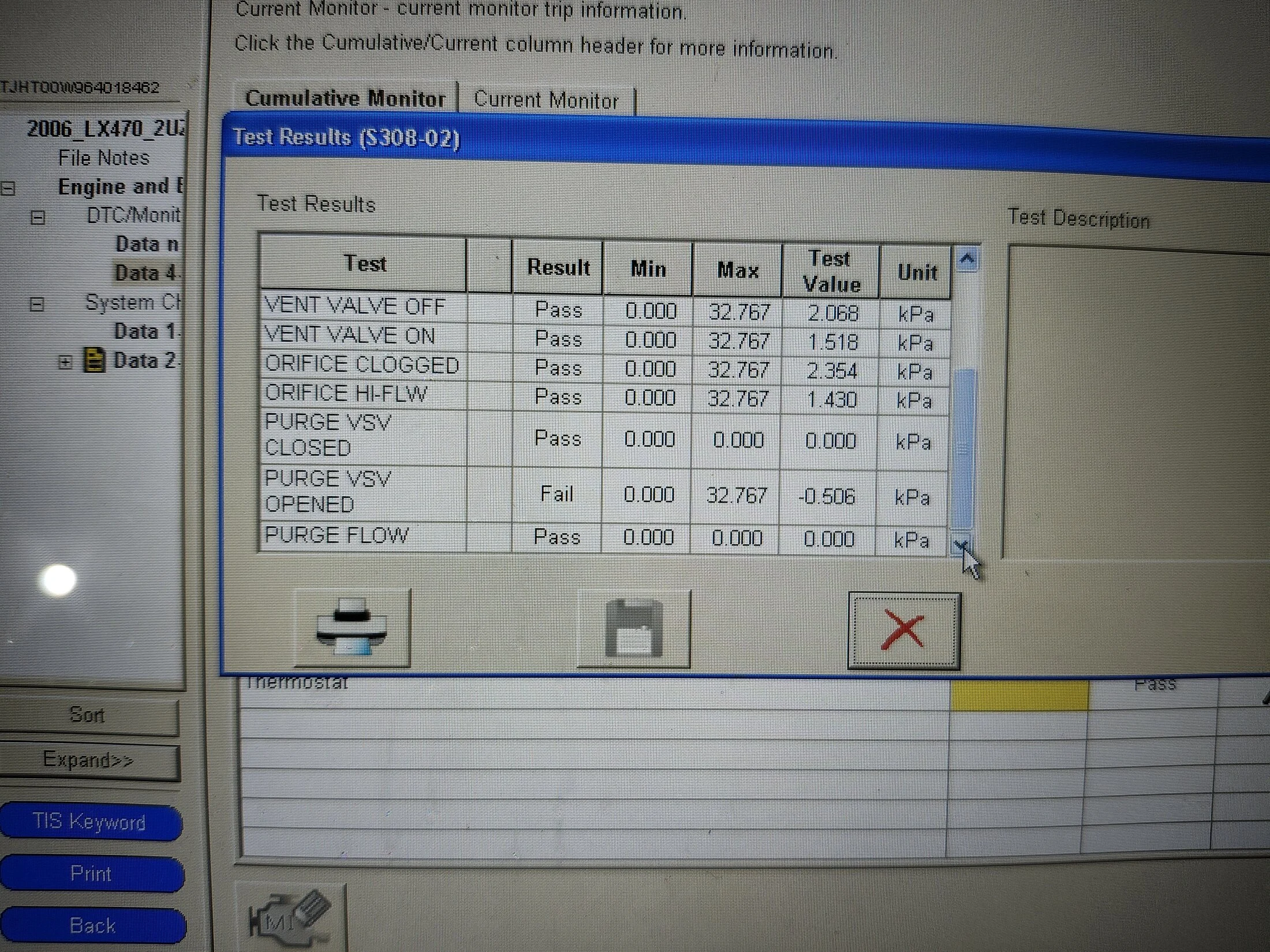

Finally, i ran the EVAP montitor test through techstream. Here are my results.

So I'm a bit stumped here. I have been over the FSM a dozen times and I still am having a hard time wrapping my head around the EVAP monitor results.
First - If the purge VSV is ON (open), why is the system expecting a positive number and not a negative one? Opening the valve exposes the system to vacum, thus prodcuing a negative number, which mine is doing. But the reference values for that field are positive?

Gas cap is designed to release excessive pressure. Which may be where HP air you added was escaping. It may also have a leak air from fill neck area of fuel tank.
