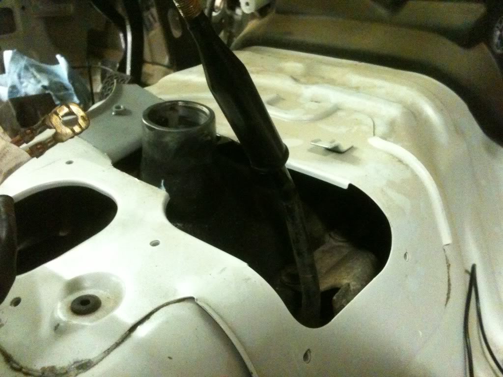

As promised here is the H55F sitting behind a 1HZ in a 79 cab. enjoy :hillbilly:
what about heater location?
is there going to be an issue with the shifter location?
Yeah I think if I knew this back before I did all the work undercoating the truck and all, I might have just chopped away and built the custom cross member. You can just see the heater there infront of the shifter location, I didn't really try eyeing up the room for shifting, but I think you could probably make it work no problem, even if you had to bend the shifter a little.
A little hacking, A little chopping.

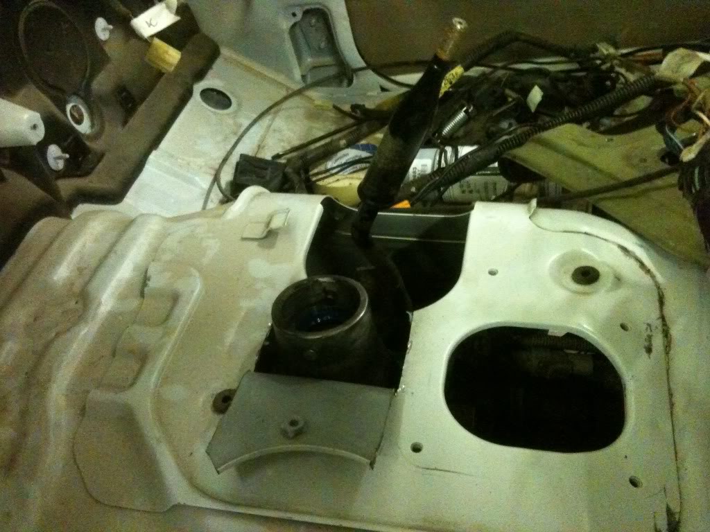

Here's my 79 cab on a 75 chassis with the H55F. With factory body mount bushings. The transfer shifter is in 4H and hits the body in 2H, so this will have to move forward as well.
I plan on giving the truck a 1.5" body lift and using the 75's bolt on transmission cover spliced into the 79 to mount the rubber boots to.
The 75 series shifter has a lot more bend in the stick than the 79 series r box so I'd guess it'll miss the heater gear.
