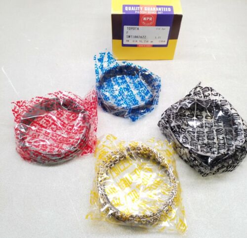

13011-60011 is STD early F piston rings. I *think* your pic above says 60011 on the piston ? Later F rings (72-75) are different part #
That link is 1.25 over not standard rings.
Yes, that seller has listed STD Japan-made F piston rings in the past. The listing has the correct part number, but photo is not right (or part # is wrong). In any case OP may want to send an email and ask. It was just a jumping off point for the OP should they want to hunt some down.
