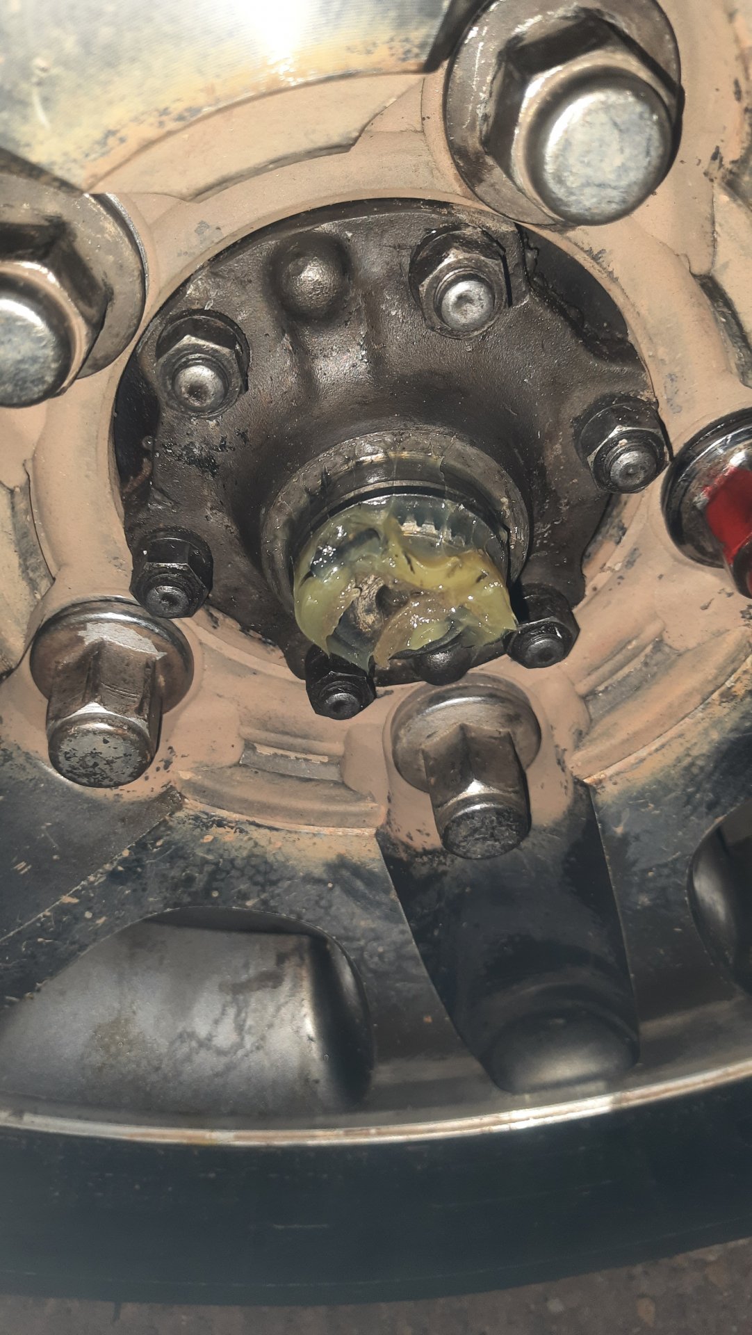

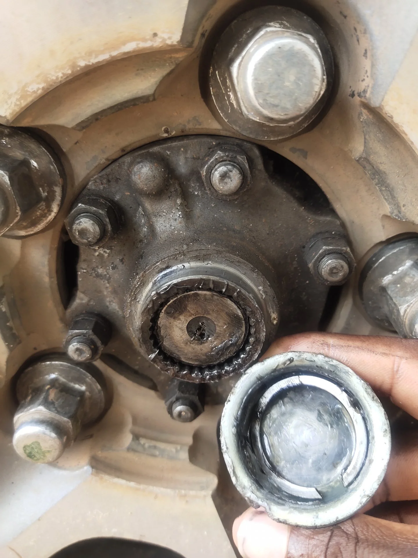

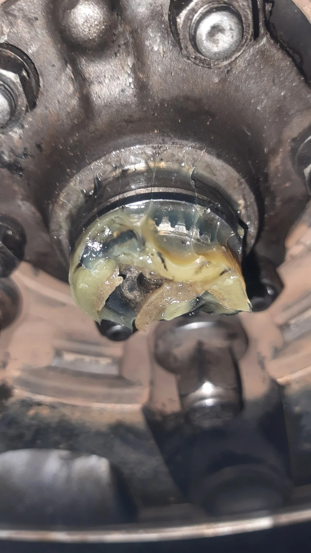

So, if you've been following my past few threads, then you'll know I just finished replacing front driver side CV axle with a used one. Well I didn't buy a new c-clip and apparently the C-clip is a non-reusable part according to Toyota. I was able to pull that axle with my bare hands out far enough to get the C-clip well seated (i think) on the groove. Well after driving about 50 miles and basically taking the car on its maiden voyage 2 days ago, I was coming home, going around 70mph, and I hear a pop and clink like a bottle cap hit the skid plate and I knew right then and there that the c-clip popped off and was sitting in the dust cap. Kept driving the car like normal (no CDL activated). Next morning, open dust cap, c-clip is sitting inside and the CV axle end is now flush with the surface of hub flange.

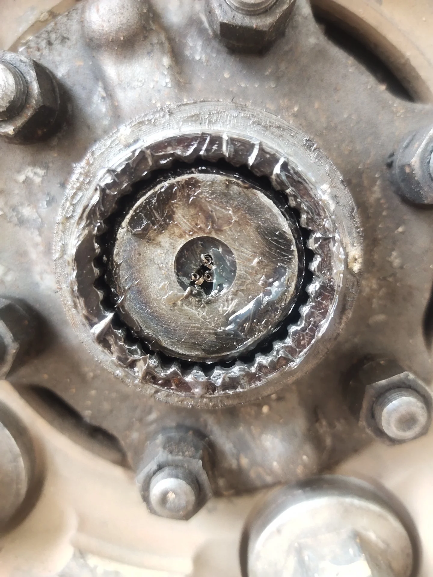

In this last pic you can see metal shavings inside the hole where that bolt people were talking about is meant to thread into, does this mean something has already worn away?
Update: there seems to be no new c-clips in the market and the only place to hopefully get them would be the toyota dealerships for obscene amounts. I went ahead and squeezed the c-clip together using a pair of pliers and a 14 inch pipe wrench. C-clip has come together quite nicely, might re-use it and see what happens.
Yes that hole filled with gak and swarf is the 8mm hole you can screw a bolt into, I've seen people use a steering wheel puller sort of thing to pull the bolt out to get that clip on. Otherwise what I've done is just get some vice grips on the bolt and pull it (better yet get someone else to pull it) while you have fun putting the circlip on, it should be tight and seat well into the groove around the cv no more no less. New one from Toyota are around $1~ and come in various thickness, you can get a bunch and just use the one that fits nicest or measure it up. Also when installing the cap put a blob of grease inside it

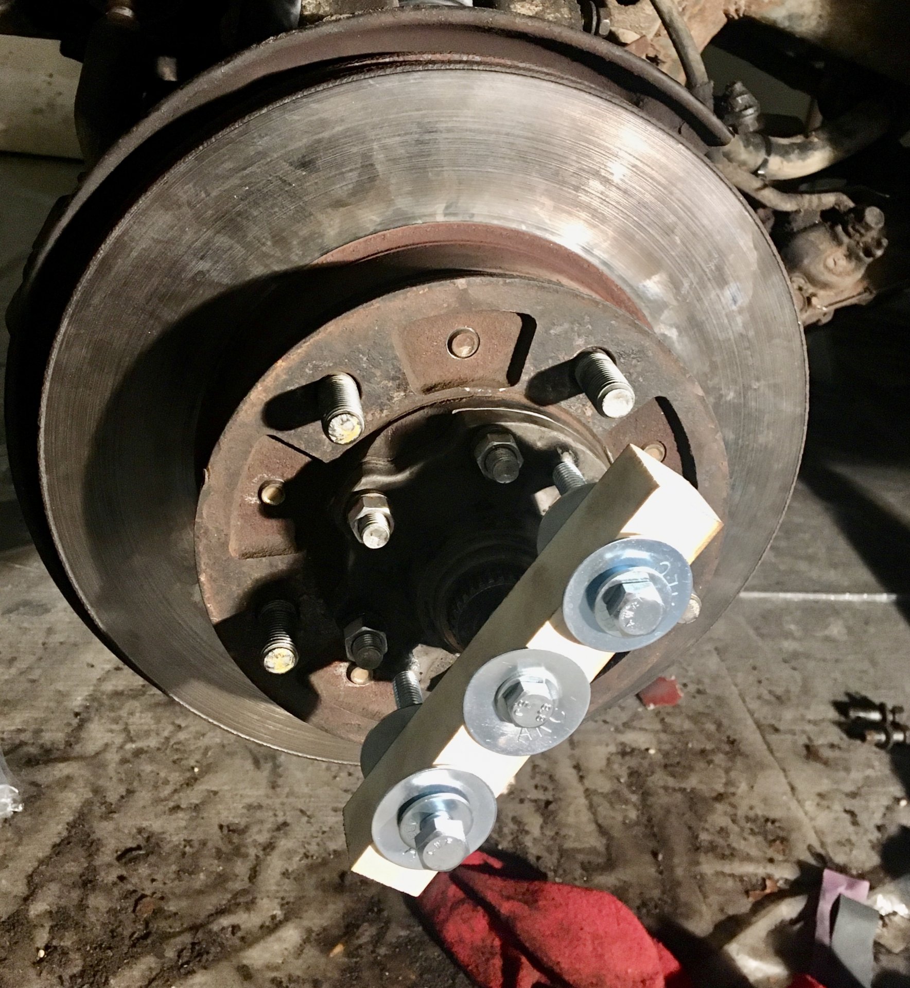

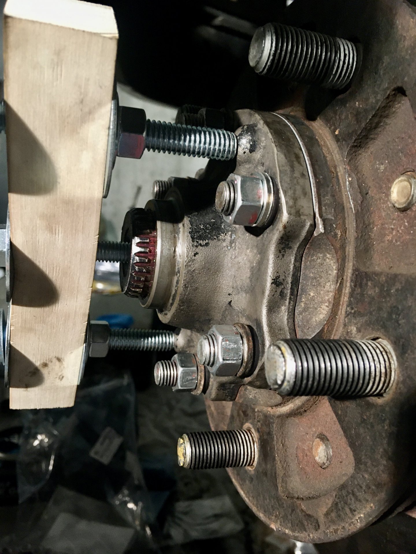

If you installed that c clip by pulling the axle out “with your bare hands,” then you did not pull the axle out far enough. Need to make yourself an axle puller — cost me about $5 at Home Depot for some 1x1 wood, three bolts, three nuts, and a few fender washers. Will attach some pics from when I did mine.

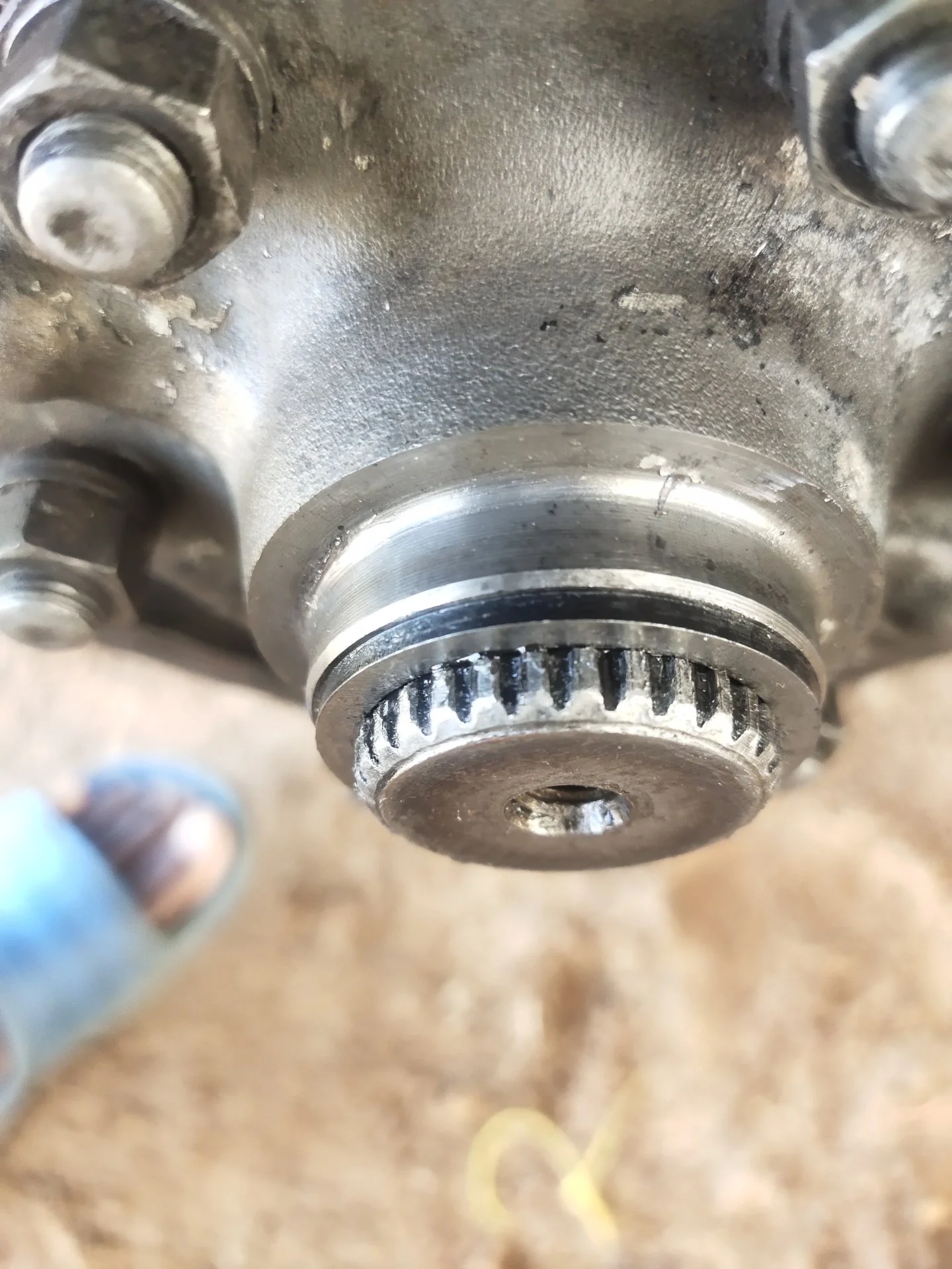

Just so I can stop being paranoid, the axle is sitting properly in the pictures below right? It's not meant to be sticking out more than this? (the yellow thing is grease from the dust cap and yes the compressed c-clip is sitting in it's groove in the pics)
You need to pull the axle out more so the c clip sits in the groove.
Okay, i'll go at it again.
Agreed. It definitely doesn't look like it's down in the groove. You need to pull the axel out with a puller, or just put a bolt in the end of the axel and find some other improvised way of prying it. It has to be ALL THE WAY out before snapping that ring in place.
One other possibility is that the snap ring is too thick. If all of your pulling on the axle doesn't get you there, you may have to step down to one of the thinner snap rings. If you need to do that, don't skimp. Just buy them all to have on hand, or you might regret it.
It looks okay to me. Snap ring appears to be seated properly.
When I did this job, my snap ring settled down to about flush with the narrow end of the chamfer on the hub flange. I think it's a little bit difficult to tell from the perspective of their photo, but if you look at the sides rather than top of the snap ring, it appears to be flush with the wider portion of the chamfer. Just my observations.

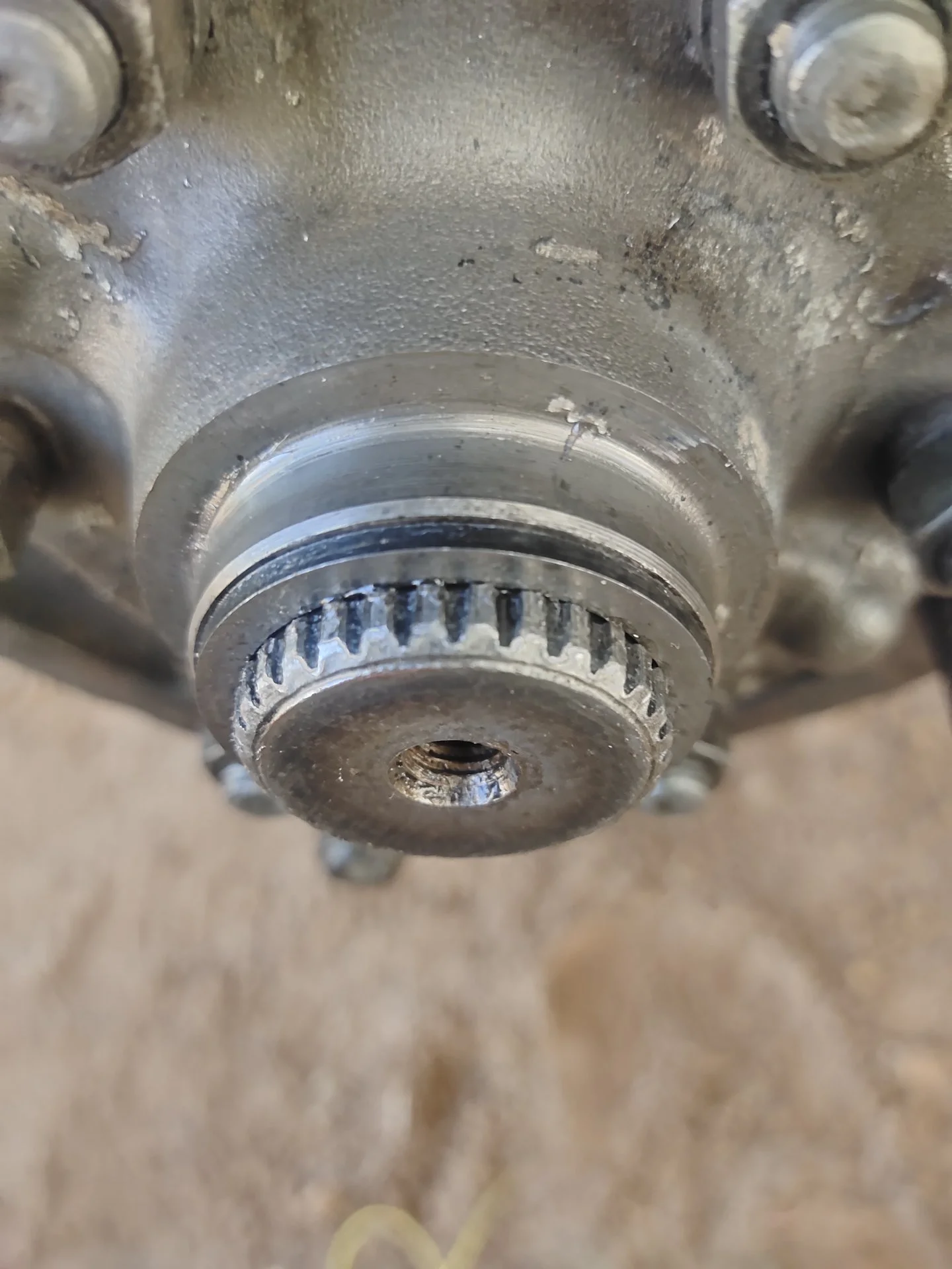

Okay. I put on the used clip I bought. Drove 200+ kilometers (124+ miles) to the airport and back home, pulling speeds upward of 140 kph (87 mph) and entering lots of speed-bumps and potholes at moderate speed, and the clip surprisingly held on perfectly.
Here's what the clip looked like when I put it on this morning (before the drive to airport), I screwed in a 12mm (head of bolt is 12mm) bolt into the end of the axle which I took from the skid plate as @medtro suggested (thank you), and got someone to (carefully) grab the threaded part of the bolt with a set of pliers, and, while also pulling the midsection of the axle with one hand, (carefully) pull that bolt outward for their life. I was able to slip the c-clip on with two flat-head screwdrivers.
Here's to hoping that it sticks on! :cheers: :cheers:
They sell 5 sizes of c clips. Buy a pair of each size and have them handy. It doesn't appear fully and freely seated to me, but my vision sucks.
