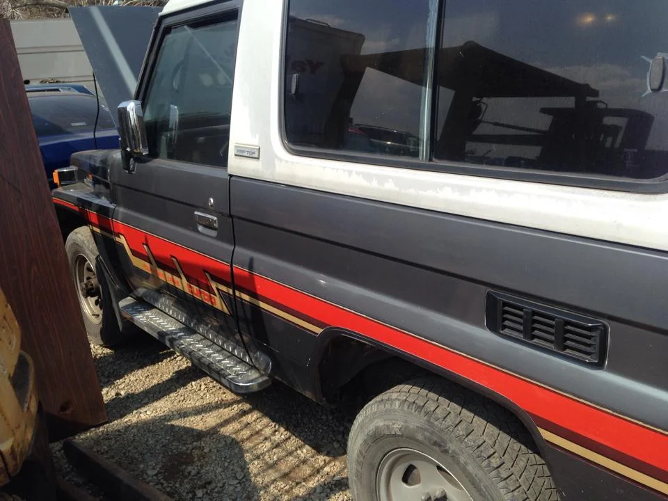

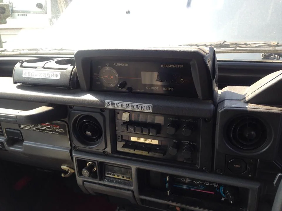

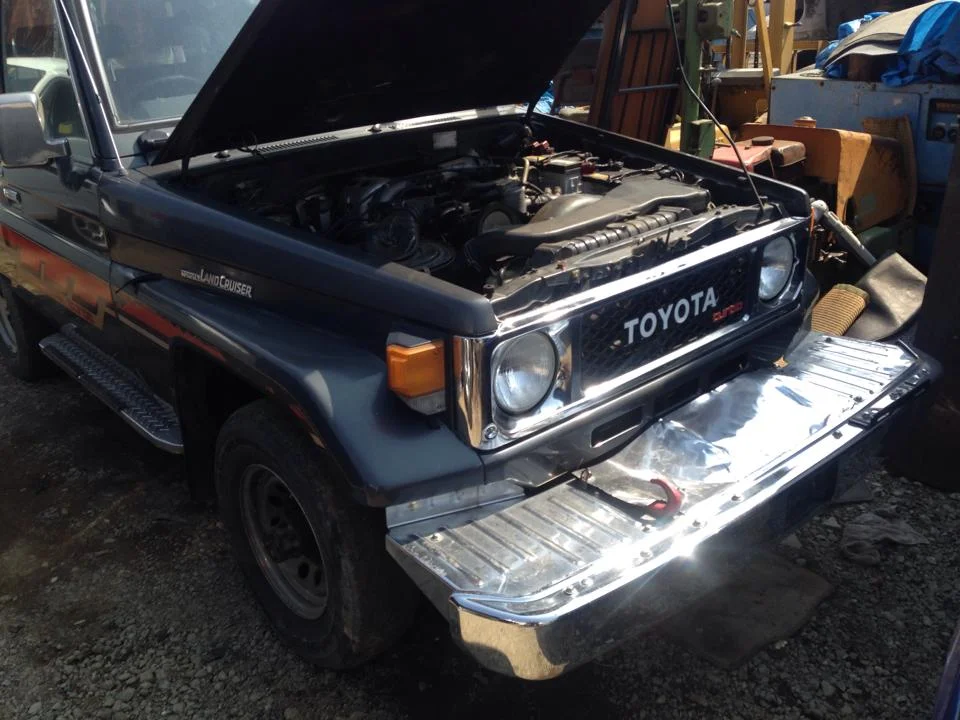

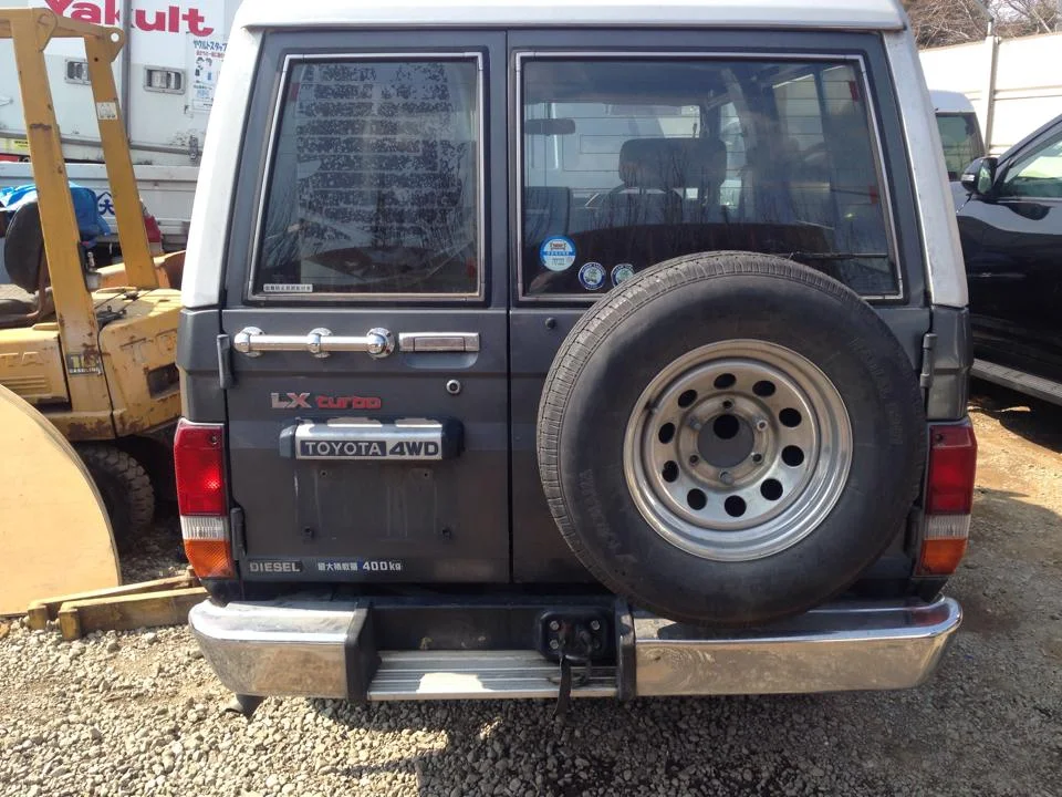

Here are some pics, interior looks a little dirty but complete. Also, looks like it is 430,000km, so 260k miles or so.
Any thoughts?

There are a lot of BJ-74s with that much mileage still running strong without major problems. Run it parked with the oil filler cap sitting on the opening, but not screwed in. It shouldn't blow off. Then have a compression test done and that will tell you what to expect in the near future. While the injectors are out for the test, have them serviced, unless you have proof it was done recently. Run a tankfull to near empty with B20 biodiesel fuel to clean the fuel system before you change the fuel filter. Find the water trap / sedimenter on the right side of the engine compartment and drain it. Then drain and flush the fuel tank as well as replacing all lubricants. Drain and flush the rad then add new diesel coolant.
Also looks like it has A/C?
The pump visible in "engine bay.jpeg" is the power steering pump. The reservoir on BJ74 is remote to the pump (due to lack of a reservoir, the pump can be mistaken as an A/C compressor). The A/C compressor is mounted low on the 13B-T and would not be visible in the picture. If you spotted refrigerant lines, I missed them.
Thanks for the info! I thought that was likely to be the PS pump, I was referring to the fact that the HVAC controls state "A/C" on them. Though, I guess it is very possible that Toyota used the same control panel regardless.
looks pretty tidy for its age and mileage mate, I've had a FJ75 for 12 years and still love it. Mechanical stuff on those things are pretty easy to fix a lot of the cruiser stuff from other models is all common and fits its the body that's a bit harder to fix if you need to source replacement panels, common places that suffer rust is the windshield frame, below the windshield frame, A pillars rot out and the front floor pan, roof gutters rust out but not on fibreglass top models they don't :)
Looks like it is the 85-86 model with no roll cage and no rear seat belts
The A/C compressor is below the air box and slightly aft and the coolant lines are most likely routed lower in the engine bay. The heater / AC control head looks identical to my 1987.
