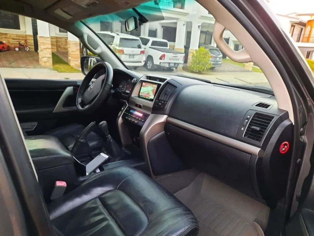

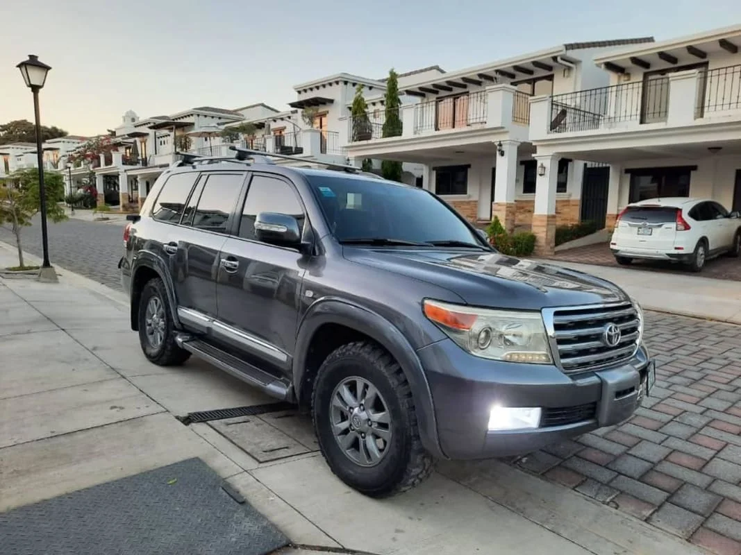

Hello everyone, it turned out that the compression test came back good. I think I'm going to buy it and have a question about the oil grade you guys would use on this car. The most common oil here is 15W40 and Toyota brand and is very hard to get high-performance oils or other grades unless you really look. The car has 179,002kms now. Here's a picture of it:
Looks great. I’d have zero hesitation using whatever it says in the manual.
