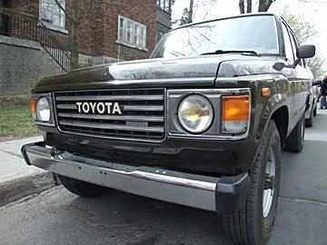

I only have crappy pictures... don't show much. I'll post some new ones next week during test drive even if I don't buy it.
I know the price is too high, but I really can't wait to get one + they're pretty rare around here + I'm no mechanic and I won't buy a 2K rig for a project...
But I know I should wait.

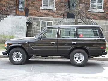

Not original paint.
Thanks guys.
Know what a dipstick , firewall, undercarriage is ?
Oil will aways be black in a diesel , Firewall where the wiper motor and pivots access points are should be rust free for 14G ,.. It better be.
undercarriage, means a get dirty , and under , Bright flashlight and look. Quebec ,Salt,Rust and all goes in order.Show us different with pictures ..
Show me how a repaint / patch and hide is 14G..
Pictures from under, Many here will set us straight.

BTW - interior pics would be helpful, and also some pics of the underside...these will help us evaluate the condition of the truck.

If you go check it out ask what happened to the front seat headrests. Look at the ad in Kijiji and you'll see missing headrests....

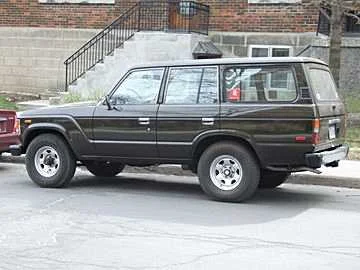

looks a little like the rear leafs might have some sag
