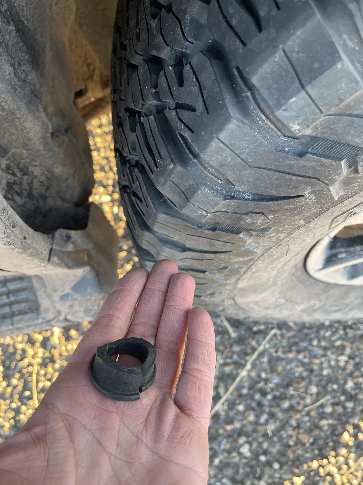

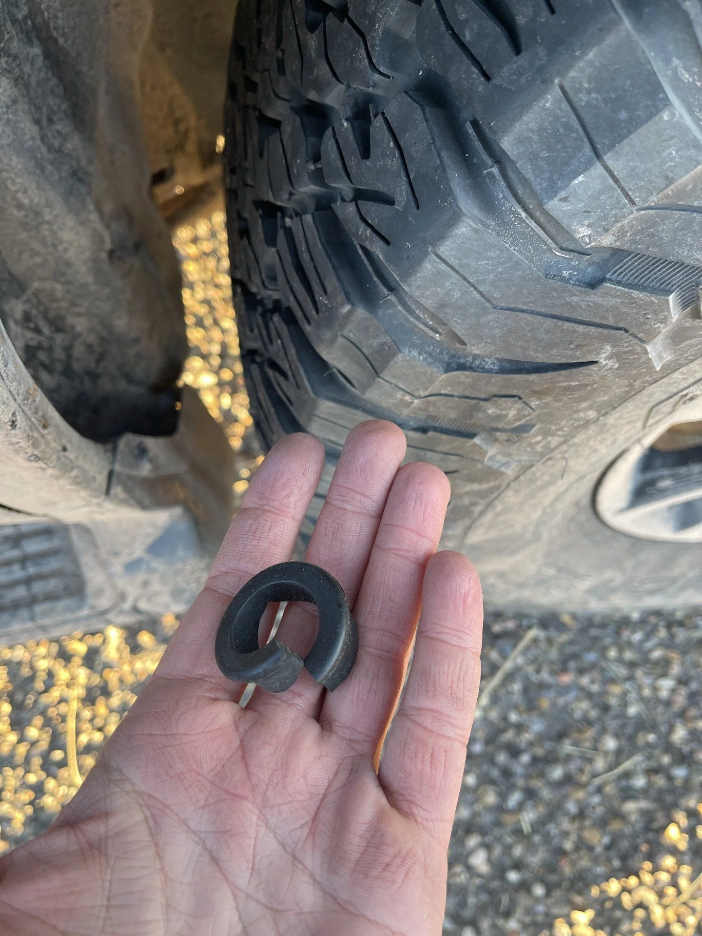

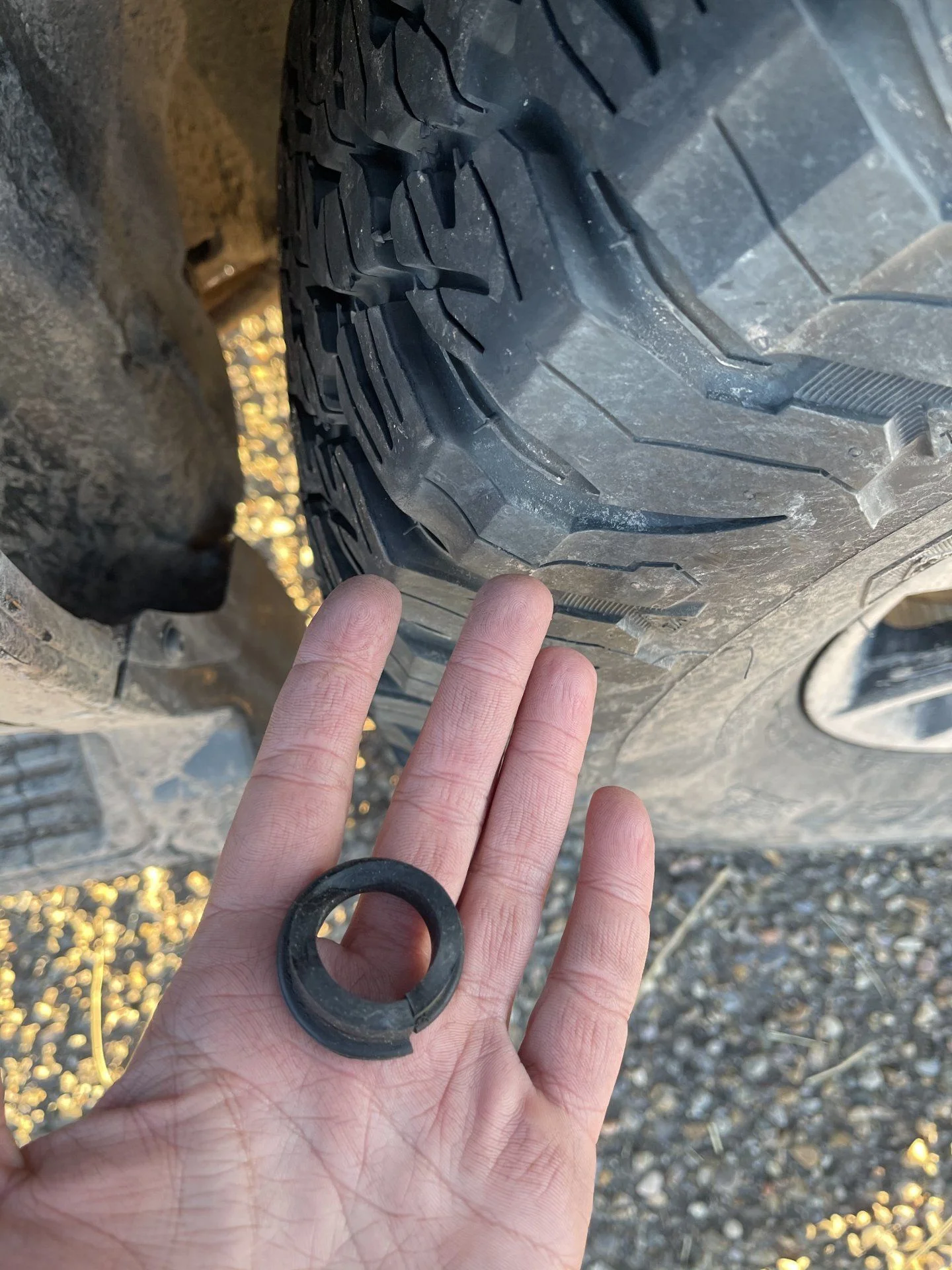

Well, the plot thickens!
I found this little booger sitting in the void between the side step and the wheel well driver’s rear wheel where the smell was coming from). Not sure how it held on for the ride, or even how long it’s been there...
However, it looks broken rather than melted.
also, very possible a little kid was playing hide&go seek with it. Just saying.
