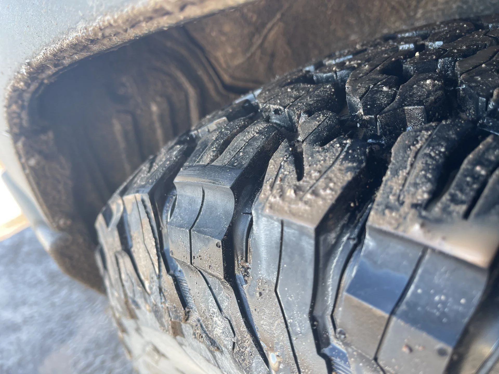

Drove 600 miles yesterday without any noticeable issues. First time driving in ice/snow, averaging 60 mph. Stopped after 30 min this morning to take a scenic picture and smelled burning rubber and noticed my tire edge appeared to have been melting. Driver side rear tire. All others are fine with sharp edges. Any ideas?
Stopped a few times to check on it and it appears to have stopped. Only thing I can think of is that I might have been in comfort mode on ahc and have been rolling in normal and sport ever since (ps. I am riding really heavy).
A burning rubber smell when getting off the freeway is not a new thing with the 200-series. I get it pretty consistently, and others here have posted about it as well. To my knowledge no one has been able to track it down.
Personally I don’t think there is any correlation between that and your rounded edge, just a coincidence. I’m also quite sure your tire itself isn’t melting.
My eyes suck, but zooming in, I don’t see anything in that photo that looks like melting. ?
Any chance your parking brake cable is too tight/creating burn smell?

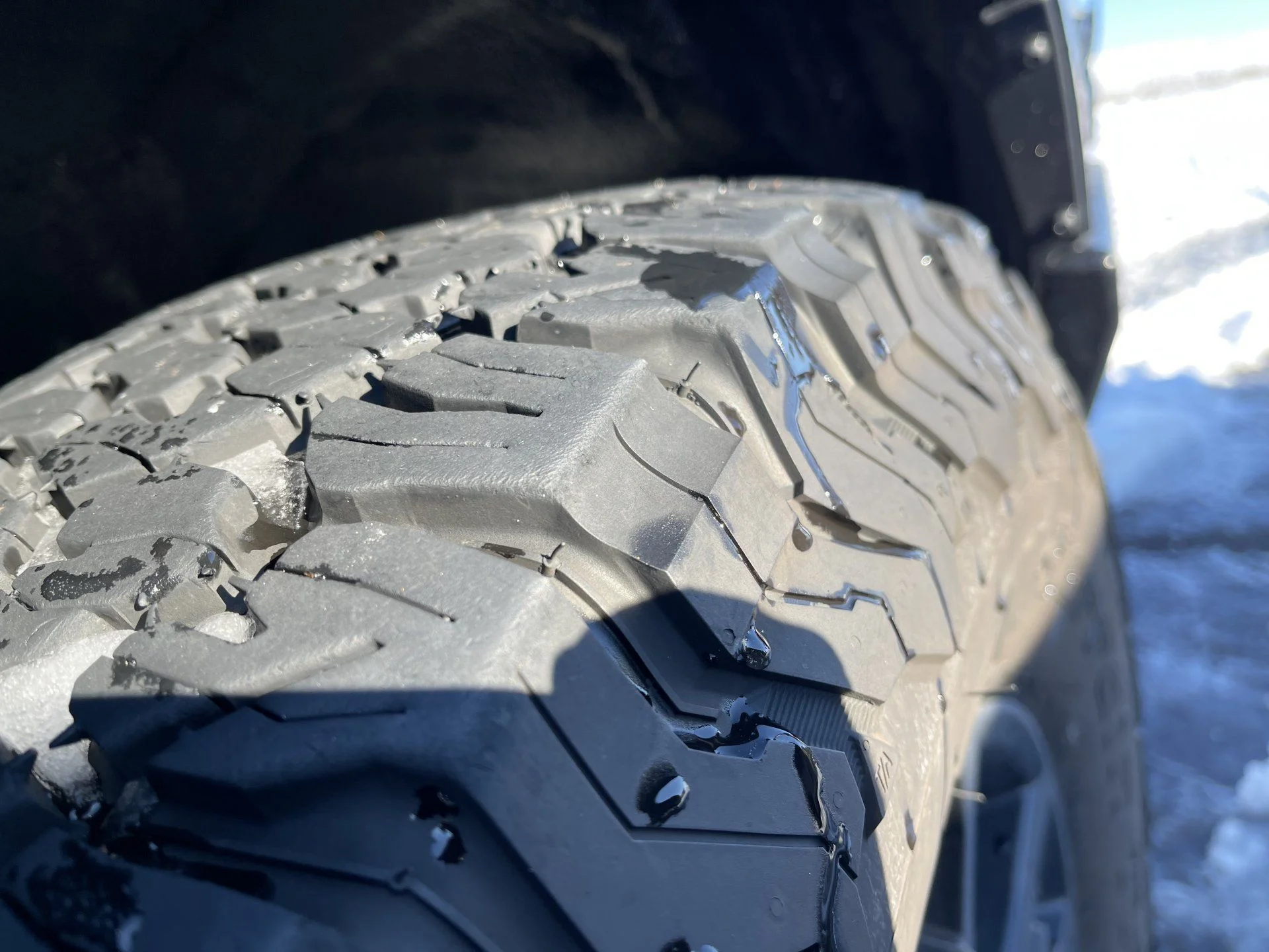

Yea, I hope I’m just being paranoid. Been in and out of cell reception, so my mind keeps going to worst case scenario. Here’s the passenger side rear.
First picture is representative of totally normal tire wear, most likely from the front steer tires. Second picture is normal wear for the rear.

Sorry guys. Through a series of comical coincidences, I thought my tire was melting away 🤷🏻‍♂️
Here’s what happened: I booked a last minute primitive camping spot at Big Bend Texas. I noticed a very infrequent clicking in the rear driver hub as I was getting the rig ready, but decided I wasn’t going to worry about it. We stopped several times on the first leg of the trip, and never smelled anything. The next morning, it was below 30 degrees.
We stopped after 30 miles to take a family picture, and I immediately noticed a burning rubber smell. The first thing I checked was the rotors/wheels, and all were fine. I went around again and figured out that the smell was coming from driver rear, and also noticed the rounded edge on that tire. It may even have been smoking, but that would have been steam from the warm tire/ cold air (all seems like a blur now).
I wasn’t worried about the tire itself since I have a full spare, but rather somehow spiraled down a hole where the click hub was about to have a catastrophic failure and I wouldn’t be able to mount the spare to anything.
I will say, though, that the tire definitely has ripples as if it had been heated up and cooled. Not like an even and smooth wear from a bad alignment.
You have big tires and spacers and say you are running really heavy. Sure you aren't rubbing that tire up into the fender on big bumps? Last pic sure looks like a section of tire rubbing to me. Look up in that fender and see if you see a fresh rub spot?
Those ripples are evident in the 2nd photo and really paint the picture to me. That isn't tire wear from pavement, that is from the tire rubbing on something....the section of that tire has clearly been grated away from rubbing something from what I can see. I have been wrong before, but i have had my share of tire rub with 20+ yrs of both offroading and roadcourse racing. Good news is that it isn't that bad and probably will (or already has) self clearance. If you smelled the unmistakable smell of burning rubber it kinda all comes together in my mind.
I forget what weights you're at but I wouldn't be surprised if you're close to 5k at the rear axles and that sidewall is rolling over a bit and the outer lugs are taking some punishment. Loads on the various tires may not be completely even. So may want to go to 40-45 PSI (cold) when laden to have some more margin.
The ‘rule of thumbI’ I’ve seen for any tire up to rated max is to set cold psi where hot psi is 10% or less more. So 35 to 38/39 in this case. Looks like with heavy load you saw a psi more, but that shouldn’t be enough to delaminate or overheat an lt tire.
I had to run down this info as the tire size I use isn’t common and the manufacturer didn’t respond regarding a psi/weight query.
1st photo has the ripples, 2nd photo is the good side.
My KO2s didn’t rub anywhere, but both steer tires had that ripple pattern, and I drove the truck pretty hard with them.
It is just an indicator of the corner of the tire rolling under on cornering.. aka scrub.
