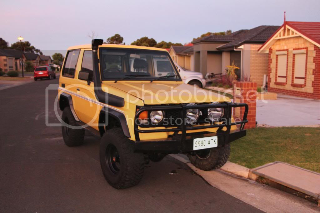

Bundera LJ70 Build

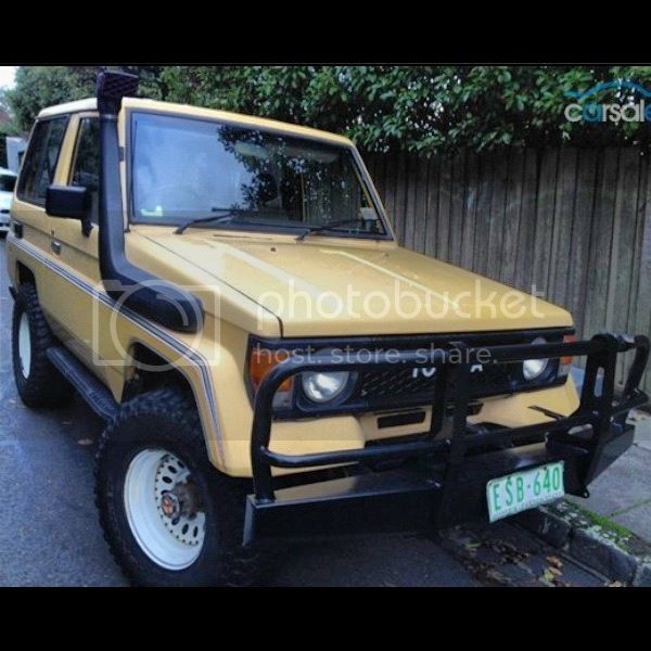

The bundera when I first got it.

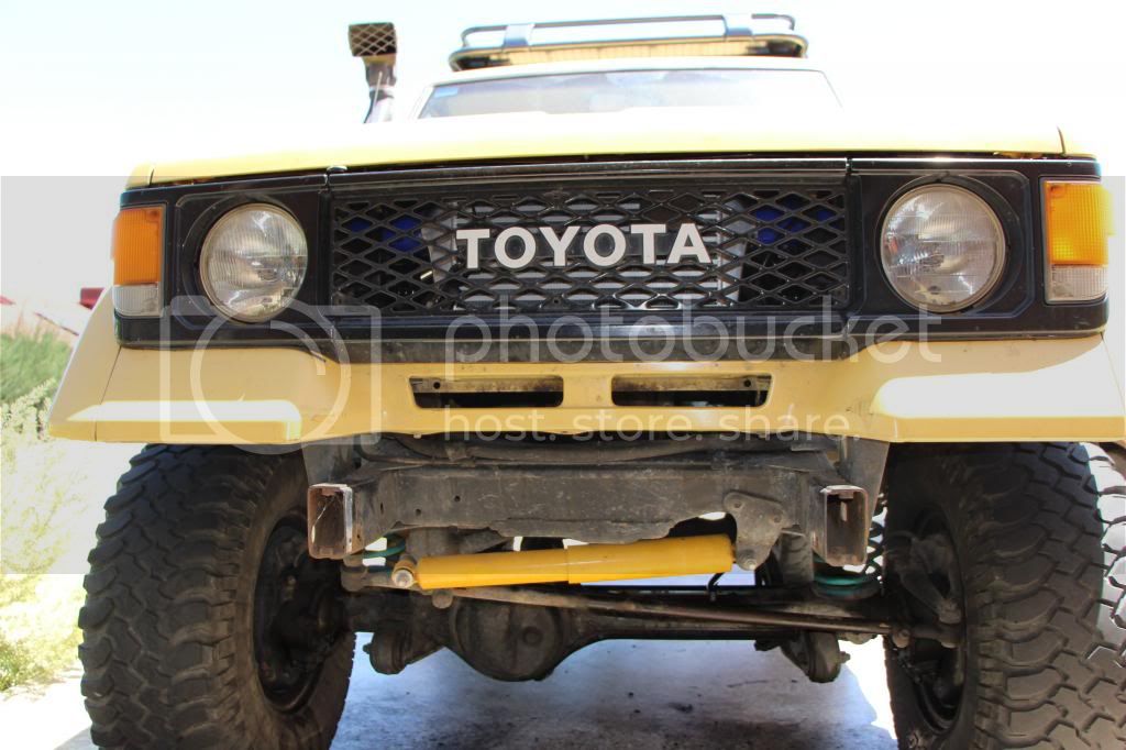

Added spotties ,oil catch can, moving the bullbar a lot closer to the car, flares, 3inch lift , boost gauge and painting the sunnies mat black this is now what it looks like

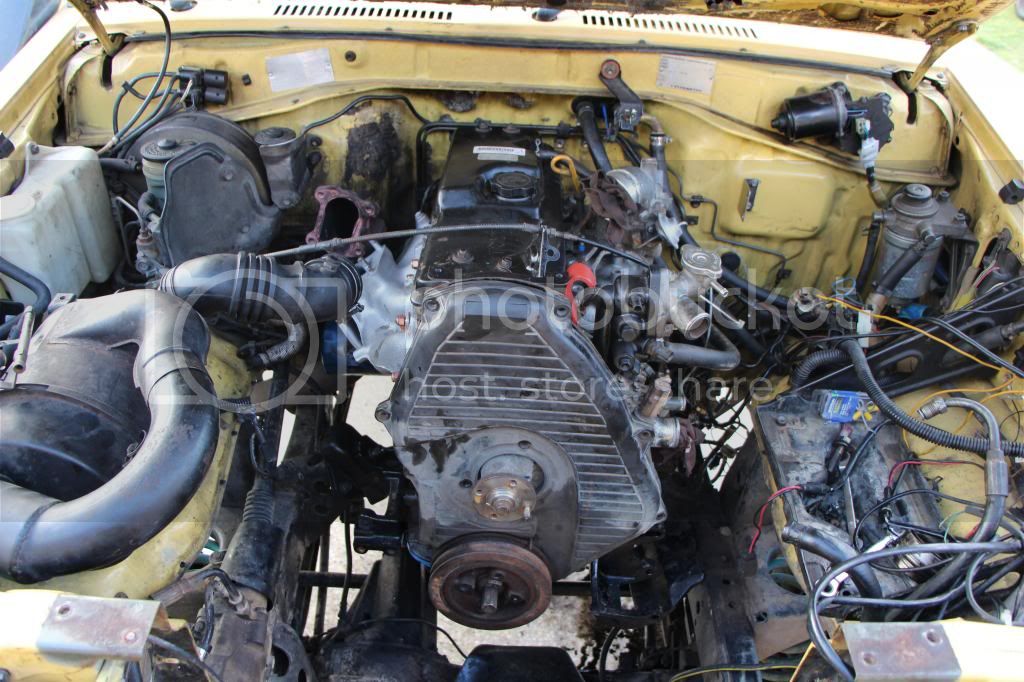

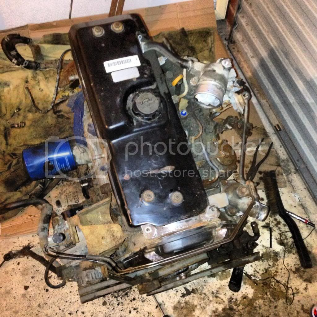

After nothing but trouble with my 2L-T i recently purchased a 5L out of a Hilux used in a Quarry with 110,000km with a daily service book. It was abit rusty on the outside but very clean on the inside.

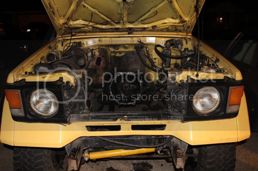

Motors out time for the new one

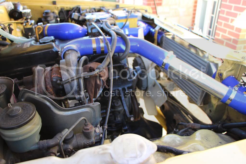

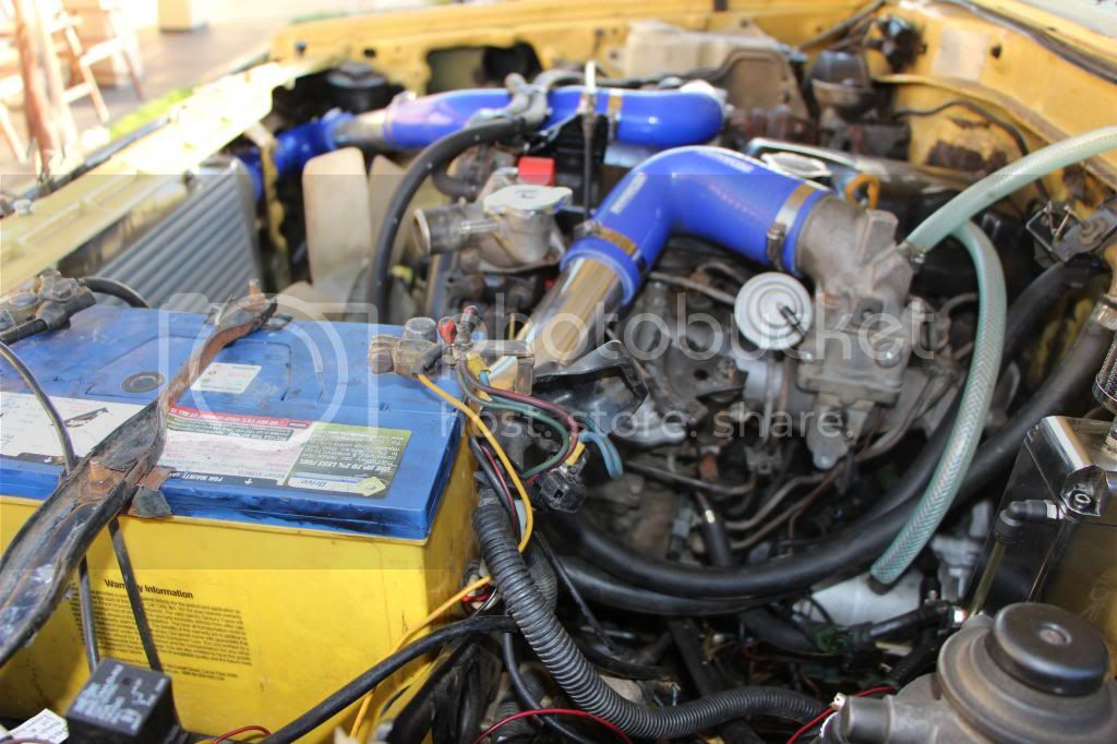

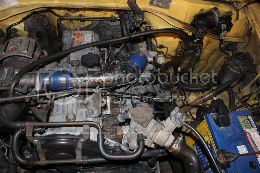

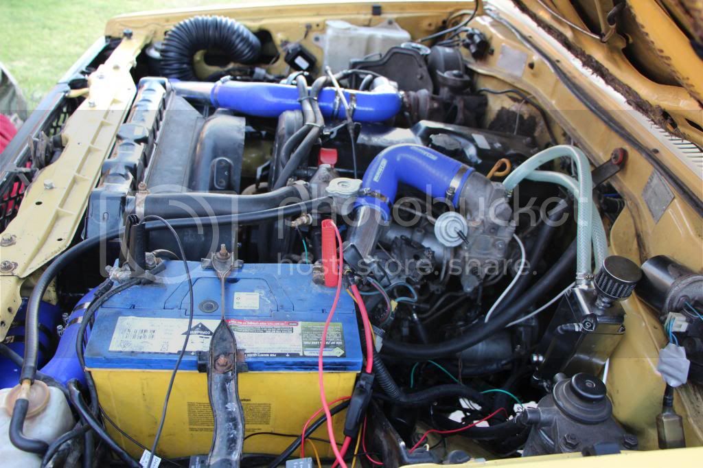

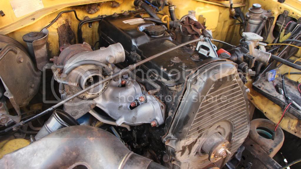

Also added a 2L-T turbo manifold off a Hilux Surf pulling out some studs and putting some new ones in to suit the new manifold. Using the CT20a aswell see how it go’s might have to good abit bigger. Put the 2L-T water housing on the 5L to so I didn’t have to change the radiator. Had to use the 5L starter motor and clutch.
Might aswell added a front mount intercooler while everything’s out.

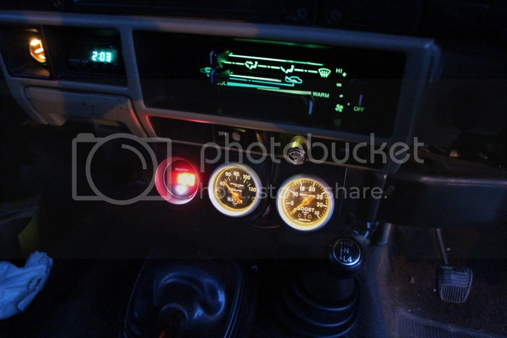

Still have to put the Pwr steering pump on and wire up the EGT gauge, manual glow plug button and new after market temp gauge should get it started it the next week or 2 thanks hope you enjoyed

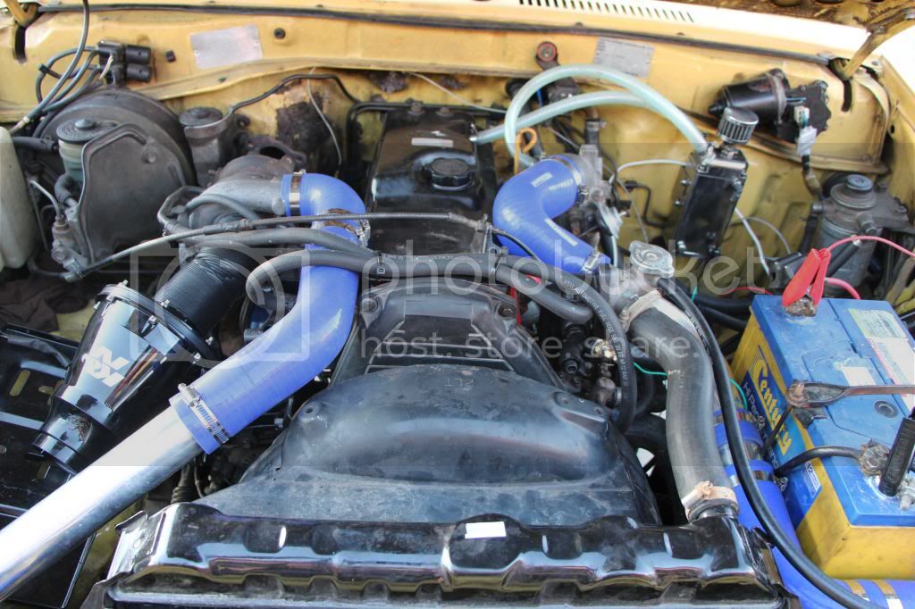

She Started.

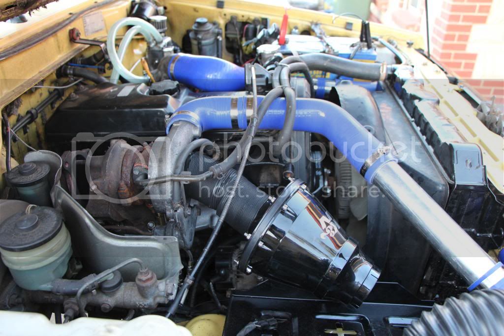

Almost done now need a alternator plug to convert old to new,new dump pipe and a tune from MTQ. ran it for 20mins got and stayed at 79C' and EGT was 240F' also decided to put a second battery in not finished yet and had to get rid of the old air box replace it with a K&N enclosed pod filter which i need to connect to the snorkel.

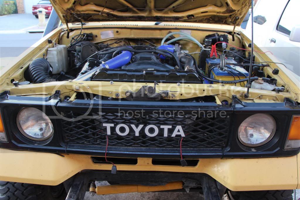

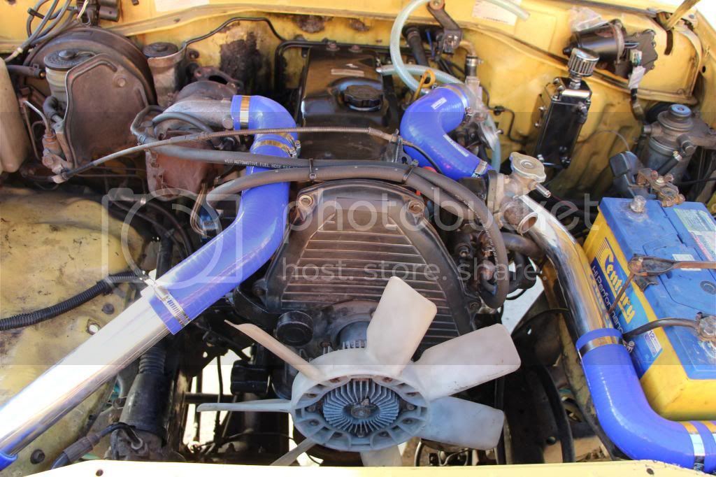

Bit of a update had i couple of problems that slow me down to get this thing on the road
1. blowing the first alternator up. i got a auto electrician to re wire a brand new ebay that is running perfect now.
2. bought a new ebay 5L starter motor cause the other one was sticking open.
3. Car was blowing oil smoke replaced the turbo with a ebay ct20 smoke stopped.
4. Bad earth and chopped and replaced old wiring

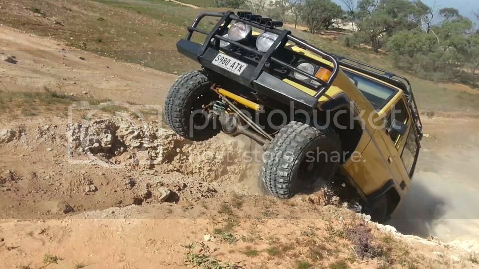

5. Took it 4x4ing have to replace the 5L sump with a 2LTE sump and pickup
Current Problem
1. driving around town at 50kmh-80kmh car sits on 82-90 C as soon i get over 90kmh it run at 100 C- 115 C than cool straight back down to around 90C once i slow down to 60kmh-80kmh than it jumps back up past 100C when i start going over 90kmh again.
i have replace thermostat,radiator,flush the system put new coolant in i now have a gauge on my bottom hose that doesn't go past 40C-50C
Over than that it seems fine now if anyone could help me out it would be great thanks
Heres some photos
Luke
