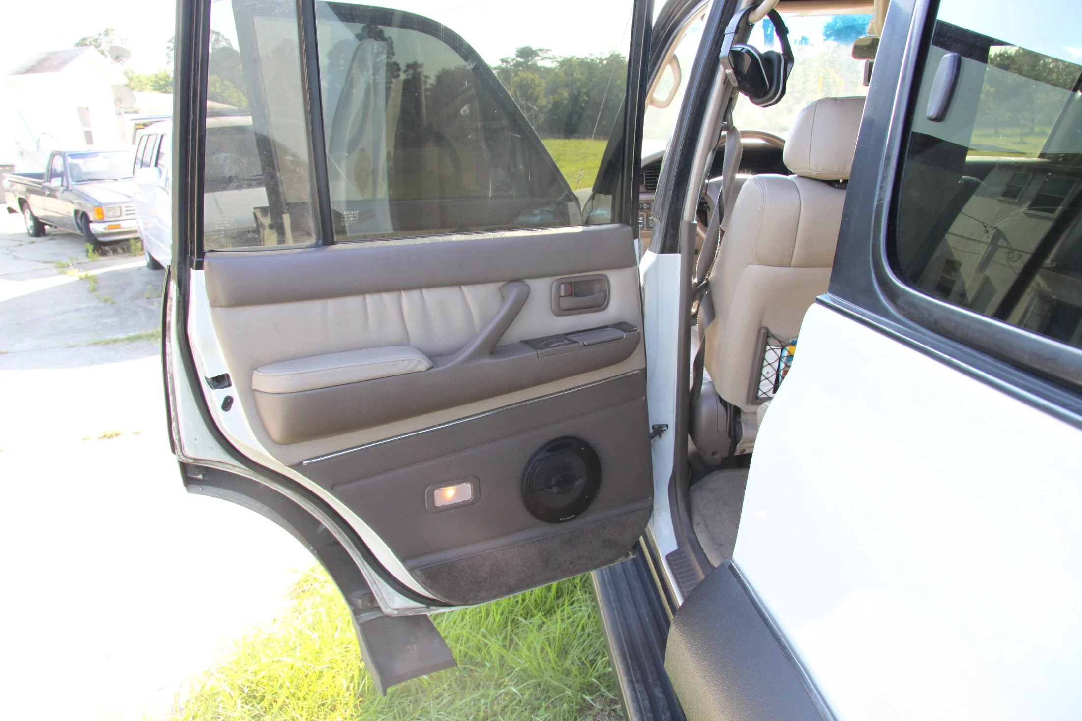

This one went out on me and I'd like to have a new one on hand before I pull the panel this weekend
Is it a regular 194 peanut bulb?
You don't need to pull the panel, the lens just pops off (carefully). And replace all of them with LEDs - brighter and lower draw.
And yeah, should be 194 style.
cheers,
george.
cheers,
george.
Jeez I feel like an idiot
I've been trying to pull the entire housing out of the door
Never thought to pull on the lens alone (doh!!)
