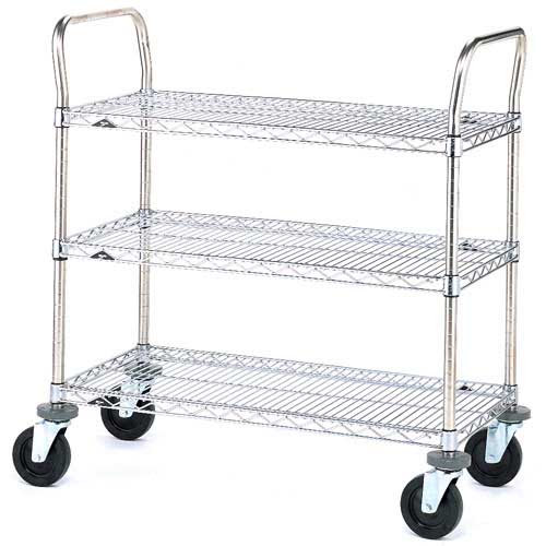

You're over thinking the means to attach the racks. Some nuts, bolts, lockwashers..
A decent drill bit..
and some of these will make a fine way to make it stronger and provide a means to put in shelves, just chop of the sharp points.
For that matter, find an intermetro bakers rack shelf assembly like college students throw away and substitute the plastic shims with some aluminum can or hose clamps.
I think I have some of those posts lying about, I'll see what I can do.
I like the floating rack idea alot though, I like the thought of all the weight being independently supported by the rack's weight.
