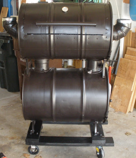

A guy I work with made one out of two 55 gallon steel drums. Did a whole hog on it and people liked it.
It looked a lot like this:
I like it. Kinda reminds me of some of the 'Droids from the background of A New Hope. I gotta rewatch that movie.

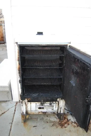

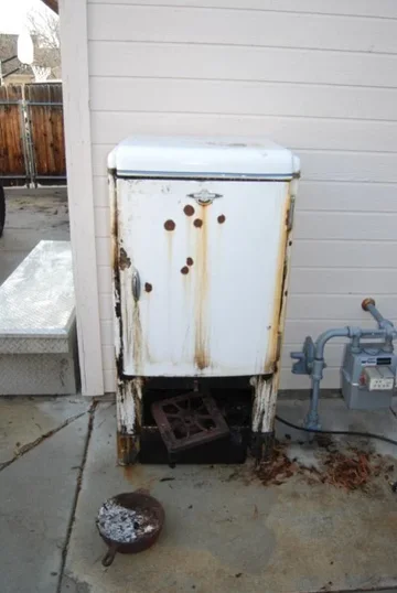

Here's mine. Very simple, very effective. Holds heat around 200 on low.
LP hotplate in lower compartment. Cast iron skillet holds my wood chunks. a 20 lb LP cylinder will last a long time.
meat racks in upper compartment. Fridge racks are OK for larger cuts, but I use 3/16" wire mesh for making jerky.

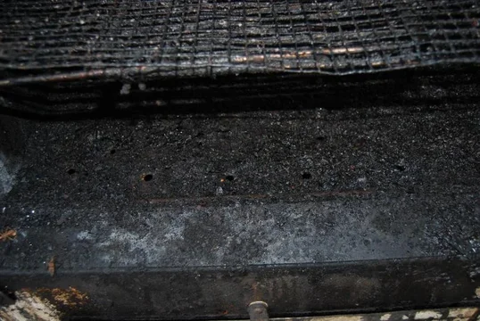

There's about 30 - 1/4" holes in the bottom to allow smoke in from the lower compartment. Obviously I need to scrape the seasoning off the bottom occasionally to open the holes.
