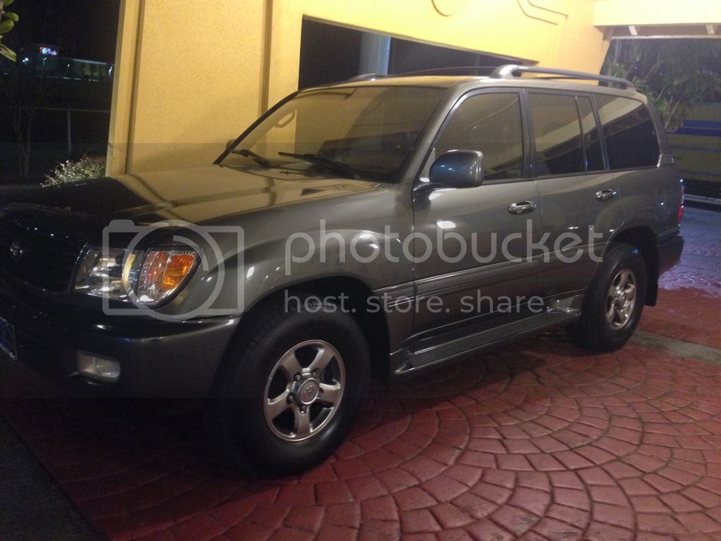

Fast forward about a year, another friend had bought a '00 and did a small build to it, and I was able to talk my wife into letting me find my own finally. I was fairly certain I wanted one without nav and between 100k-140k miles on the clock. Searched the inter webs for about 6 months with several bought out from underneath me, until I was about ready to be a little less picky. Finally, the perfect one came up in Chattanooga, TN and I was able to get a buddy's brother in law, who lived there, to go test drive it for me. Flew up to complete the purchase, and discovered the VSC and Trac lights were now on(they weren't at time of test drive and price negotiation). Negotiated a little more off the price(although I was able to do a zero point reset thanks to mud, once I got home) and made the trek back to H-town(and called my buddy and ordered parts on the drive home).
(La Quinta, Tuscaloosa, AL)
After fresh clay bar and wax job
Build may commence...

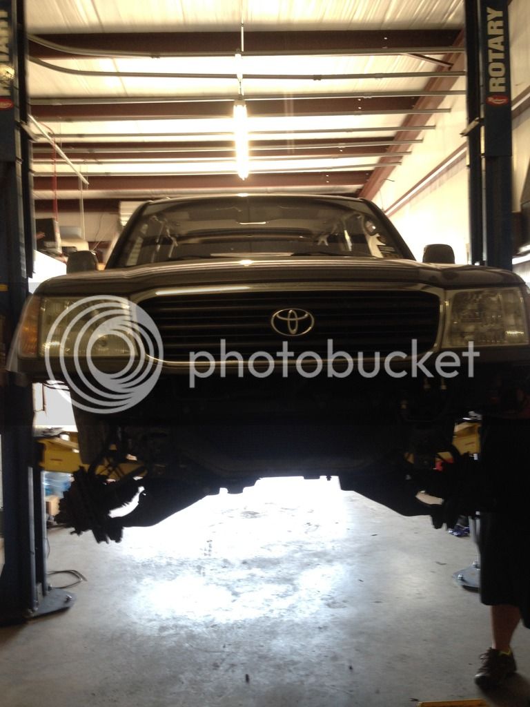

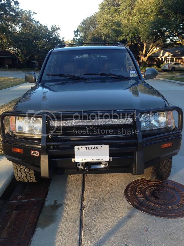

I knew the shocks were toast, even had at least one worn out shock bushing, so I had my buddy who had now built two hundies order an OME medium kit(t-bars, 860 springs, and shocks), Total Chaos upper control arms, an ARB front bumper, Duiser URBs(for the front since I had a Slee rear planned), and Weathertech floor and trunk mats. I ordered a diff drop bracket from Slee on my own. I also acquired new spark plugs and all the fluids I needed to make sure everything was fresh and all gear lube would be changed to synthetic.

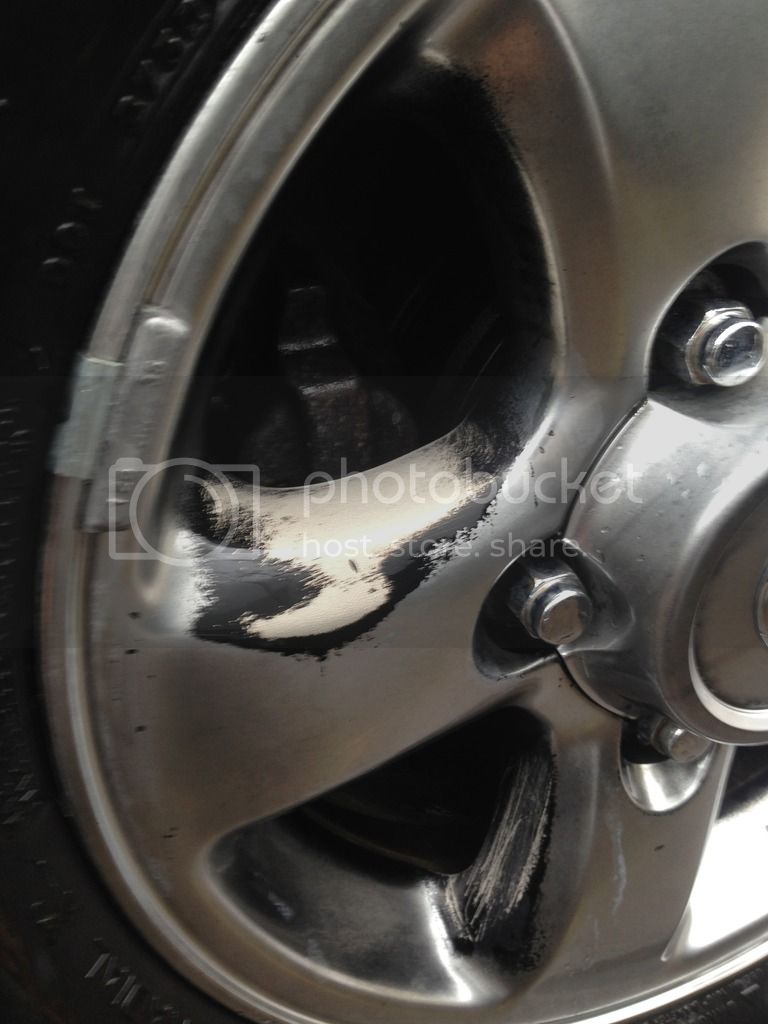

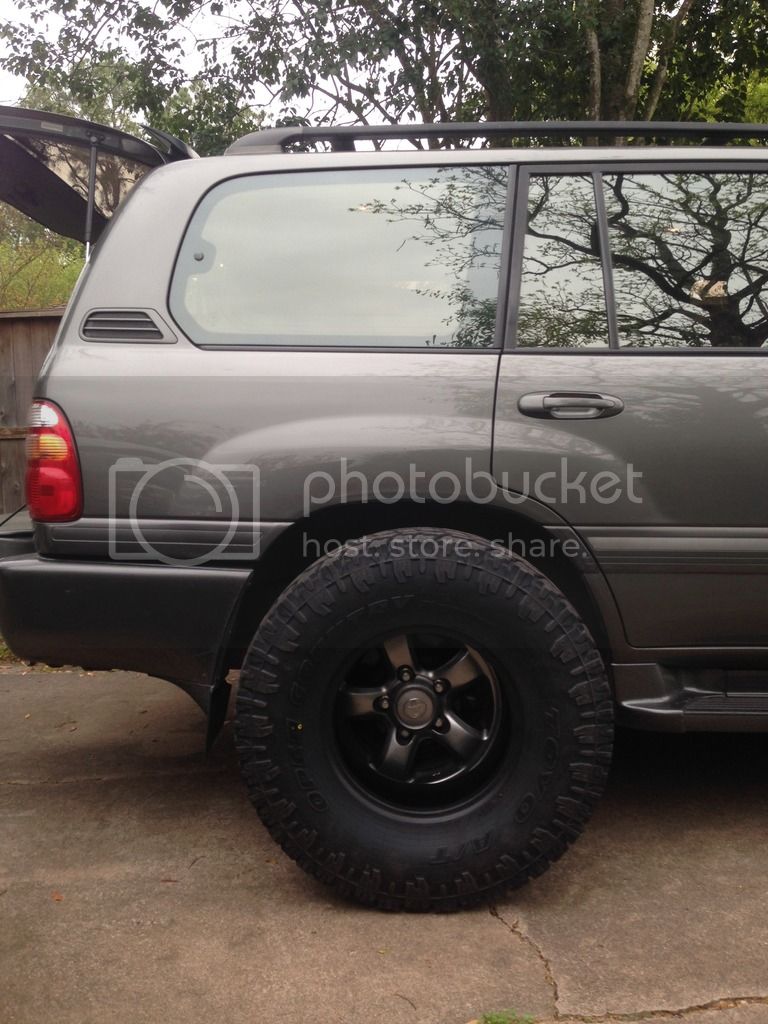

I also attempted to clean the permanent brake dust stains on the factory wheels. I used all kinds of tips and tricks, nothing worked.....until I scrubbed down past the "brake dust" that was actually the wheel primer....:doh: I planned to have my wheels powder coated, plastic-dipped in the meantime, and that is how they sit today.

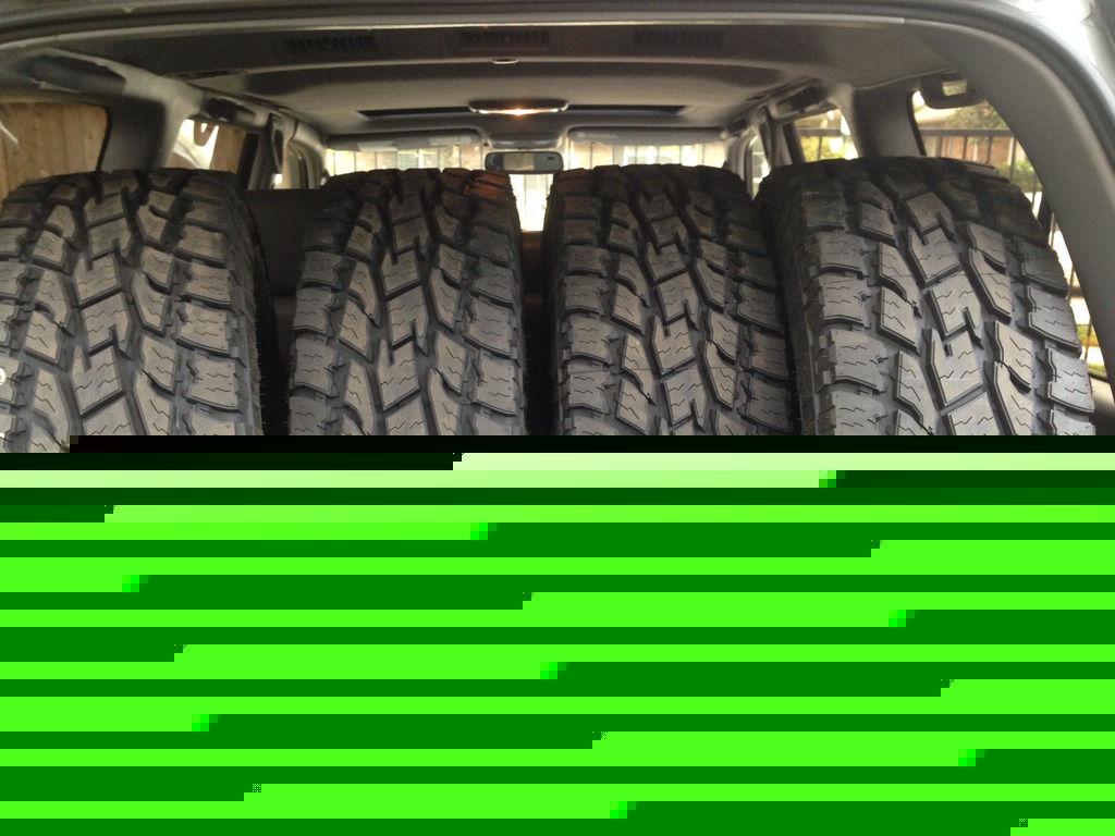

I also picked up some new tires. I'd been a BFG A/T guy for a long time, but a friend who has a Goodyear shop and deals in Toyo's talked me into the AT II Extremes in 295.75.16 for my truck. I liked them enough, that I decided on the same for the Cruiser.
Finally made it to the shop.
After:

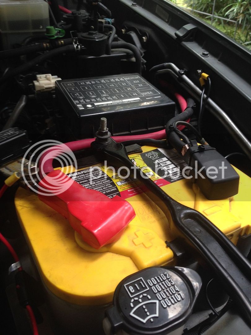

I drove it in above form for about a year. Some mild off road hunting trips and a little bit of exploring. I had 2 yellow top, deep cycle Optima batteries sitting on maintainers in the garage, so I ordered a Slee 2nd battery tray and made some custom copper terminals for the main battery. I didn't have a plan yet for a dedicated battery system for anything, so I just wired them in parallel.

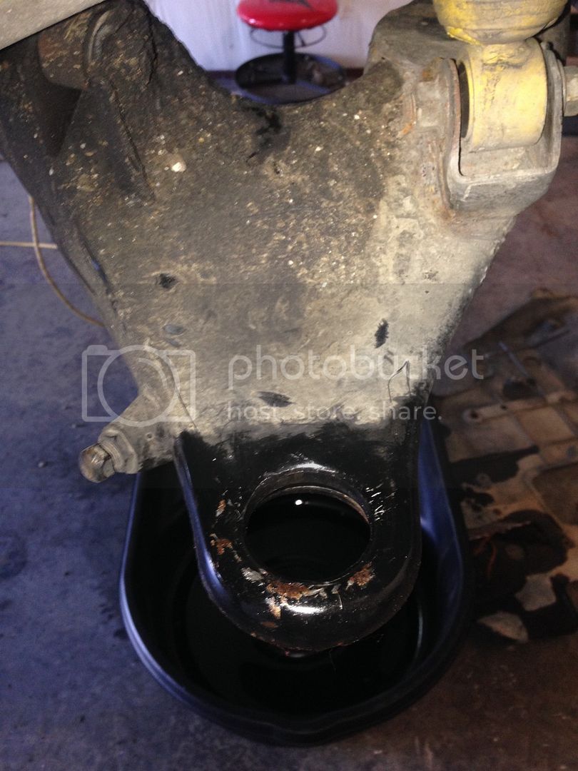

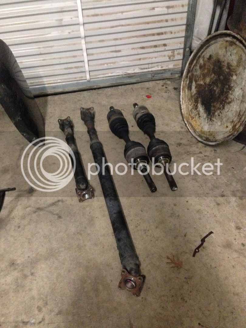

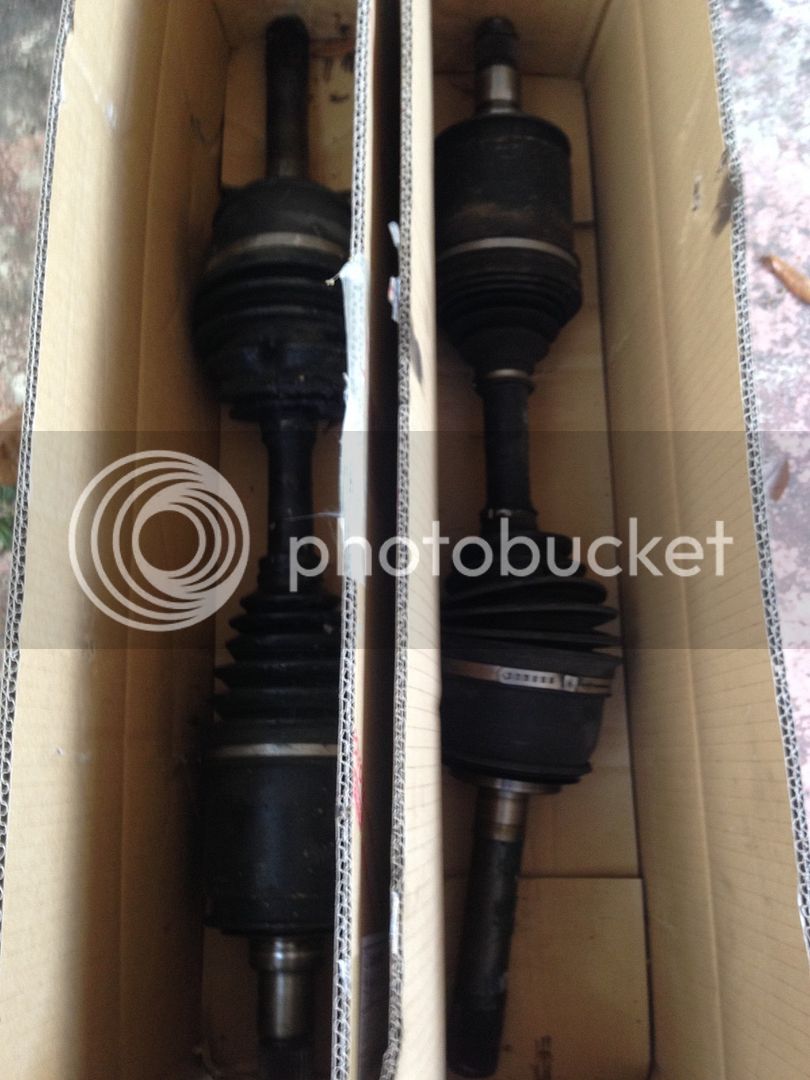

I had the inevitable leaking the CV boot clamps, so I started collecting parts and planned another shop date to put them on and take care of some driveline maintenance. Parts I amassed included a Slee dual swing rear with jerry can carrier, Firestone airbags, Warn Zeon 10-S with remote solenoid kit and wireless remote, Rigid 30" combo bar, Amazon reverse cam, and Cobra 75 CB radio and K40 antenna. It took me until January of this year, before I made it to the shop. The CV boots were totally shredded when we put it on the lift, but they weren't clicking, except on full lock turns. I decided to have a third party shop that my buddy uses rebuild the CVs and repack the bearings while we had the knuckles off. We also sent the driveshafts to be rebalanced with new U-joints(although they couldn't source new front u-joints). I also decided to replace the lower ball joints while we waited and the truck was sitting on the lift...picked up a couple from auto zone.

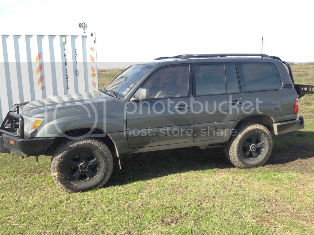

Got everything wrapped up(except the light bar) and went out for a test run down about 18 miles of bad oil field road to our duck hunting place.
Still a bit stiff, but the OMEs soaked up the big holes nicely....somewhere along the way, I lost a c-clip and the driver's side CV back out a bit, and I didn't notice until I got home,...which likely cause a tear in the newly rebuilt axles :cool:
Ordered new CVs, but replaced the c-clip and ran the existing ones until I had time to change them. The torn one started clicking after a few months and few thousand miles.
Mounted my light bar using Rigid's tube mounts from the upper bar on the ARB to save my tabs for anything else I might want to mount. Also replaced my winch hook with a ProLink.

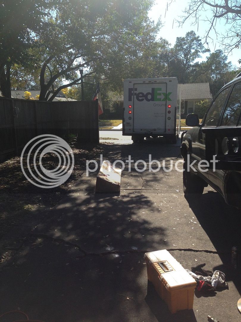

While I was putting things back together, the Fedex man arrived with an important package. Luckily I flagged him down and he backed onto the driveway to drop off my White Knuckle Sliders.

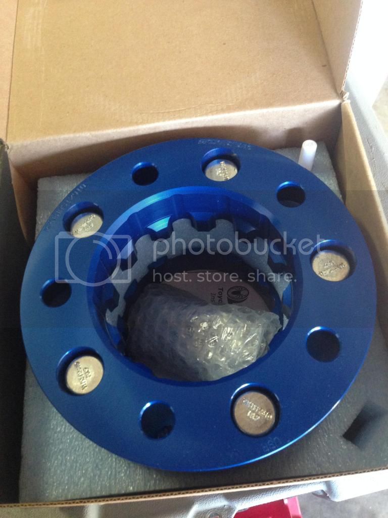

I also got some wheel spacers from Slee, mostly in case I wanted to run chains on my upcoming ski trip to CO.

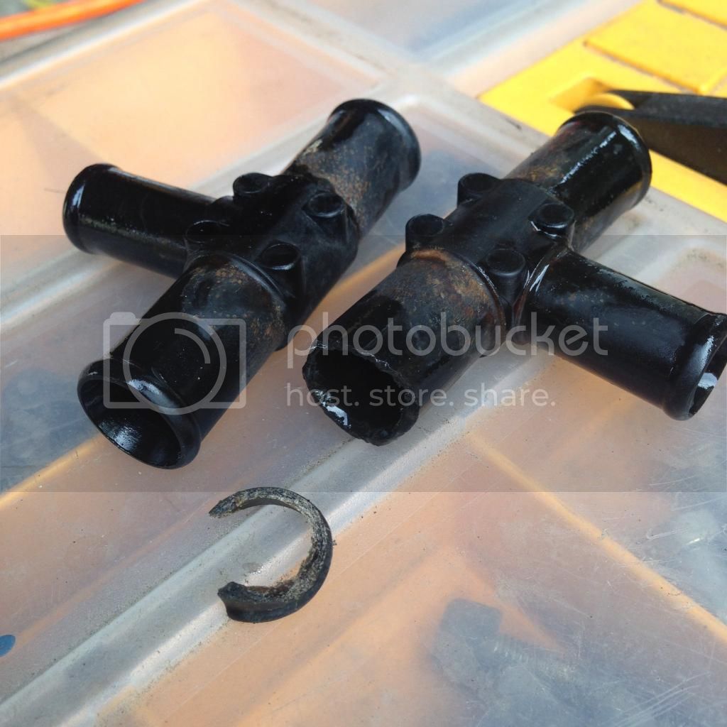

Went ahead and changed my heater Ts

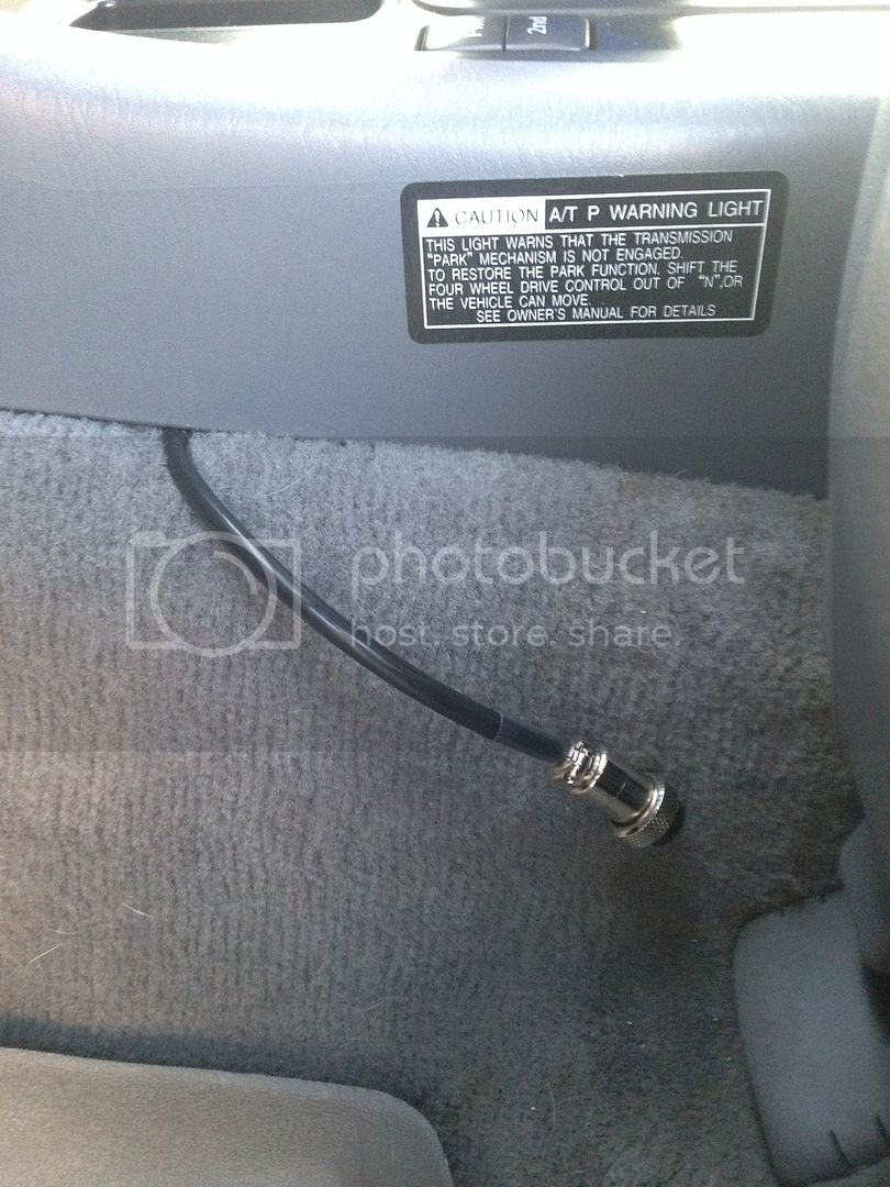

I spend a lot of time in West Tx with poor cell reception, and my friends from Midland always had cell amplifiers, so I installed a Wilson 4g wireless cell booster in addition to my Cobra 75.

Finally replaced those CVs with brand new ones after returning from CO. I also replaced one of the new lower ball joints (warrantied) because it had a tiny hole and would eventually fail due to water intrusion. I wanted to get it out of the way while I had the knuckles off.

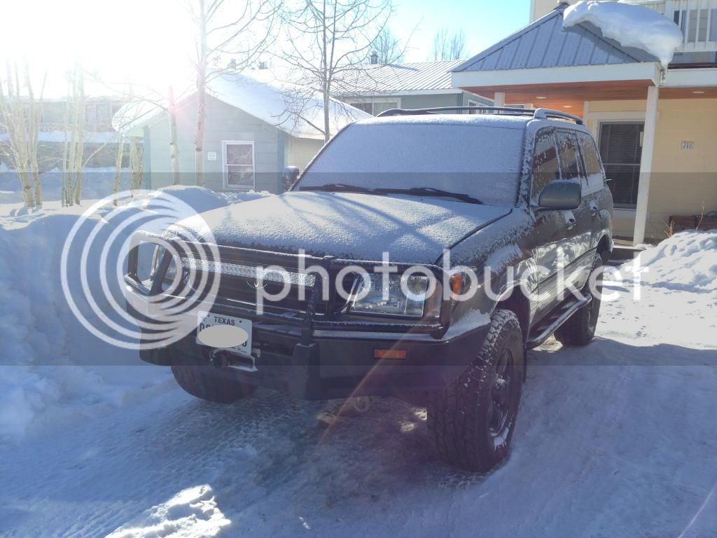

All done for now....

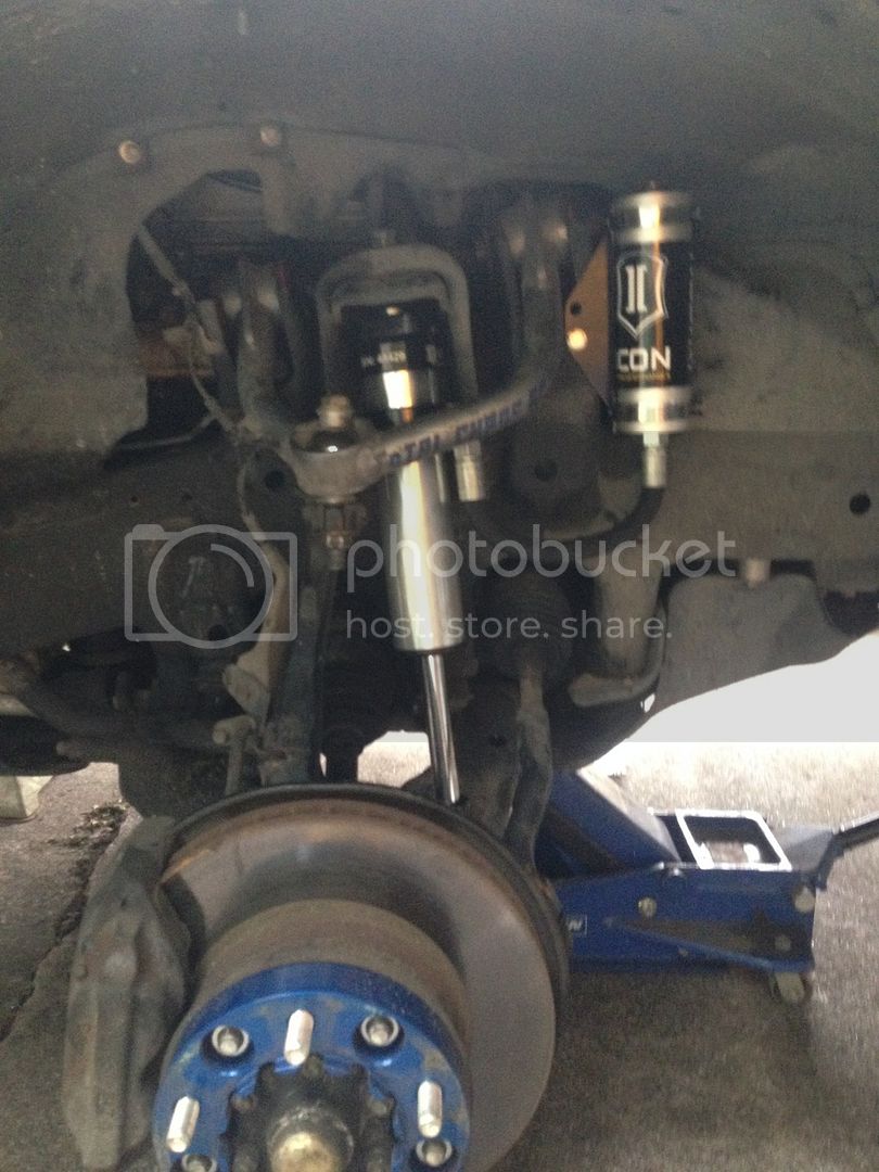

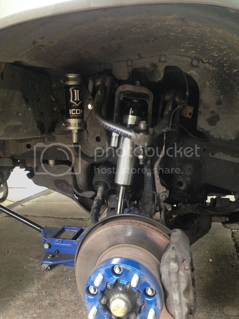

I was getting quite tired of the ride in my Cruiser being worse than the ride in my 3/4 ton, air-bagged, 10k+ lb diesel truck....so I started looking into possible solutions. Although, it went against what I thought to be possible, I decided that it wasn't the spring rate of the t-bars or 860s, since they had plenty of extra weight on them and shocks could improve the ride. The OME shocks needed to go, as people have been complaining for a while about the ride of the newer OME shocks being worse than the old ones.
Some reviews of the Fox units said that although they were compliant, they were too spongy to the point that they were dangerous on the highway. I looked briefly at the King reservoir shocks. I think Spresso review them as being very stiff, which was not what I wanted. I didn't want my cruiser riding like a sports car. I finally settled on the Icons. A buddy ran them both in his F350 and his Ecoboost F150 and I always felt that they rode well. The biggest trouble was deciding which set to get. Icon is proud of their products, to say the least...
I originally thought I would try the Stage 1 kit, but I hadn't found anyone who had any reviews of them, whereas there have been a number of people very happy with the Stage 2 kit. Since I was already spending a good chunk of change, I figured I might as well spend a little more to make sure I didn't regret it.
Before I put the shocks on, I discovered stuck rear caliper sliders had caused my inner brake pads to wear down to nothing, so I replaced the guide pins as well as the pads while I had the wheels off for the rear shock install.

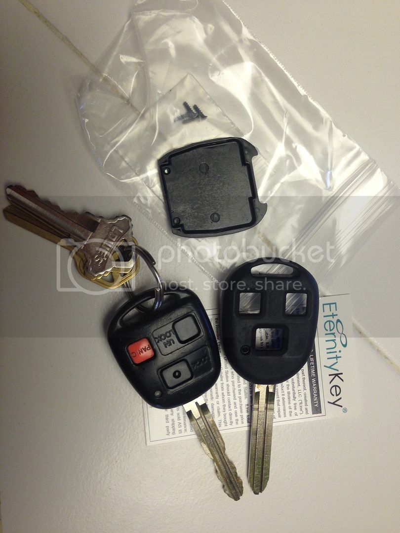

I also was able to source an Infinity key directly from them as an R&D tester, after my replacement key case cracked in less than a year of gentle use.
do you mind having the dark color in the heat? or are you able to keep it covered through the summer ?
Although it is darker than my white truck, I don't really consider it that dark. My biggest complaint is the angle of the windshield seems to lend itself to more sunlight coming through.
replaced/Repacked front wheel bearings and front rotors.
Lengthened rear diff breather and adjusted rear brake brackets for increased axle droop after Icon shock install.
Replaced rear sway bar links with MAF 80 series extended links.....now I just need to order up some new OEM fronts to fab up some extended links for the front.
