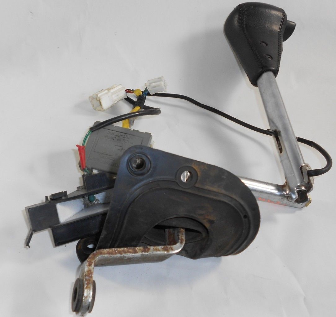

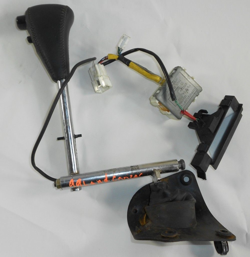

I pulled these pics of the entire assembly off of ebay:
I believe you can release or un-pin the wires from the harness and not have to cut anything. There was a tread on replacing the shifter that covered how to do it.
