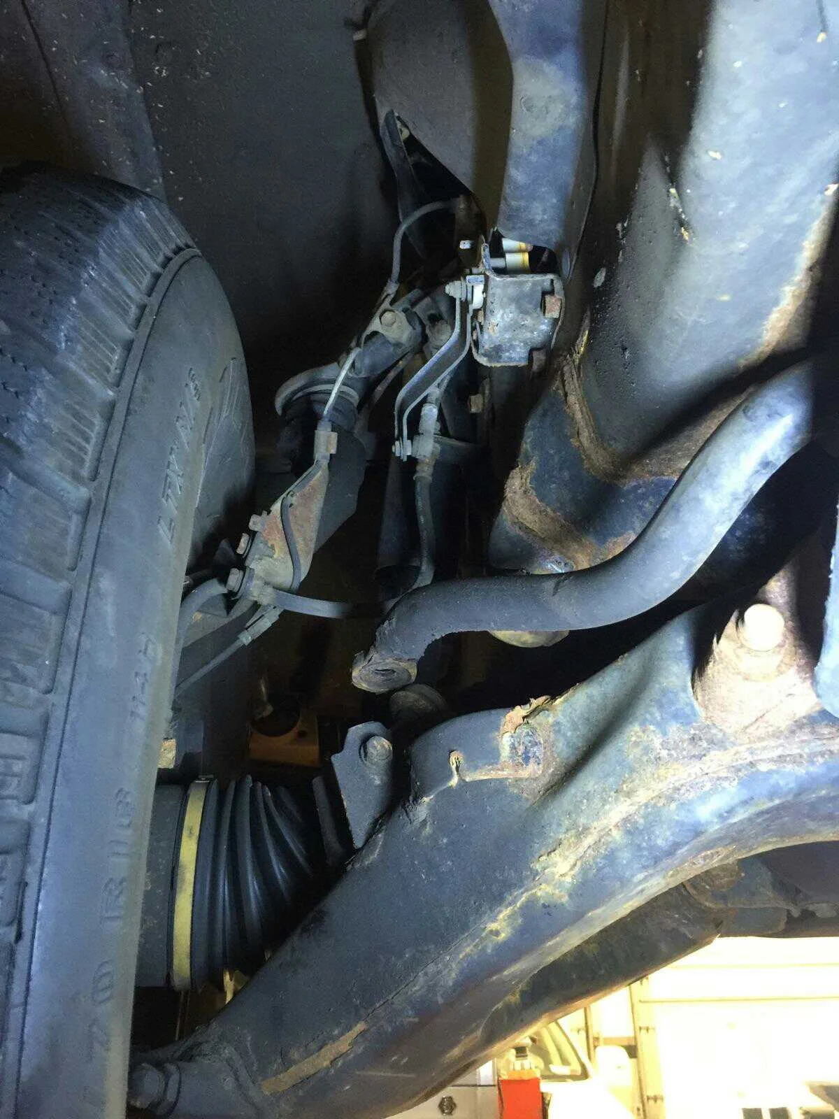

So he calls me an hour later and tells me that the front anti-roll bar endlinks are broken on one side and the other side, while not broken, needs to be replaced. Makes sense. I'm relieved that's all it is, while kicking myself that I didn't take the 5 minutes to get under the car to look. Avoiding Bromberg's Second Law of Auto Repair while dressed for work seemed like the prudent choice.
So while I'm thinking I could have saved all the trouble by looking, but reasoning 'what the hell, let's just get it done', he drops the bomb. 'Tech says it's going to start at 4 hours of labor and go from there'. Estimate? About a $1,000 dollars.
I was dumbfounded. So much so that I literally couldn't get words out of my mouth. I unintelligibly get the service rapist advisor to text me pictures of the problem. Confirm I'm not crazy, pictures are of a broken endlink. So I call him back. I ask how it's possible that it can cost that much. 'Well there's a lot of rust', 'we want to do that job right', 'we can't leave it like this', 'my kids need to eat and I really like smokey single malts', ect. So I ask him nicely to go back to his tech and double check, as it seems a tad unreasonable.
He calls me back. Tells me the parts are over $300 and that maybe, maybe, the tech can do it closer to 2 hours. He's doing me a favor here. So I ask him if he has the part number in front of him.

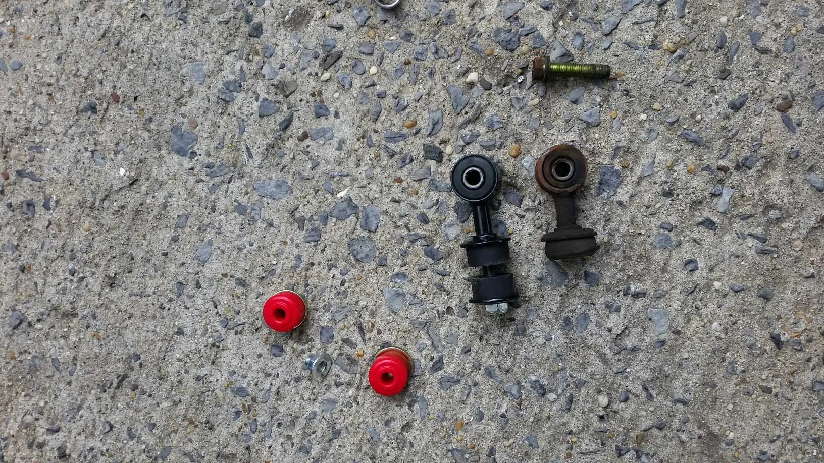

Little did I know I had the parts at home, along with poly bushings. I didn't need to jack the car, just turn the wheel fully the opposite way. Jump in with a 14mm wrench and they pop right out. A very casual 15 minutes per side, the old are out, the new are in, and with a beer in one hand I'm back on the phone leaving a very polite voicemail for the service manager. Now, as mad as I was that they would have ripped off my wife or mother without a second thought, the voicemail to the service manager was polite, but I never heard back. He must have a two gold rollies.
