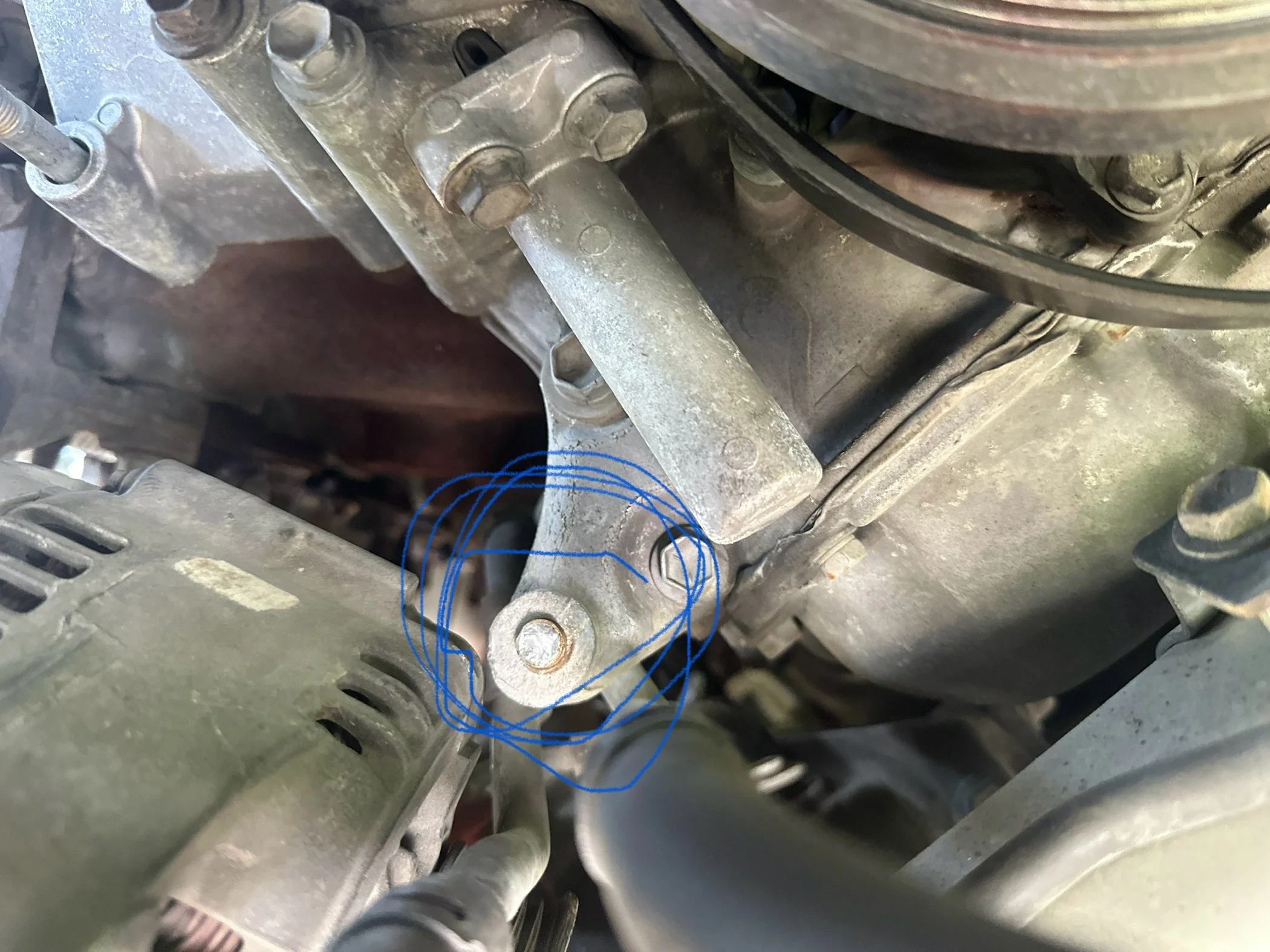

TL;DR. What do I do about that broken bolt?
When try to replace my alternator, I feel like everything that could go wrong, did.
StepsResult
Air filter box removalBroken vacuum inlet
Power steering pumpSuccess
Bottom Alternator boltbroken bolt into block
10mm electric removal Stripped to sh:t, vice grips called in
ConnectorCrumbles in my fingers.
Removing thru the bottom Nope
Fan ShroudMore like shred and broken tabs (started that way)
What do I do about that broken bolt? Not a lot to grab.

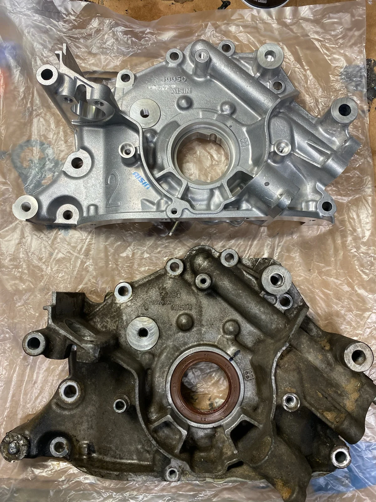

I'm sorry to report this to you, but I had the same issue. I tried numerous times to weld a nut onto the bolt ( probably tried 10 times) but it was just 100% frozen in there. I even tried heating it up red hot with an acetylene torch prior to welding the nut on. I also tried drilling, but what was left of the bolt was so mangled and hard as stone that I could not even get a drill bit started, the bit would just hit what was left of the mangled aluminum. I pretty much destroyed the surface of the oil pump doing so many attempts at getting that bolt out.
After all this i mad the difficult choice of replacing the perfectly good oil pump with a new OEM one. The good news - the oil pump is surprisingly affordable, probably because they never go bad. The bad news- it's an extremely involved job, i actually had the engine out , but it can be done with the engine in
