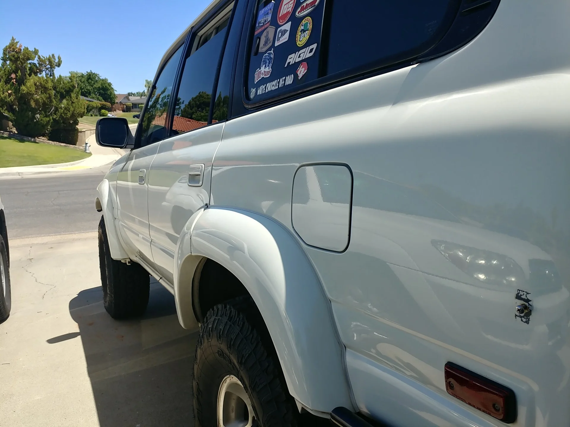

This is on a 96 stock white paint. Need to buff it, used just Griots complete compound and I believe I even used their pads. Followed up with their wax
Not the best pic but brought it back to probably close to new condition
