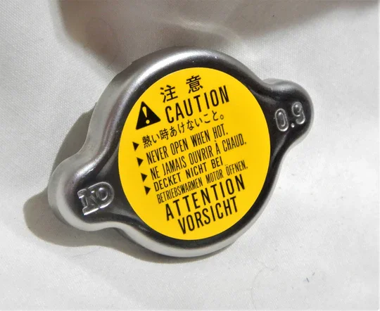

That Cap with the RED hand valve is a no-no bad thingy
i WILL assume its a Small Cap 4/86 - Later

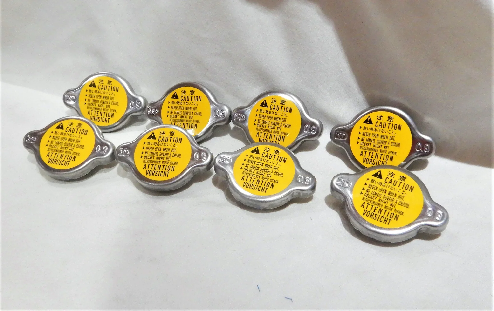

the Double EPDM is what is required here
this is a Genuine NipponDenso Saudi Spec. region Commercial Grade HI-HEAT / Also Cols Spec ast the Correct 0.9 Pressure Rating
if Your Correct cap is working as it should ? why the hand Valve ? TOYOTA never used a hand valve
These work well with the CSF Brand Goose Neck , and also have the 1/2 turn De-Pressurize feature
Well shoot. Didn’t know that. This is what the guy had at autozone. I’ll buy one of these instead.
