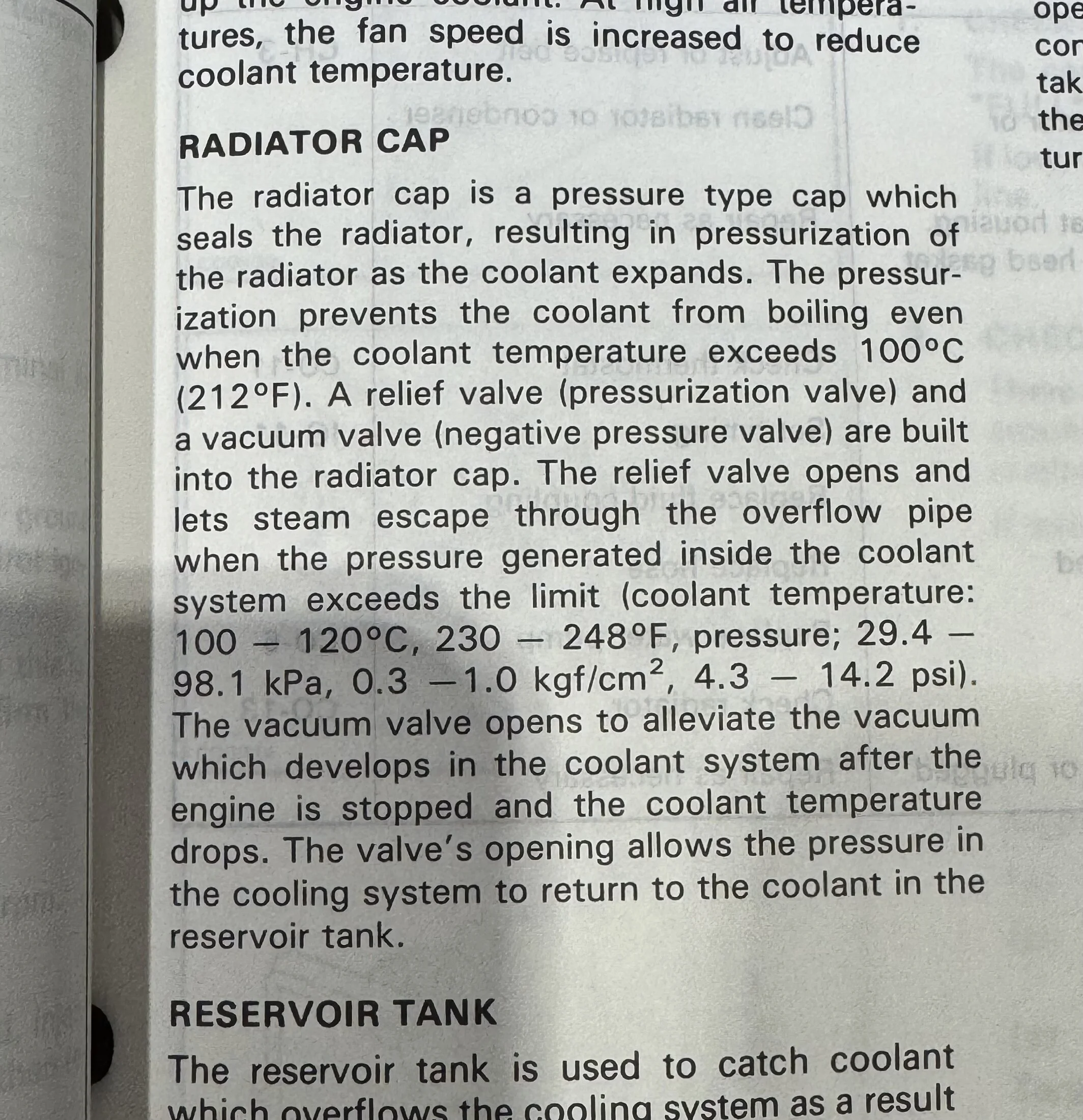

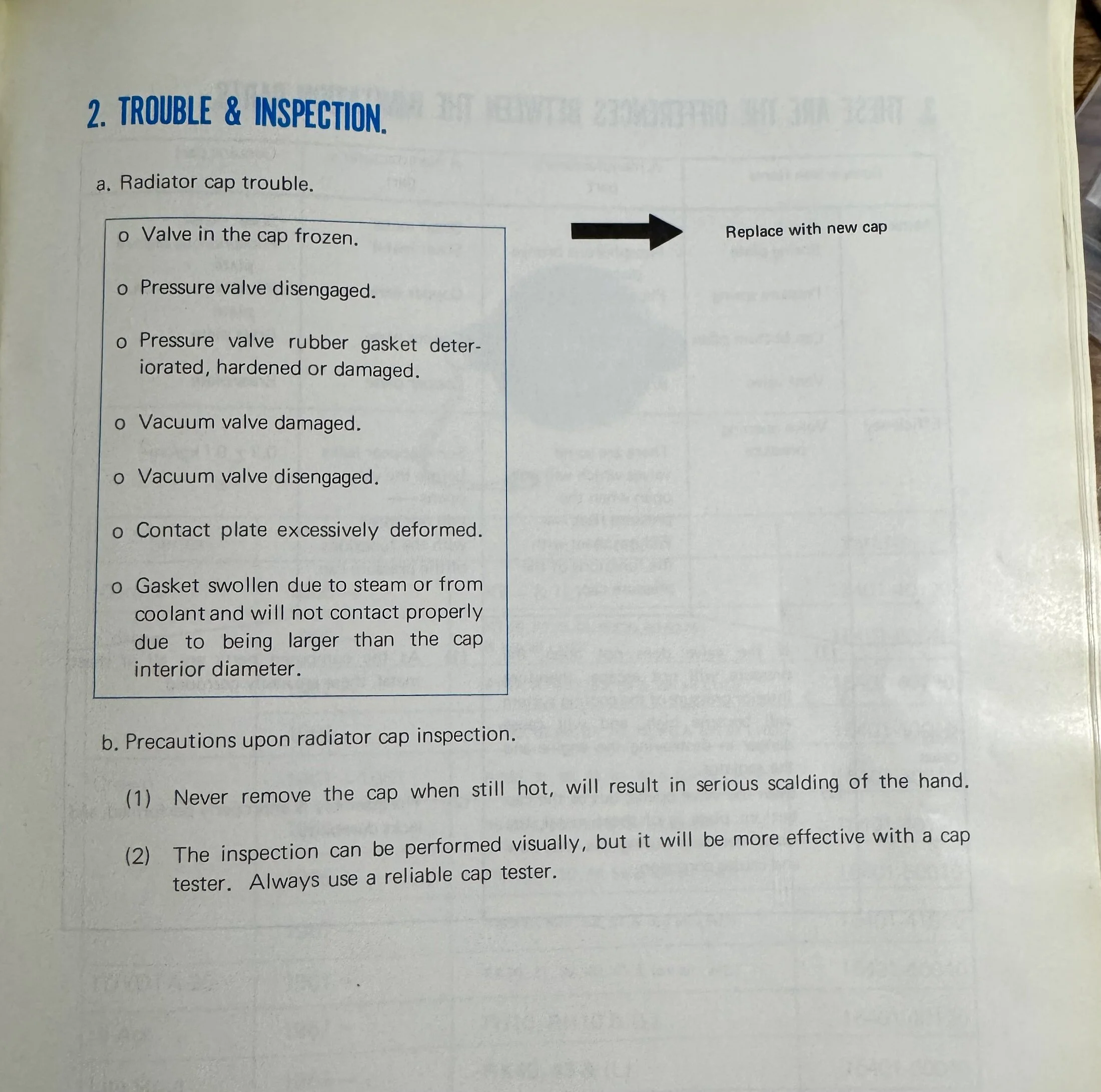

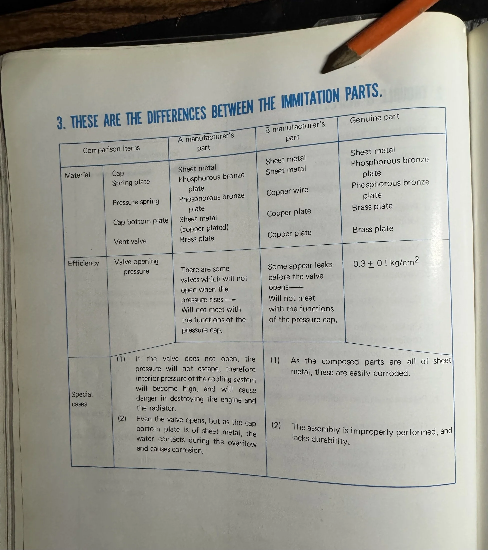

my personal OEM kool-aid in-place .......

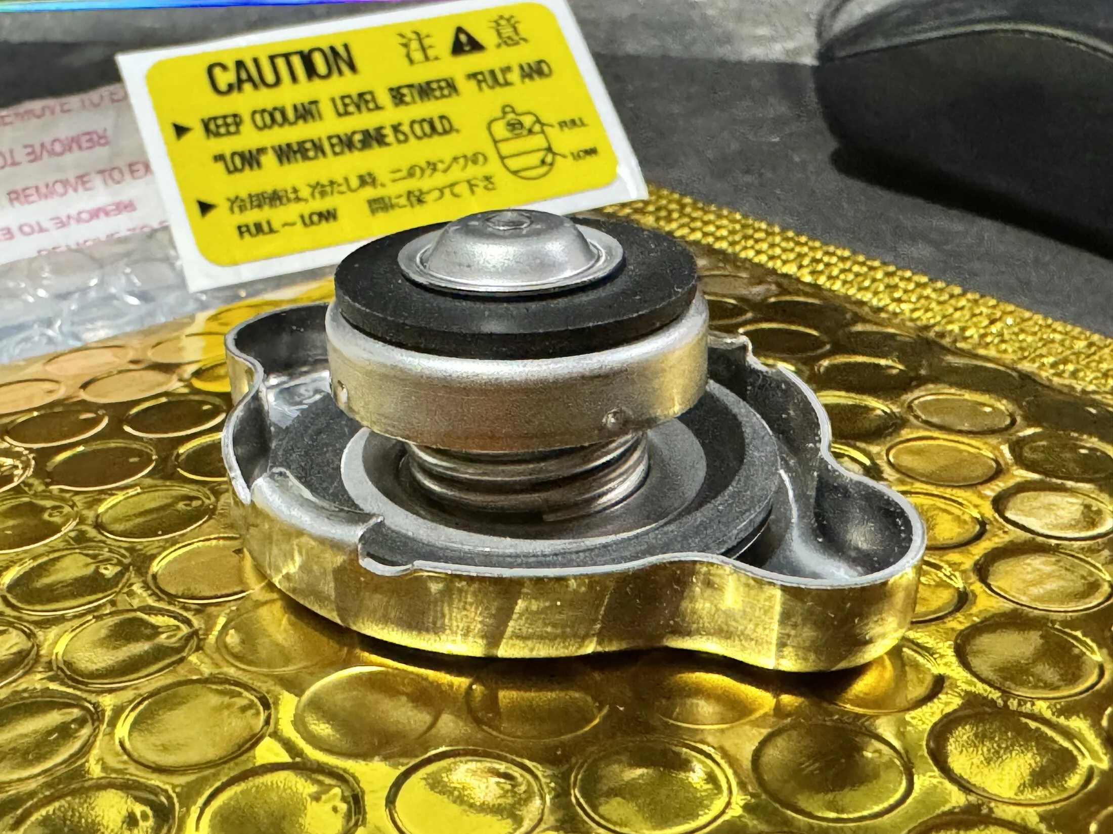

small-cap 4/86- Later all TOYOTA's Globally to present day : - 4:38 PM Sunday, December 22, 2024 (GMT+9) Time in Tokyo, Japan

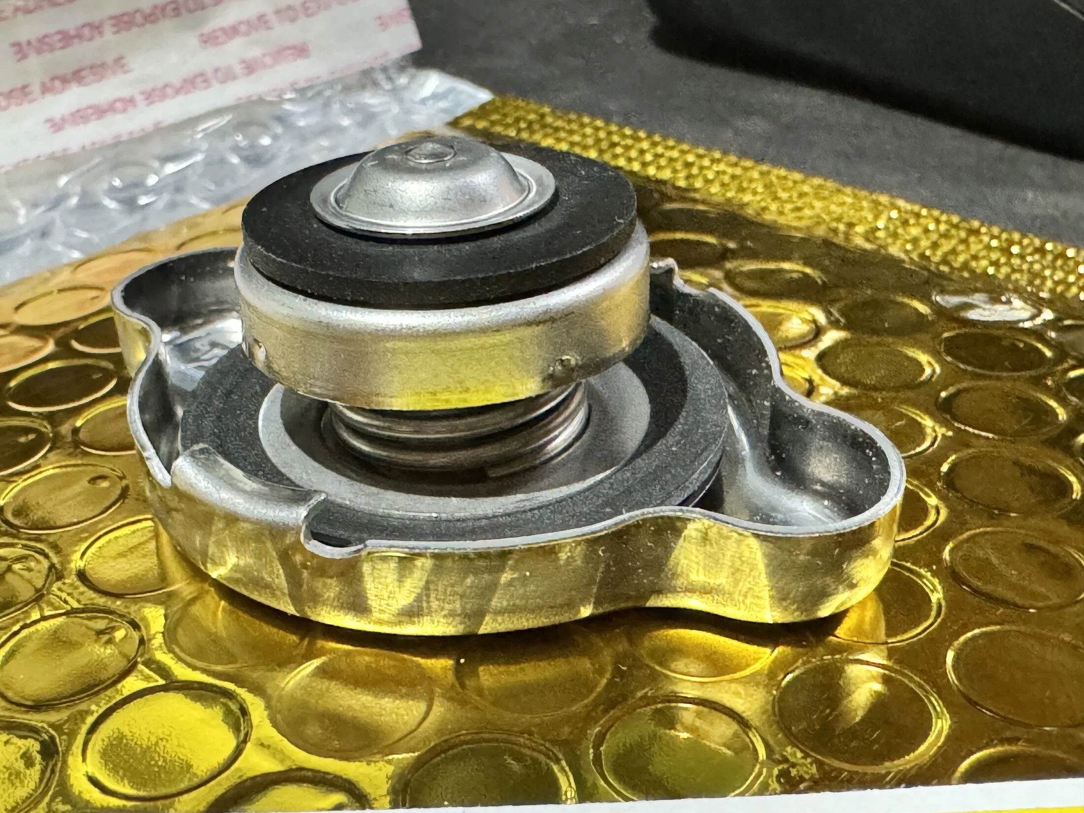

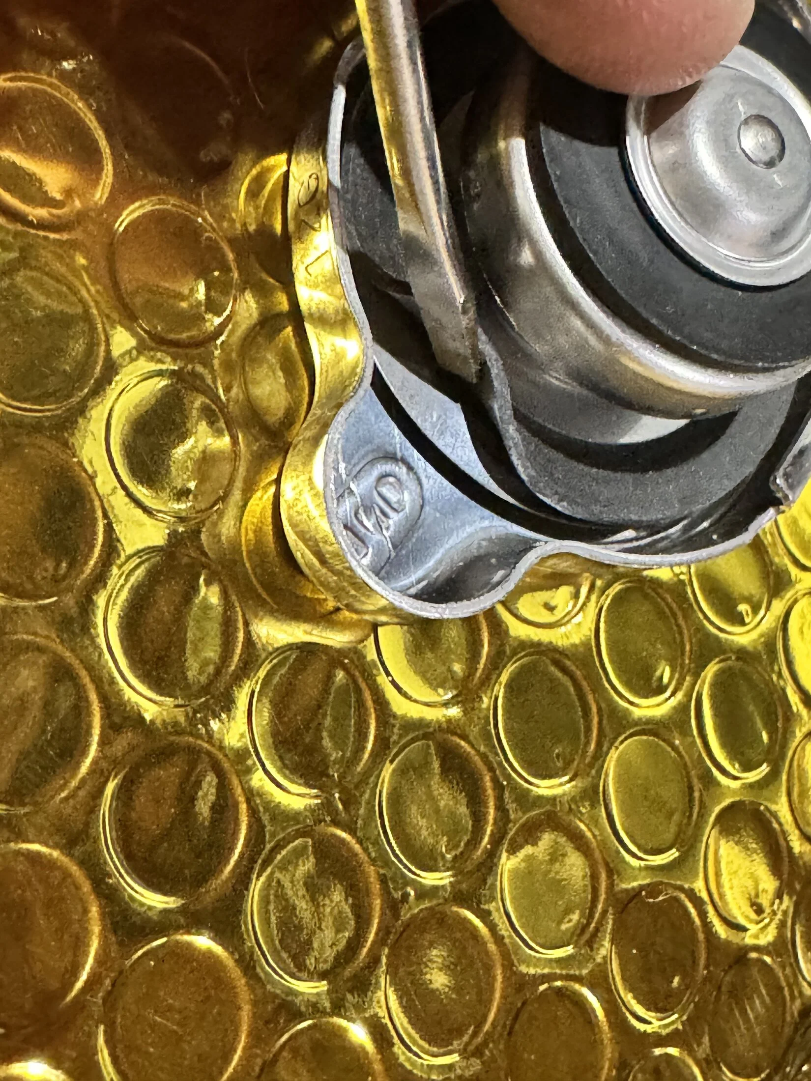

Approx. 3+ years old same exact OEM Small Cap , my personal Shop Road Runner GHOST
Note : the thicker then the USA dealer available made in Japan one you would get if you gave your VIN # and just relied on some dealer parts counter person texting there peeps on hand and hopefully looking up your “ correct cap “ in another ….🙄
- updated Caution Label …
Same Width , simply twice as tall …
That was interesting. Slightly taller cap?
