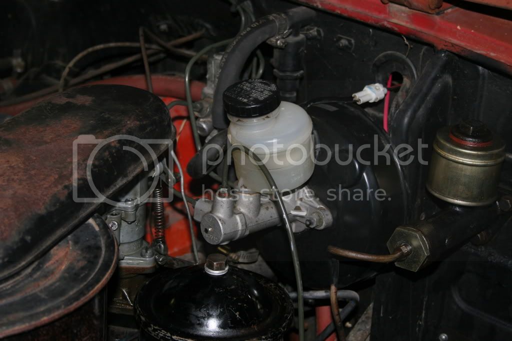

PER MY PREVIOUS UPDATE, here is a picture of the master/booster:
Hummm. Along time ago I pulled a good known master cyl out a car and put in my cruiser, it did the same thing as what you're experiencing. I put a different master cyl on it and I didn't have the problem again.
What car did you get that master/booster out of?
97 Suzuki - and I thought it may be a bad booster/master, so I went and got another identical one. Same issue, both setups.

Where would you get the idea that a disc brake master cylinder from a '97 Suzuki, an unknown and yet to be determined valve behind that, and four wheel drum brakes might be compatible? :bang:
