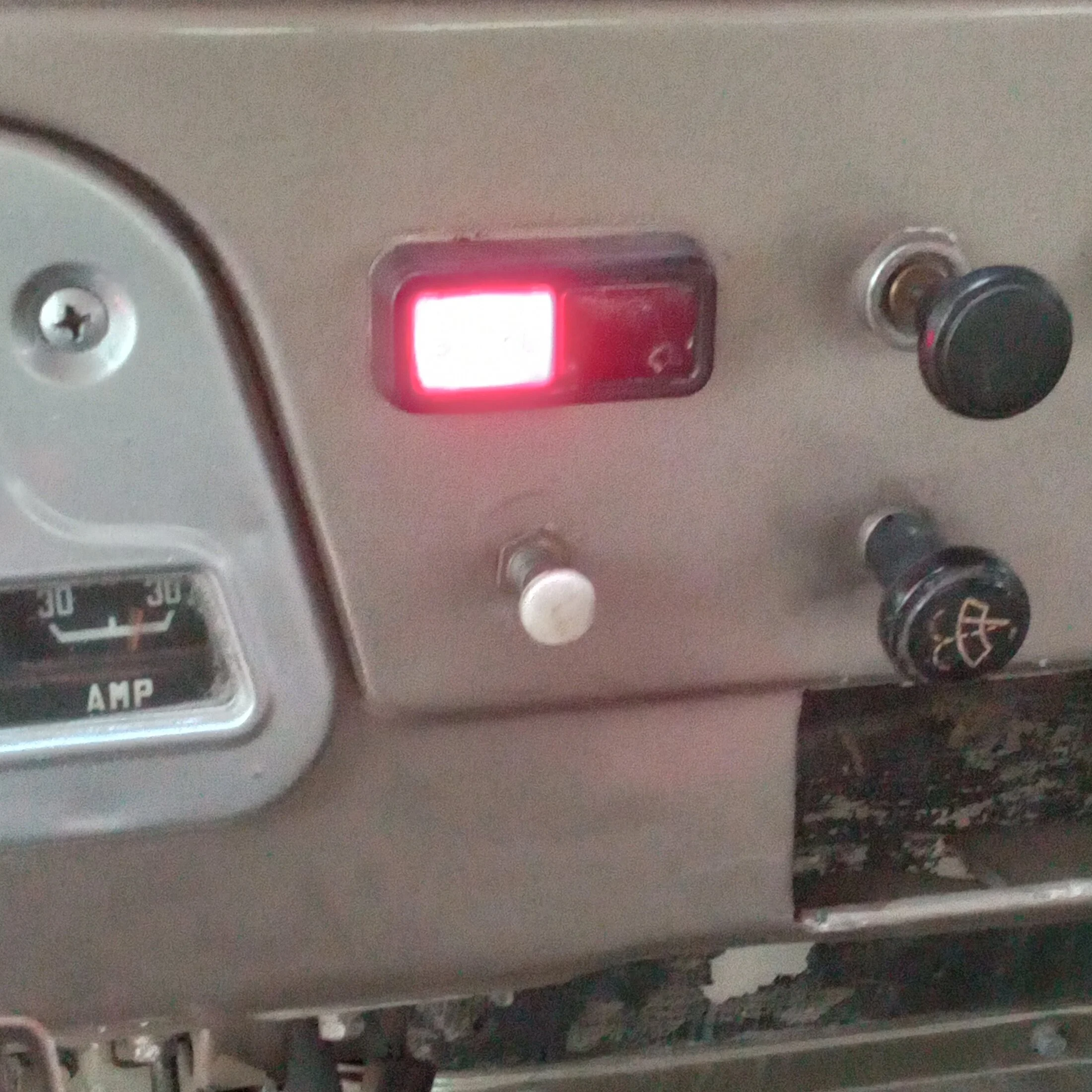

...my brake and back up lights come on when brakes applied and in reverse gear. But when the engine's off? Is this normal?

The brake lights at the back of your truck will come on any time the pedal is pressed, but the ignition switch will need to be on before the red light on the dash will come on.
FYI this light is dual purpose.. if the handbrake is off, and that light comes on when the pedal is pressed then your brakes need adjusting..

YEs, the vehicle inspection guys said to investigate the rear right drum. Come to think of it I did feel a pull back there. Wonder what it is. Truck has original brakes. .
You have two pressure switches on the brake master cylinder. The red light indicates that at least one of them is not activating when the pedal is pressed.
Try pulling each wire off in turn to help understand what's happening.
Sounds like you might have a stuck rear cylinder, and the front circuit then can't get upto pressure before the rear bottoms out.

...brake pedal on, no light
...brake pedal off, light

...lights off when brake pedal depressed. The japanese had their own way of doing things, hey?
