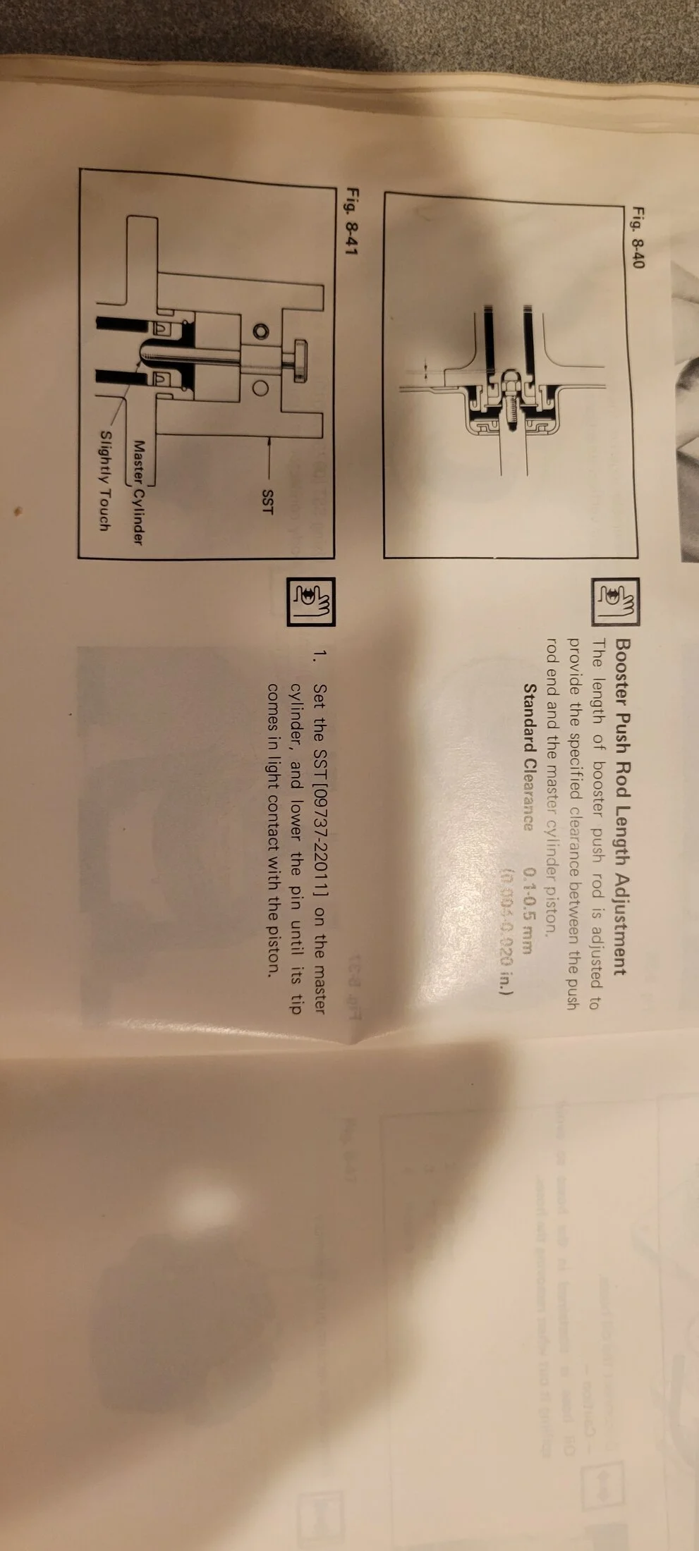

I have a '68 with all drum brakes, and my strong preference is to keep it that way. However, I've read through i believe every drum brake post and still can not get my brakes adjusted correctly. I've adjusted the push rod into the master cylinder in and out several times and I still can't get it right. I can get the brakes reasonably effective at one setting, but then if i drive it on the freeway for any period of time the brakes get firm until the point they've actually locked up and I had to leave it overnight to cool off. If i back out the rod some then the brakes are just plain ineffective in stopping the truck.
any advice here?

Thanks everyone for the suggestions. I should have been more thorough in my description. it's a 1968 40 without a booster and i have upgraded to a dual circuit. So far I have taken your suggestions and adjusted the push rod length (it was off) and now going wheel by wheel adjusting the brake cylinders as specified in the Chassis and Body Repair Manual.
