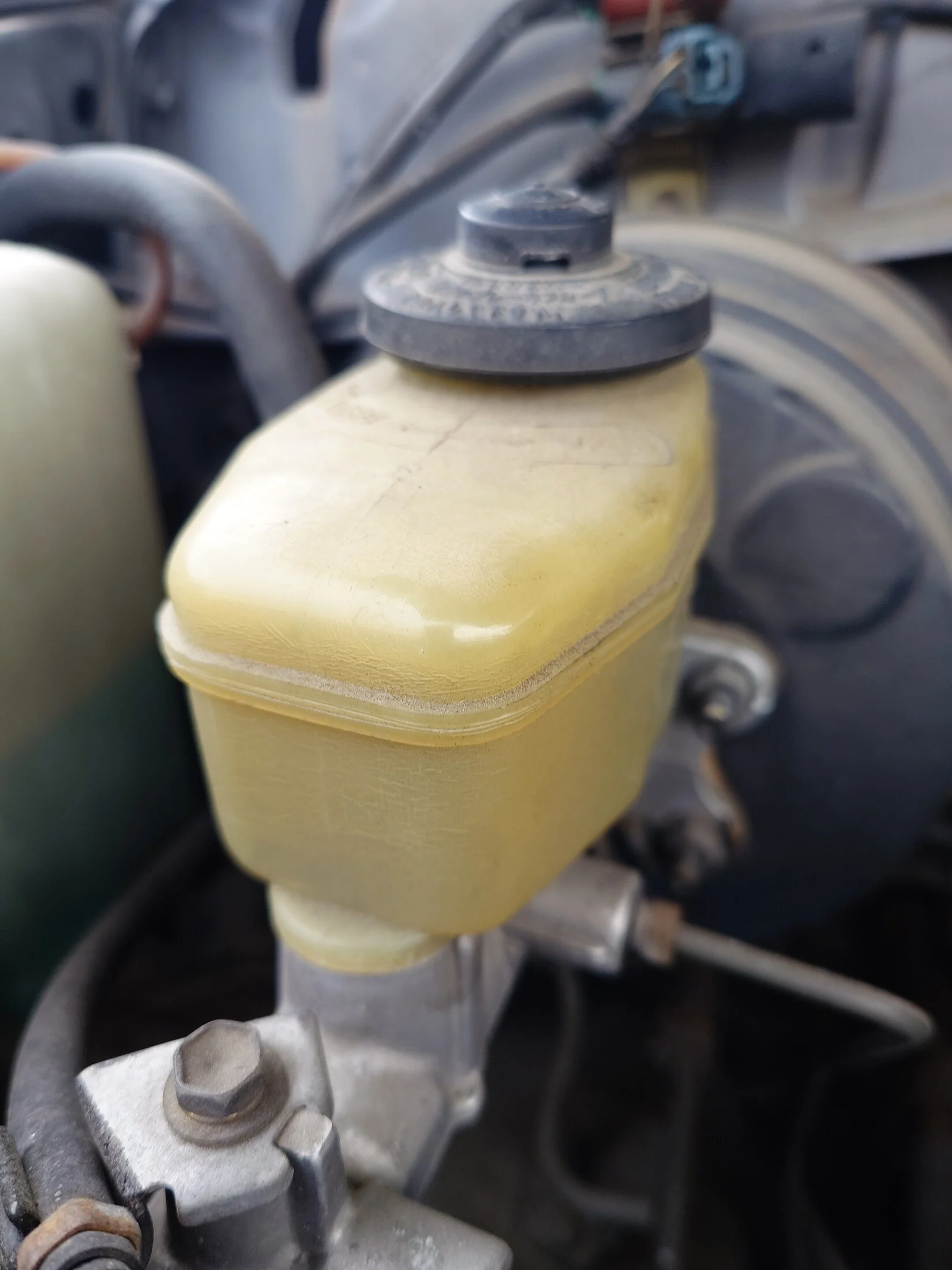

The Brake Master Cylinder on my 94 Prado is beginning to age and show cracks. I've been looking at Terrain Tamer's BMC, ADVICS BMC sold on Cruiser Teq and wanted to ask how do the aftermarket parts like TT and ADVICS compare to AISIN/OEM?
Thanks in advance
Samsies... in fact every KZJ78 I've seen has a cracked / crazed reservoir.

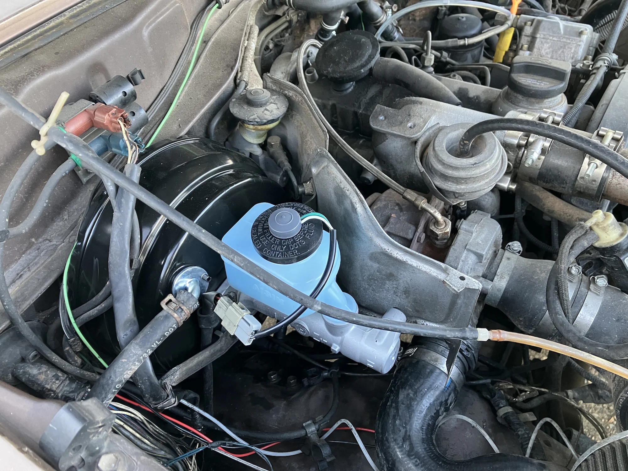

The only difference I see in the Cruiserteq ADVICS version and the OEM version is the ADVICS MC appears to lack a location to attach the cable bracket for what I think is the throttle cable. I could ether have a tiny bracket welded on to the end of the ADVICS MC (preferred for long term) or just use some zip ties (not as good to solve my OCD issues, but probably works for the next 10 years).
I have an 80 series MC and I could not find online a matching electrical connector for its fluid level switch. I snipped and soldered on the old BJ74 mc connector to the new mc cap.
The 80-series master cylinder I used had the same cap/sensor plug as my original LJ78 one, so it was plug and play:

Advics BMT051 (BMT-051) from a 93 T100 is available at Rock Auto ~$62 fits, and looks very similar to the one posted by @AirheadNut . This has a 1" bore (slightly bigger than standard 70 series master, but same as 80 series master), also has the fluid level sensor in the cap. One may or may not have to swap the plugs depending on year.
This one from cruiserteq looks like a direct replacement for you, is OEM, and is perhaps the one you went with. It has the bung to mount your throttle cable, or what ever it is that is shown in your photo:
