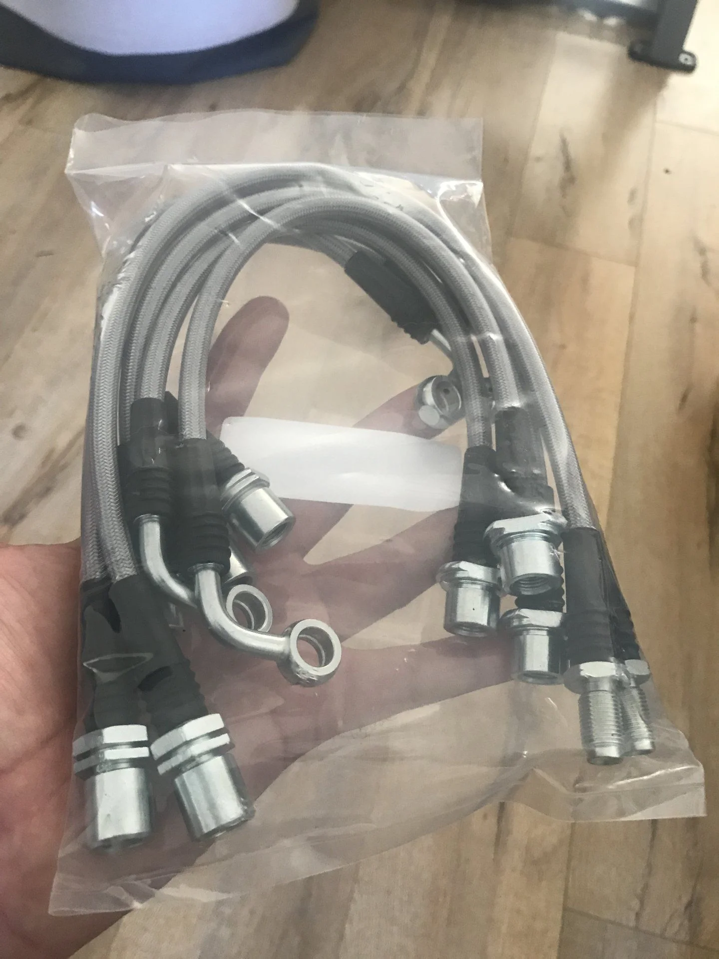

For the 3 needed for lifted trucks:
For US made stainless steel DOT brake hoses for lifted trucks, give me a couple more days for the OEM hardware to arrive 😉
