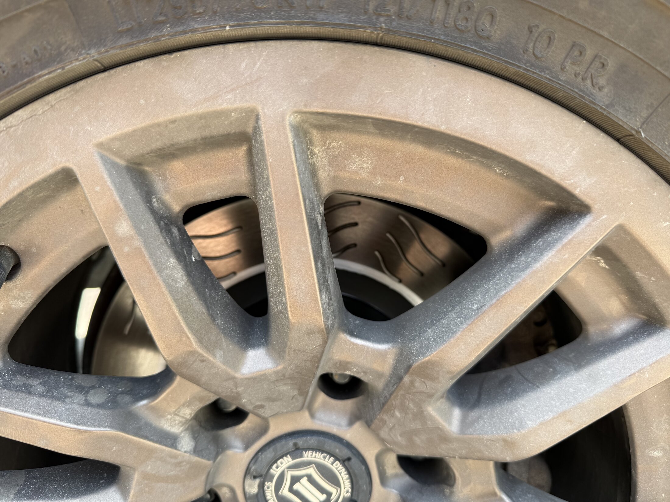

I installed new pads / rotors from NAPA on my GX460 and there is a slight grinding noise at low speeds ( I think it's just driver side ) that goes away as soon as I hit the brakes even just a little. Both rotors also developed this silver ring on the inside almost immediately and have stayed the same size.
I immediately went on a camping trip with some steep declines in the mountains and then a 700 mile trip on the highway and they performed great. While nothing has changed with the silver ring that appeared the grinding did get better but is still there a little.
I've always done brake / rotors on my Tacomas before my GX and have taken everything apart and installed twice but can't see anything off.
Should I keep on as usual or take it to a shop?

Does the outside of the silver ring line up with the inside edge of the brake pads? Just guessing, but maybe the silver ring is an unworn surface where the brake pads don’t quite reach, i.e., it was always there but the outside ring got darker with wear. (Or, of course, maybe it’s something else rubbing that shouldn’t be.)
Do the inside and outside of the rotors have the same silver ring?

The ring is the same on both driver / passenger with no lip or rise ( rotor is completely smooth ). I just looked at the product photos on NAPAs website and I can actually see the ring so I'm not too worried about that anymore. You can see it on the 3rd photo:
I went with Akebono pads this time and they claim no bedding is necessary. Even the NAPA employees told me I was fine but I still went through the process. I'm going to take them apart again tmrw and I'll snag some more pics. The "grinding" noise goes away as soon as I get over 10ish mph.
