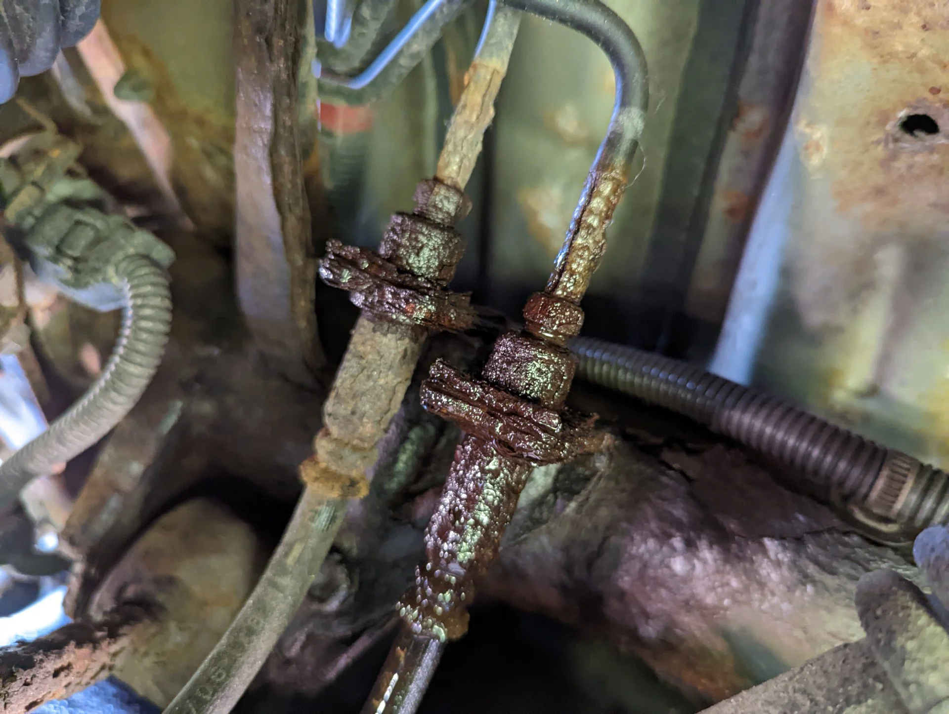

Morning all. Yesterday my wife's GX470 lost most of it's brake fluid. Wife said she hit a rough patch of road and the dashboard lights lit up. Gas tank is soaked in what I assume is brake fluid. Haven't crawled under it yet. Hoping it is just a busted rusty brake line.

Think I found it. Looks like the leak is at the transition from hardline to soft line in the rear. Most of fluid was dripping out of the gas skid plate. Looks like I have drop the skid plate to replace the brake line along the frame?
Blast it off with brake cleaner and see where it’s coming from
Good idea. Line fell apart when I tried to loosen it anyways so it is getting replaced.

72" flare tip m10x1 was a decent fit. Found it O'Reilly's. Poor guys were the only auto parts store open on the 4th of July. Have about twoish extra inches.

We had this happen too. Should replace that other line while you are there!
You are correct. The other one is looking crusty. Was doing the work in the middle of the field where we are camping. Going to order prebent lines and replace both this summer.
