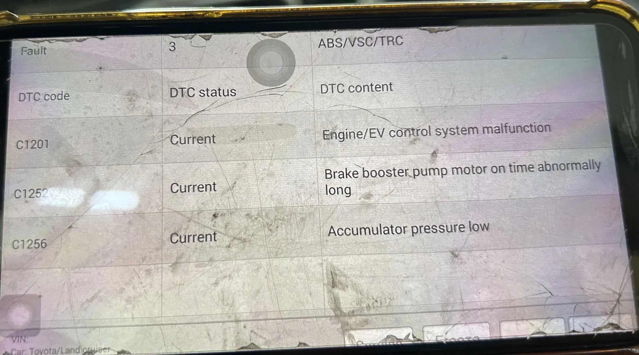

April 2025. I have exactly these codes: C1201 C1252 C1256
Landcruiser V8 VX 2011. Engine/Motor No. / No. Enjin/Motor 1UR022XXXX
Chassis No. / No. Casis URJ202-400XXXX
C.C./ Watt Keupayaan Enjin 4663.00 CC

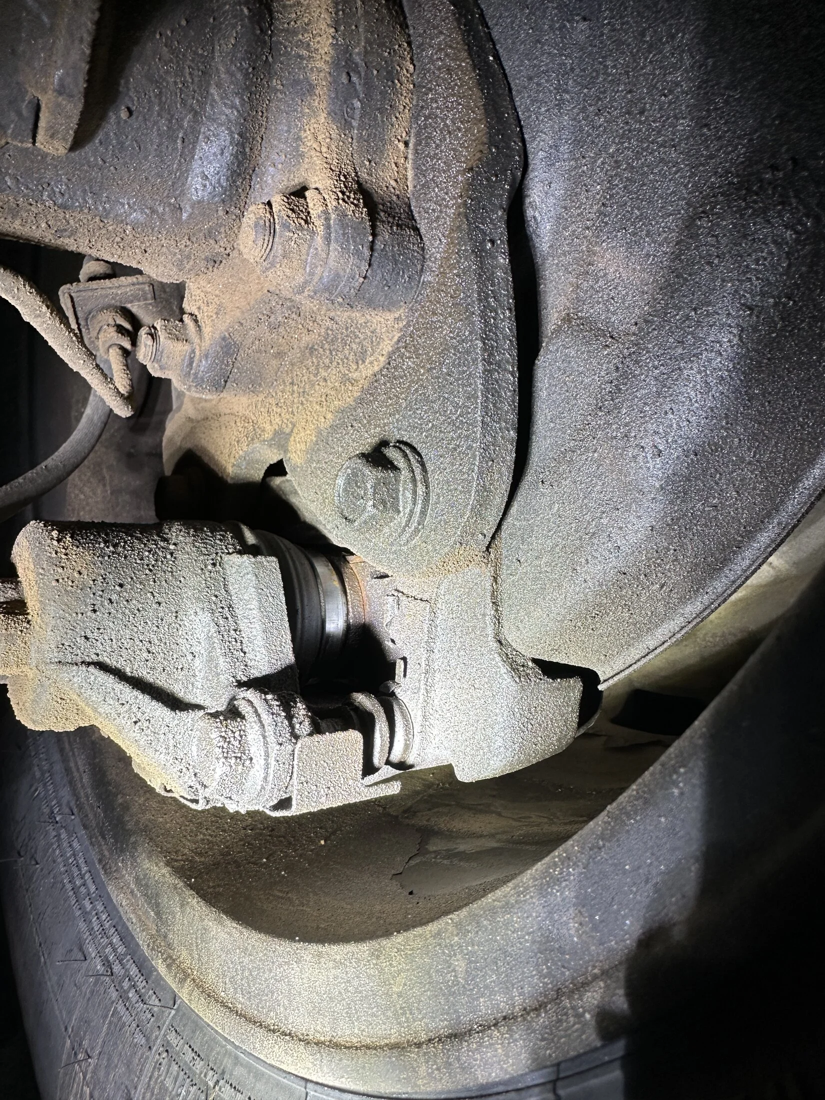

Jumping in here cause just yesterday I was driving back to my house after doing some shooting two hours west of Denver in the mountains. I was noticing an unusual and distinct hissing sound when I stepped on the brakes. Way louder than the usual psshhhh sound the pedal makes. I was in an area where I was about an hour from any cell service and everything was still working so I kept rolling. 10 minutes later I get the VSC warning light, and an ABS light. Everything still working fine, just the hiss. Sun was setting so I doubt I could have stopped and successfully flagged someone down or knocked on a door to use a landline to call a tow. Another 5 minutes later I’m coming down a hill and I hit the bakes and hear an audible pop or similar noise, don’t remember exactly what it sounded like but there was a distinct noise. Instantly I’m down to about 20% of usual braking capacity and there’s a constant alarm like you get if you open the driver’s door without the truck being in park.
Would have been extremely dangerous if I was braking hard on the interstate or coming up to a light. Luckily, I had already been driving very cautiously given something was up, and I was in the middle of nowhere with no other vehicles around. I keep the truck in shiftable mode at all times so I quickly dropped gears and pumped the brakes and kept her under control coming down the steep dirt road I was on. It was a long and slow drive home. By the time I had made it back to service I had already braved 45 minutes of steep winding roads. So the last 10 minutes home were a breeze compared to that, I just stayed on back roads and did 35mph max rather than wait 5 hours for a tow.

Let me know what you guys think about where I should start with this one. I haven’t had time to hook up techstream and my ultragauge isn’t registering the codes thrown.

Good instincts keeping it under control while having a brake issue. Most people would have panicked. And I hear you on having all possible weak spot issues on these rigs. The valley plate leak is the only one I have left to check off yet.
So my truck had a failed rear bearing and it looked like yours, wet with gear oil. If this completely fails it can take out your rear abs sensor and cause a vsc and abs alarm. If I remember correctly @grinchy had same failure mode.
What that doesn’t account for is losing brake fluid.
If you are able you need to pull the caliper off and rotor and see what’s going on. You can unbolt the hub but you won’t get much further without pulling the axle shafts.
Thanks, when I have some time in the next week or so I’ll take it apart and report back.
You can also pull the ABS sensor and look for evidence of contact between the tip and the inner axle hub seal. As the bearing wears out it allows a small amount of play in the axle which can lead to this contact.
