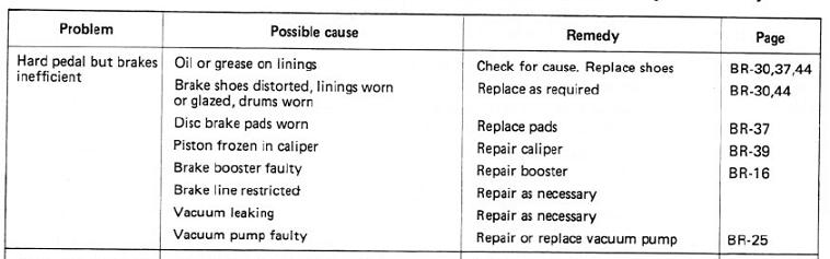

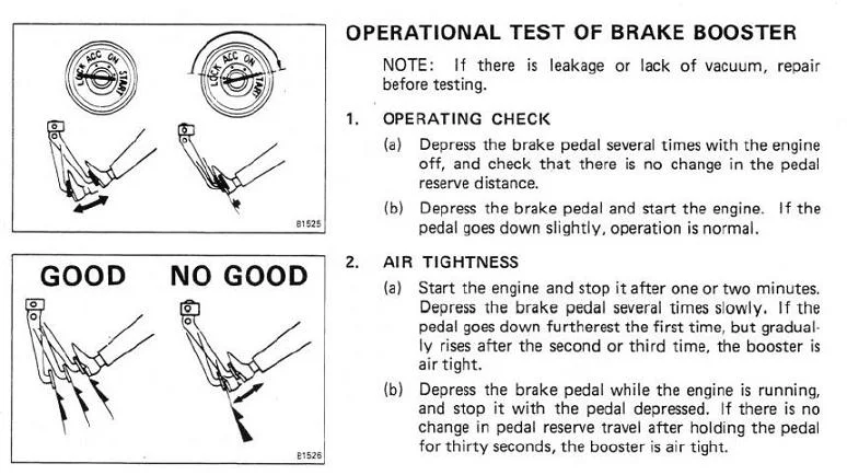

The brake booster needs vacuum to work, so make sure it's connected and the line isn't cracked. There is also a check valve in the body of the booster (where the vacuum hose connects). If this is leaking you might be loosing the vacuum, but I would expect this condition to be a more gradual loss of pedal feel, not a complete absence.
