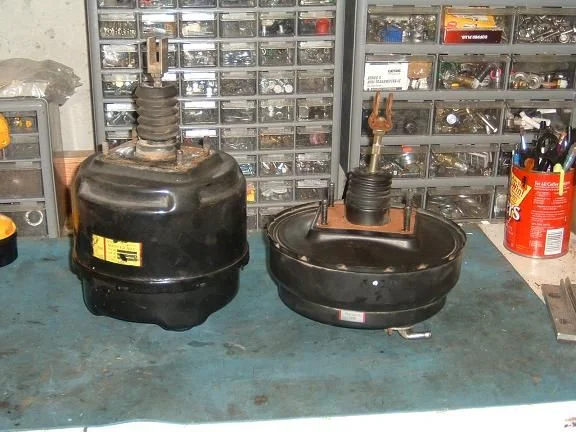

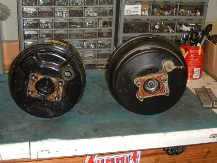

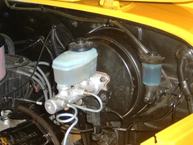

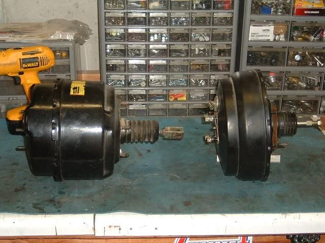

You are probably not going to get a definitive answer on this as there are soooooooo many variables. I know I put a MC from a '97 80-series becuase that is what I could find, the price was right and I trusted the guy as he was certain it was good. While the bolt holes were the same, I had to rotate it 180 degrees to get the vac port closest to the firewall/intake and had to space it out from the firewall ~1/4", cut the shaft to length plus adjust the pushrod. Plus it was about 1" larger in diameter which required some brake line re-routing.....Looking at these things side-by-side one would think there is no way in helll that they could interchange/be made to fit.
I guess the long and short of it is that virtually any Toy booster (minitruck, celica, supra, 60-series, 80-series, whatever) can work and share many similarities, but every one will have it's own particular issues to be dealt with. I would recommend going to a junkyard where you can walk around and pull your own stuff. Take some measurements of what you think will fit and note any special things like diameter, vac port orientation, etc. Yank one and go. I considered buying a reman unit from the autoparts store but I was unwilling to take a $200 risk relying upon the recommendation of someone on the internet...especially when there were sooooooo many differences of option. I could not find the same answers you are looking for. There is a certain amount of creativity and flexibility required to pull things like this off but they are by no means insurmountable. Now go find a junk yard and go take a looksee.
