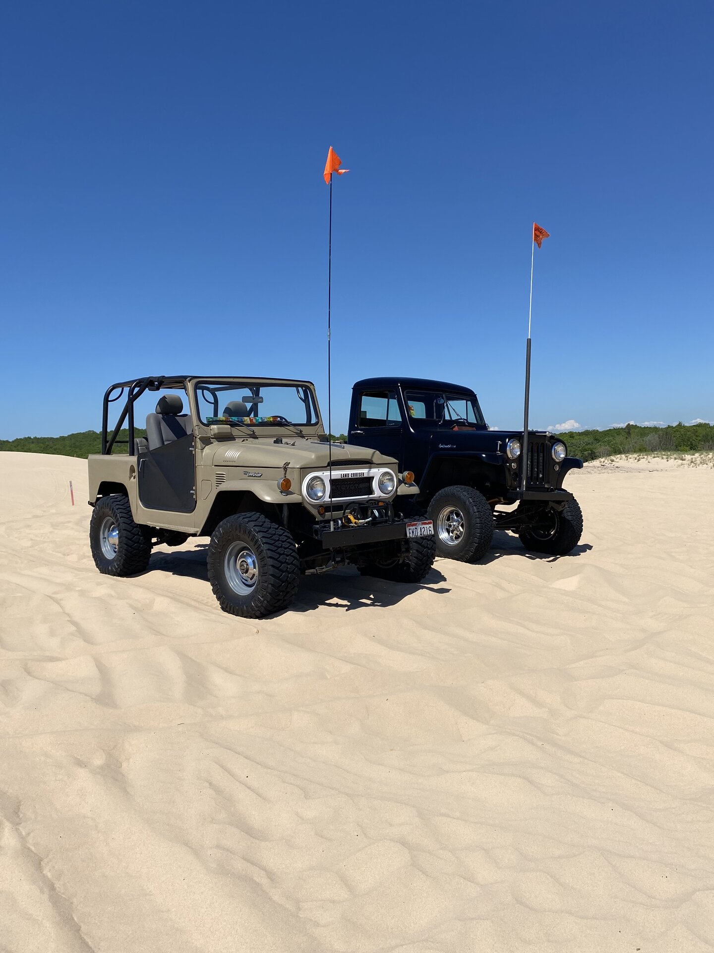

I have a 76 FJ40 with a skyjacker 4" spring lift all around, as well as new bilstein 5125s. The springs are a few years old now and the rear bounces when kids are in the back wheeling. Now, I use this vehicle in the sand. It goes up steep sand dunes on the regular. When struggling on a hill it will start bouncing get traction and bounce again. The rear tires have rubbed in several areas. It seems the the rear springs are too soft. I was thinking of buying a add aleaf from Skyjacker. I was also thinking of flipping the rear springs to increase the wheel base for a better ride possibly. Anyone have issues with skyjackers being bouncy or too soft? Anyone add a leaf?
pic for context
pic for contextView attachment 3366135

She will bounce in big waves of traction, bounce in the air, no traction and down in the sand again. It is enough for the tires to hit the quarters and inner fender wells. None of my friends CJ's do the same. a traction bar cant hurt but I feel that it is more than that.
