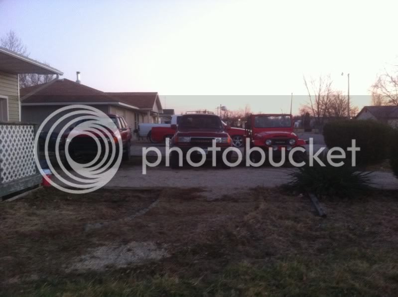

I also gave it a face lift. Pictures are in the other thread.
Picture from today.
Another
Red Toyota fetish? :D
Seems we buy vehicles of the same color a lot. For a while my wife and I had matching a 4runner and pickup, both dark green and with white stripes. Then she got a red Pontiac and then the red started. Now she got a yellow Mustang and I'm dreading the yellow trend. Of course as it stands we have room for one more vehicle but we can't fill that spot because, I liken it to one of those slider puzzles where you have to have an empty space to move vehicles around.
