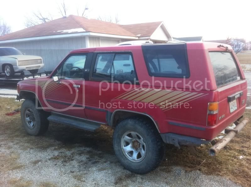

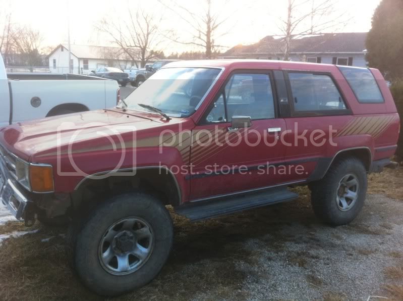

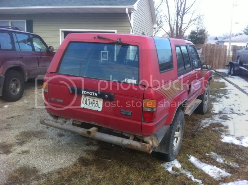

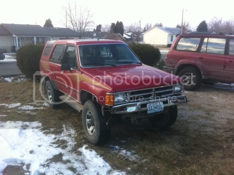

Okay I went and picked the truck up. Of course it is rough but not to far gone to work with.
First off is reclaiming what little power the 4cyl had.
I'm going to replace plugs and wires should help some. Next is curing the backfiring problem. As I decelerate I get a slight backfire. What causes this? Out of time? That could be my big issue if so, and that's a pretty easy fix.
After I get the power back to somewhat normal I'll beat around in it and finally get it all back to presentable.

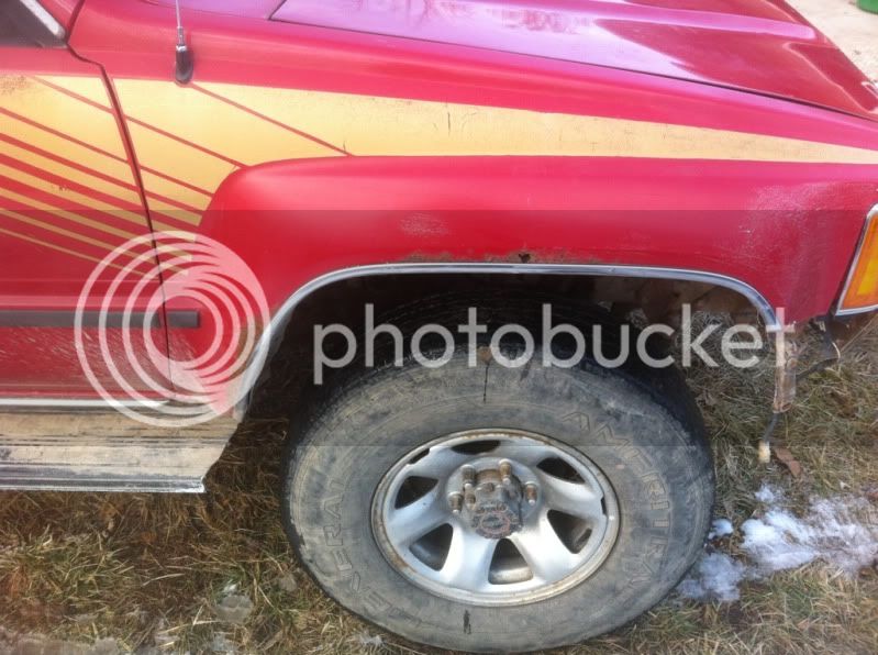

Ewwwwwww auto hubs... I hope they still work! :D

The autohubs still work and will be replaced with manuals once the truck is mechanically sound.
