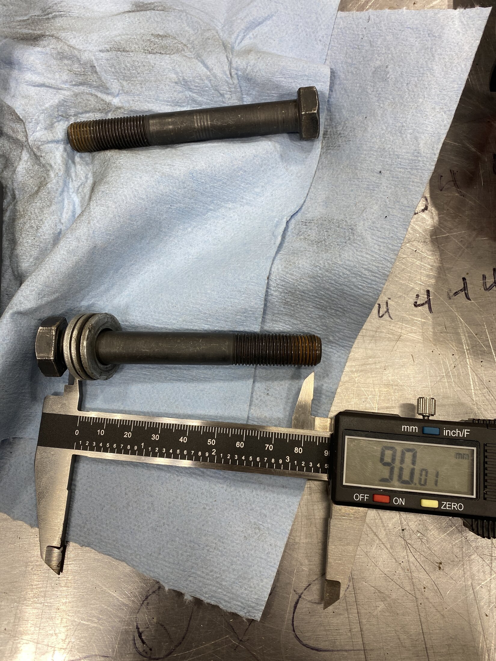

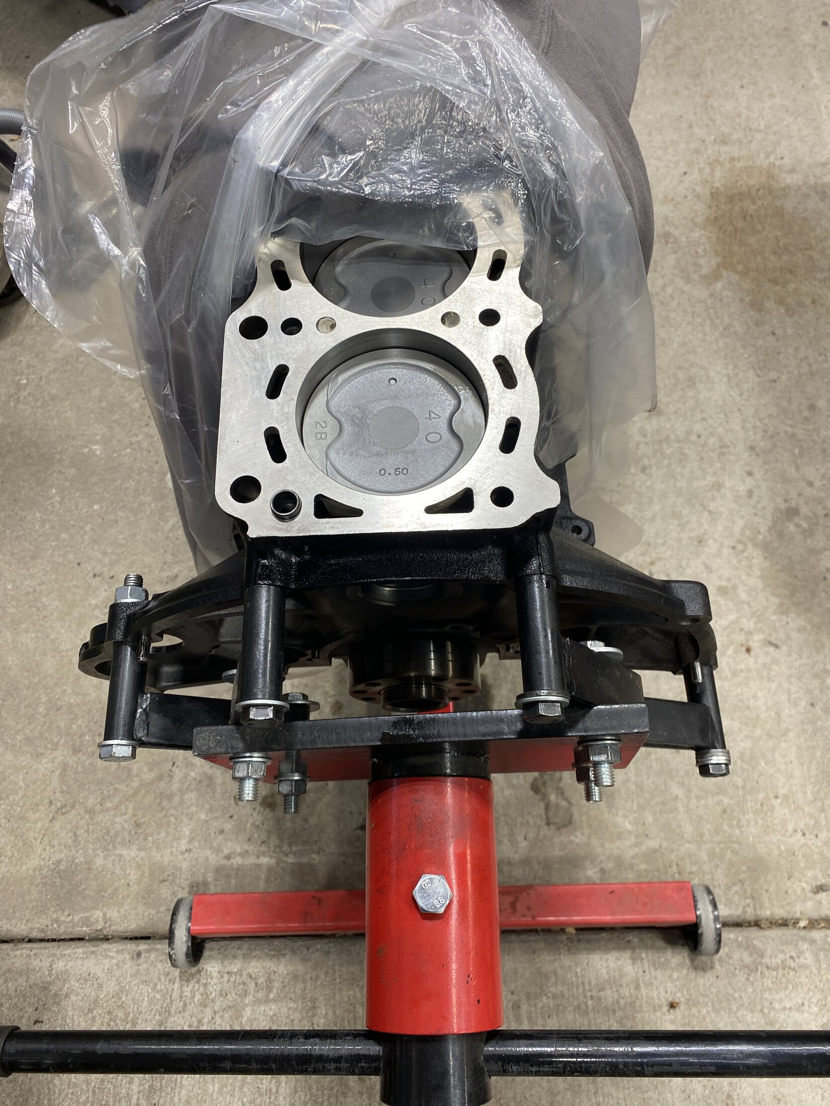

I posted M12 x 1.75 x 30. That is incorrect they are 1.25 pitch! So M12 x 1.25 x 30 is the standard trans to block bolt. My harbor freight 1000lb stand uses 3 90mm long bolts with a couple washers and one M12 x 1.75 x 110mm bolt with nut that goes through the power steering pump stud location like this.
Ack, I need ANOTHER bolt!
