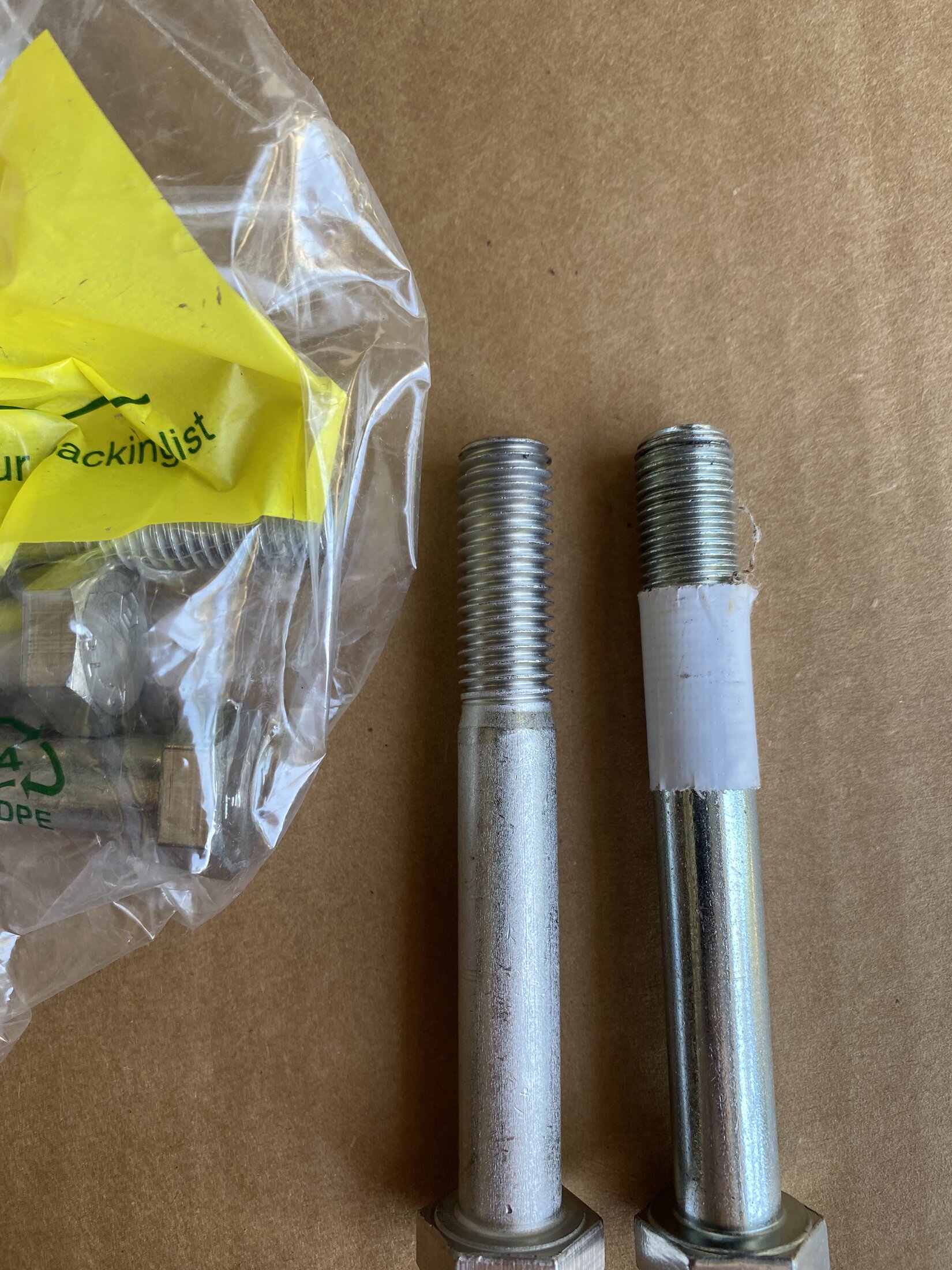

Was given two perfectly-sized bolts for this, 90mm long, "8.8" and what looks like a tie fighter stamped on the head. Need two more. Anyone have the thread spec handy? And do you figure 8.8 will do the trick? Maybe 16mm of thread goes into the block before it bottoms out. Thanks for any help!

Assuming McMaster-Carr sent what I ordered, that’s the wrong (or incomplete) spec. Bolt that fits is on the right.
Head bolts? Not at those prices, though I’m now $25 into the wrong bolts… 😕
