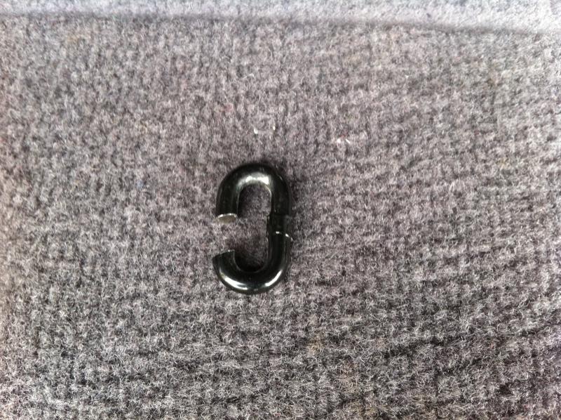

It should work, just go slow. But you also need something to split the ring that you cut off, so you can get it off of the chain.
It doesn’t need to be removed from the chain. I left mine in place and it functioned just fine.
My OCD would not allow that.
Search is your friend, from 2013.
