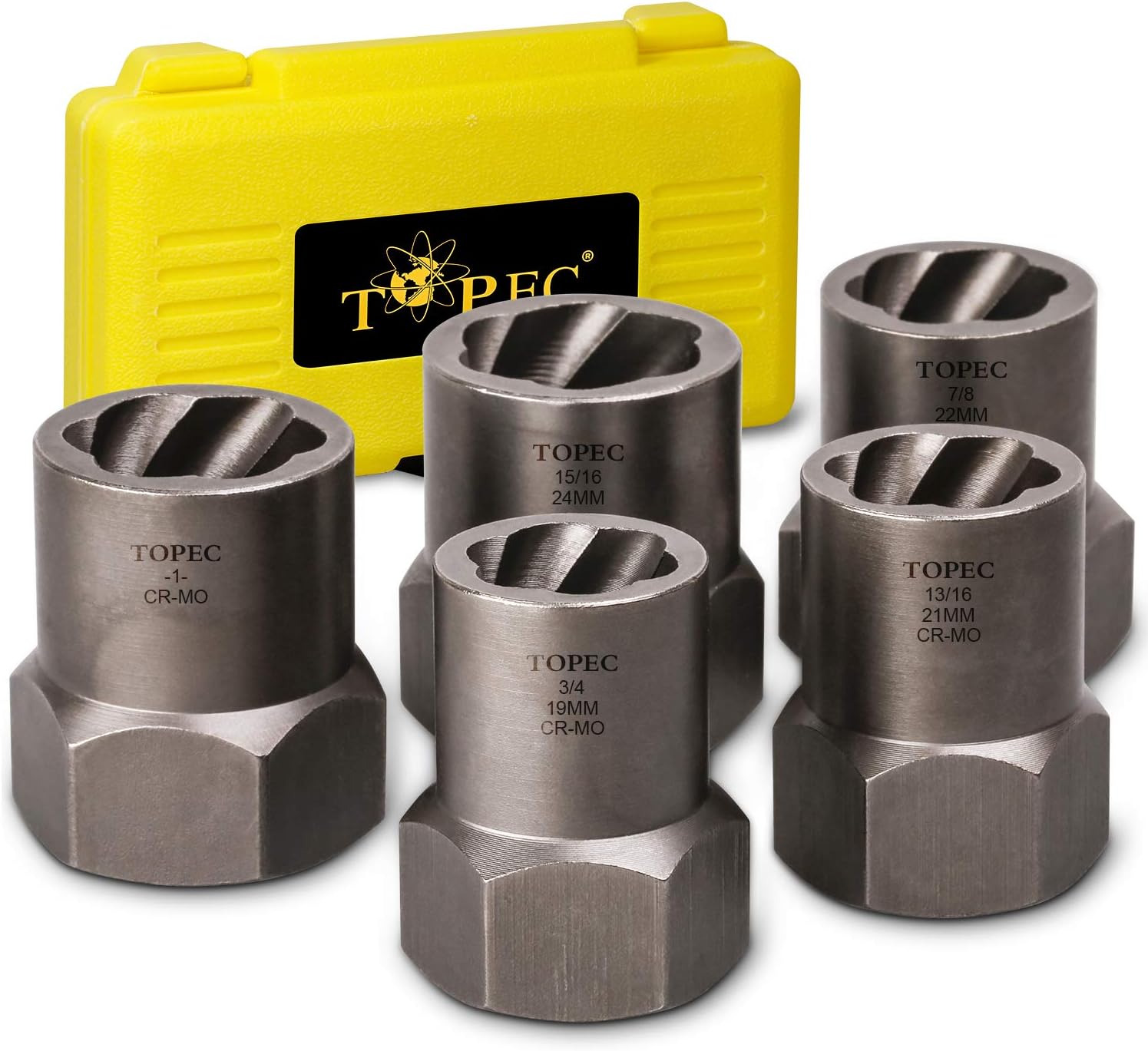

I do not have a welder. I am currently trying to get my keyed lug nut off. I am considering using JB weld to stick a nut on the outside of the lugnuts. Might be an option if you have access to the the stud and you wouldn't end up epoxy welding the nut to the frame.
I replaced all of my locking lugs on my 02 years ago and just did the same on my 06 last week. After 18-23 years of service / tire rotations using the ughhh dougahh guns the key just wears out. I believe they sell universal keys / extractors specifically made for this exact situation.
I have thought about epoxy, but I actually have a 25yr old wire feed 110 welder. I might try this.
Or I might try to figure out a clamp on jig to perfectly center the punch and a “collar” of sorts to further center and align / level the drill bit. I have seen these in wood working.
Keyed lugs, are no match for a cheap tool.
