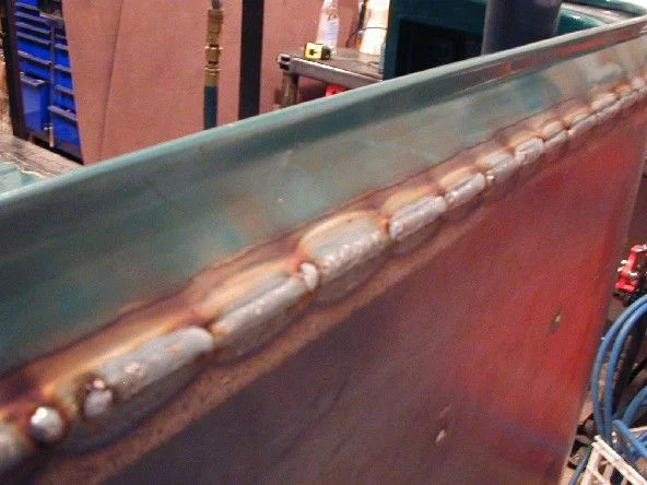

See attached pic.
-Stumbaugh
I did this top with a Mig welder and .025 wire, gas shield. I welded the edges with a spot every 6 inches and then went back over with a continious bead. I did all the sides and then did the arches on each end. I am a s***ty welder but I got it done with zero warpage by going slow and spacing out the welds. 20 ga. sheet stock on 16 ga. supports.
If I can do it a blind monkey can do it!
Cool Trailer.
I agree, it's really not that hard and you made a good point - .023 or .025 wire is key! The thinner wire acts like a resistor and puts less current (heat) through so that there is less warping.
