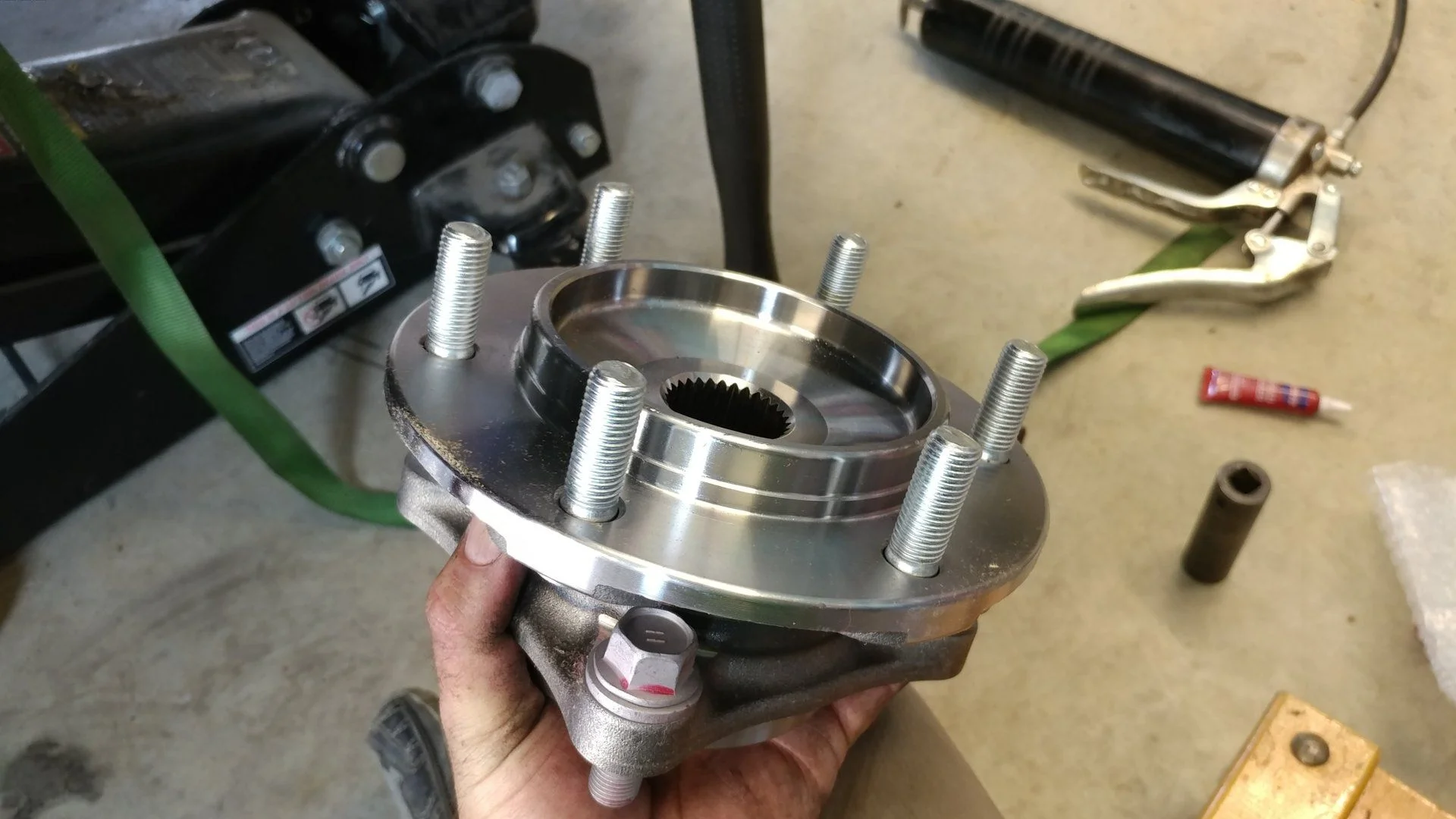

Somebody may have already shared, but in case it hasn't, thought I'd share. If any of you guys need to do your front wheel bearings, I highly recommend www.Bluepitbearings.com
Tony basically builds a unit bearing and sells the complete assembly with all the hardware, ready to drop in.

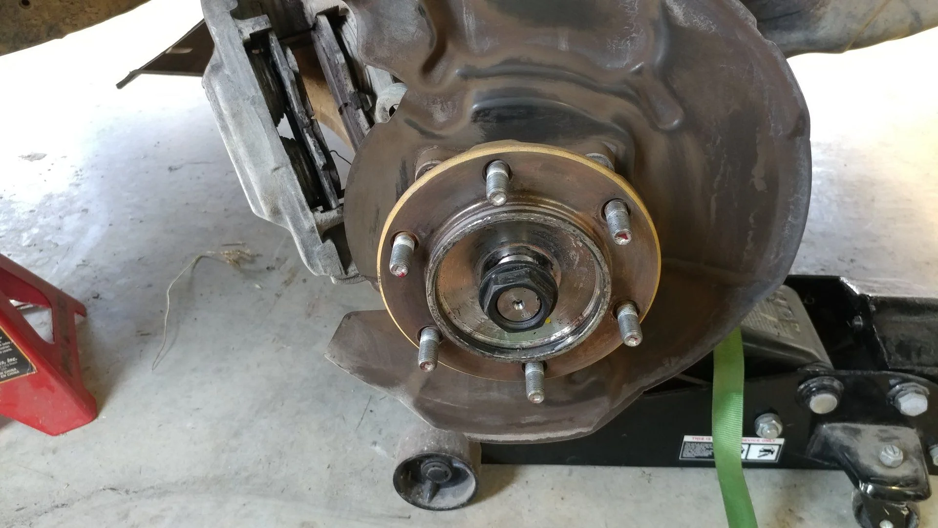

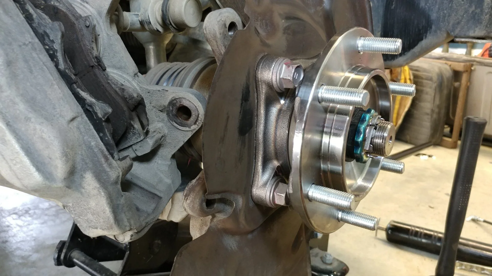

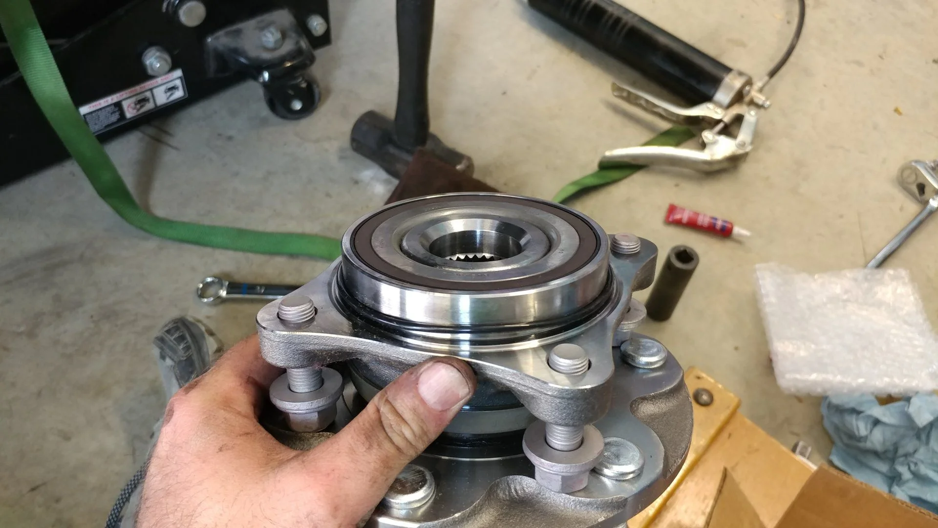

I did the GX this morning in about 2.5 leisurely hours. It really is as simple as take off the wheel, remove the caliper, remove the rotor, 4 bolts and pop out the old, then install the new and reverse the process.
Well made units that bolted right up.
Old
New
