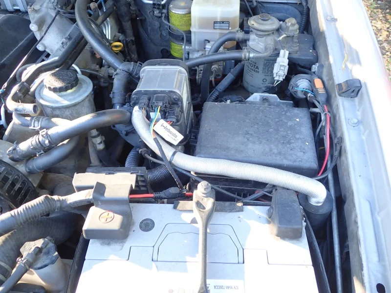

A 400 W block heater is really too small. Good enough for a 1.2 litre engine, not for a land cruiser. I tried it - thought that the manufacturer must be a specialist and that the model specific 400 W frost plug heater would be enough, but it's hardly noticeable even after 5 hours, or more. I gave up on it and got a 1000 W hose heater, which kind of worked, only that the model I got had a problem with leaking. So, I ended up with a compact, fuel burning webasto water heater. Never been happier - this thingy has been running for 8.9 years now, without a hickup and no service. 5 kw of heat started or programmed by sms commands. Heats engine, clears windows and melts snow and ice.

Curious how you plumbed this all in! Have always wanted a Webasto!

HDJ100L. Plumbed in series with the power heater. Fuel from the return pipe just behind the Webasto, under the brake booster. This is a Thermo Top Evo.
