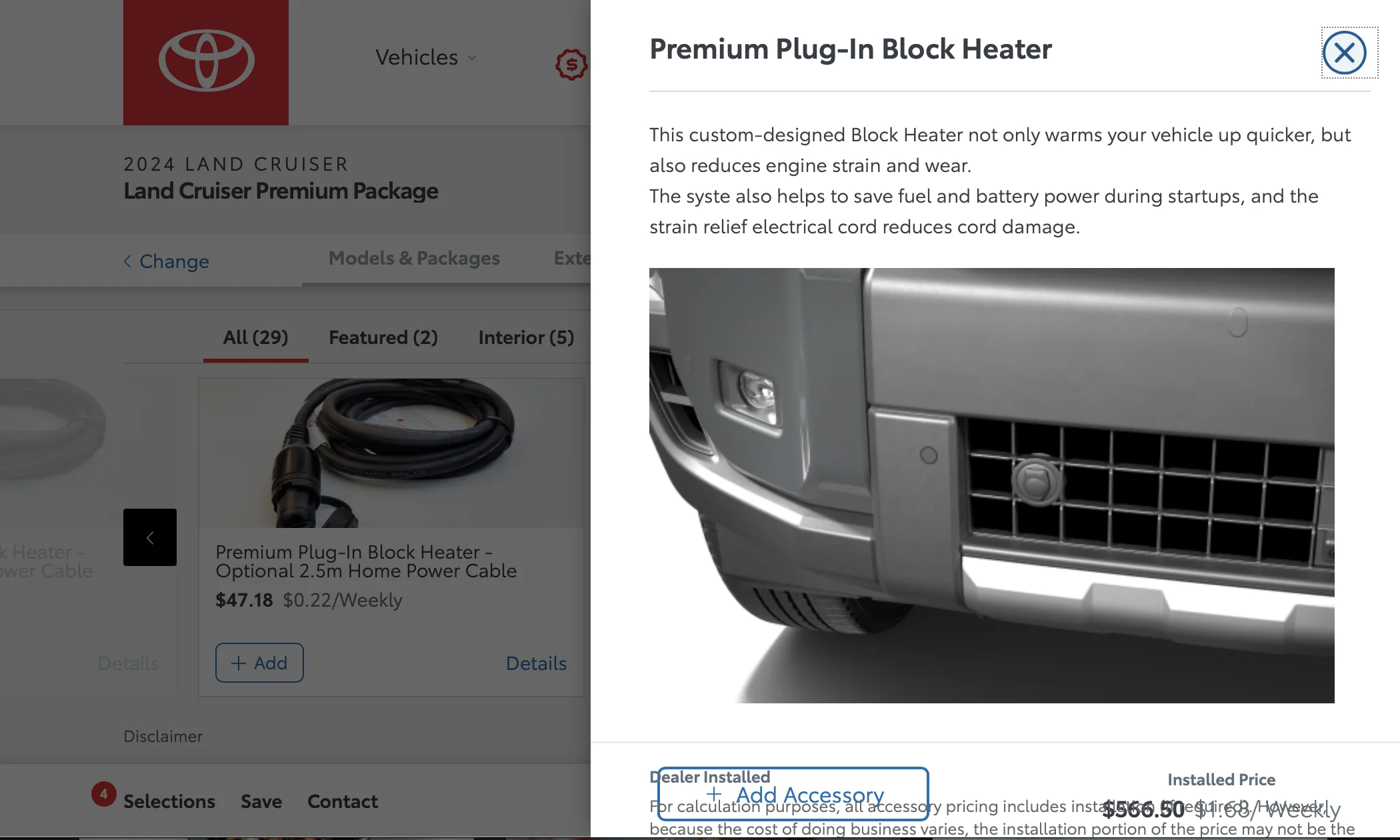

From what I'm seeing, these are available in Canada, but not the US. US dealerships find nothing when they search their databases.
This is the Canadian factory option.

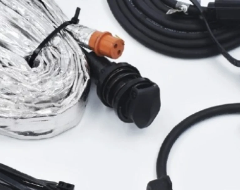

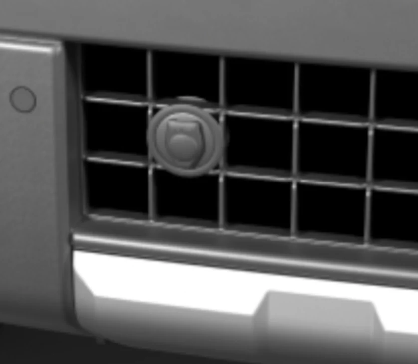

Looking at the pictures of the plug in ports for Canadian dealer installed part, and The Zero Start parts, they look very similar. These might be the same thing...

One change I made was Toyota wants you to install the Plug here:
I found the top left corner to be a far cleaner install, just my preference:
