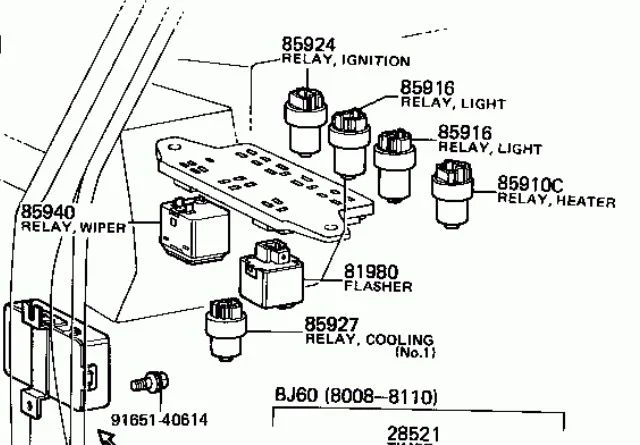

Check the turn signal relay under dash. Driver's side.
Any clue which one I'm aiming for?

Anyone know if these 3 prong male relays will work in the 83 fuse block?
a couple diff companies cross-ref the part number, but the green relay looks lower and blocky.
the electronic one is tempting at 12 bucks too, and will work LEDs also
original part #81980-22070
electronic version 12.00
More Information for TRIDON / NOVITA EP32
thermal version 26.00
More Information for STANDARD MOTOR PRODUCTS EFL25
and the Oreilly part number match 56.00
BWD FC561 - Flasher | O'Reilly Auto Parts
