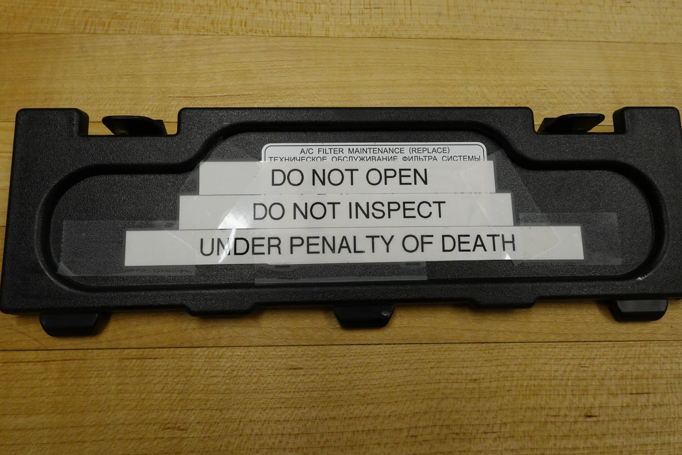

I can now join the club of a broken re-circulation door. Despite have put up a sign on the cabin air filter access stating: No, no, no, no, no, no, DO NOT Inspect, they did it anyway and broke it. It will move to the re-circulation, but will not move to the fresh air position. It just flops around. Now, something else to try and take care of before heading out on my trip on Friday.

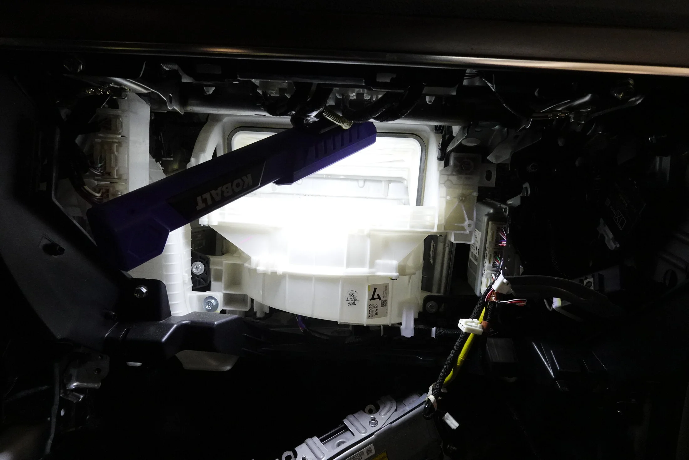

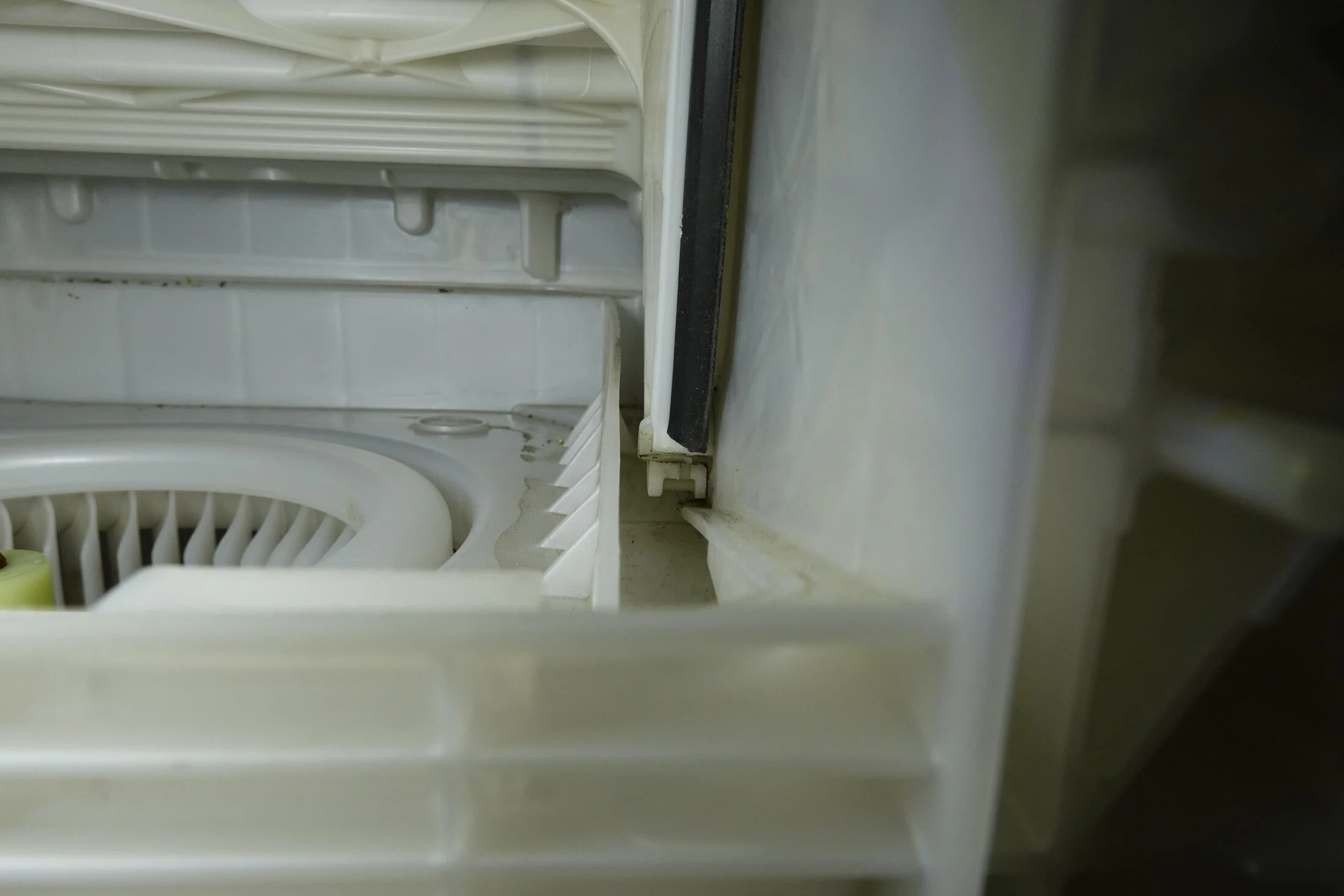

I pulled apart the dash as per the youtube video from ONEngineering to see what was broken. This is what I found:

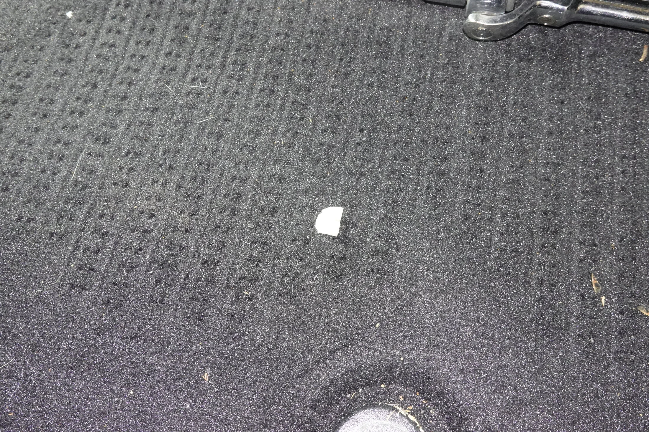

The broken part. Off the bottom of the door.
You can see the shaft and the bottom part of the door around the shaft is missing.

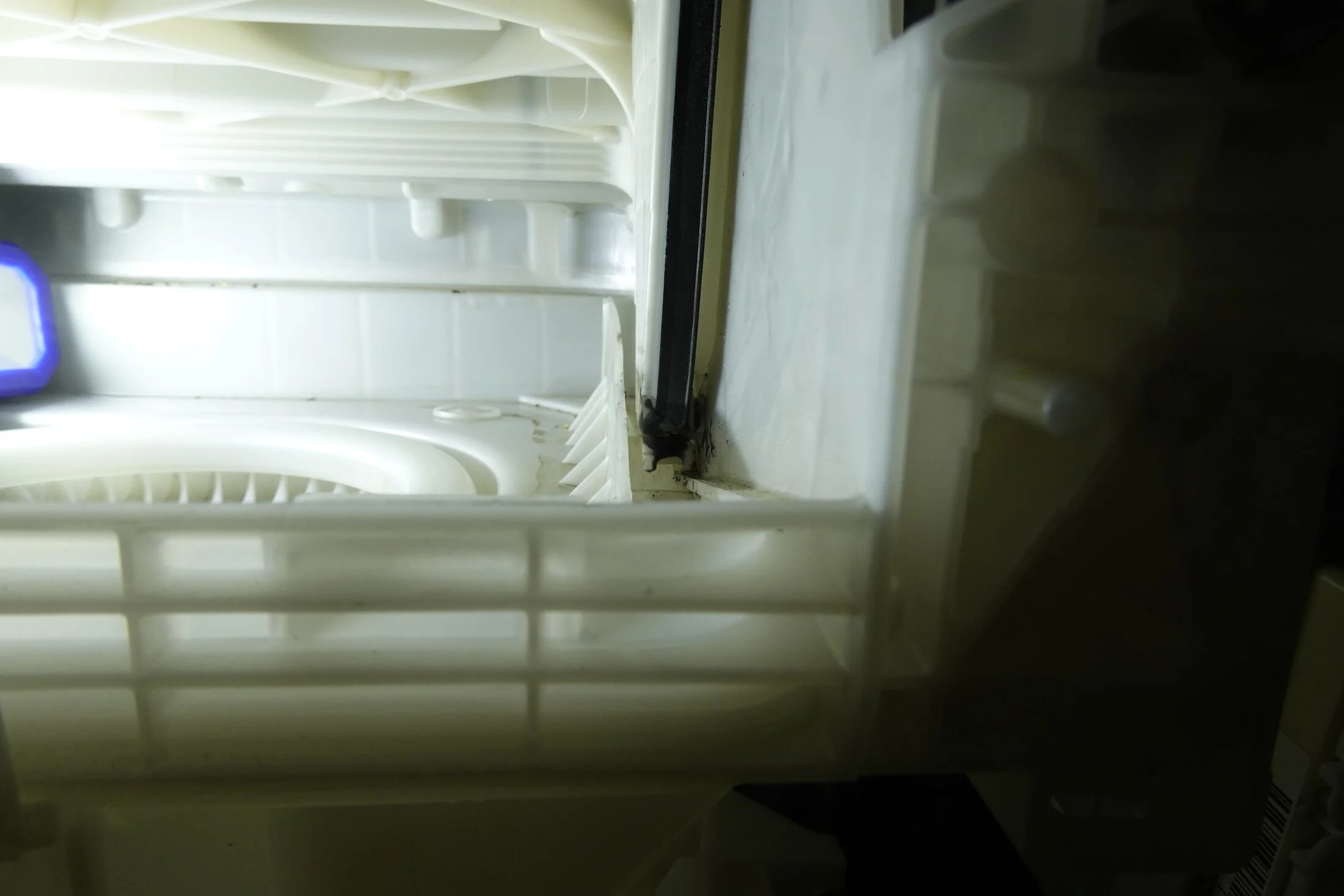

I decided to see if I could glue it back together with JB Plastic Weld.
I did make sure the shaft would rotate and was not inadvertently glued. I also made sure it was in the correct position! It moves freely. Looks messy but that is the best I can do being rather ham-fisted myself and little room to work. I used a long, narrow bladed screw driver to glob the plastic weld in there. Now, to let it set up for several hours before giving it a try.
A view of the whole shootin' match.
I hope this will get the message across. Still gonna lock it next time.
Finger crossed this will work until I can get the thingy from ONEngineering for a more permanent repair. I will order that upon my return.

Just tested the glue job: It works!
Hopefully, it will last until I can do the repair right. Fortunately, it is a low-stress part.
Sign needs to be high visibility yellow or orange with some skulls and stuff
A guillotine in there would be better.
