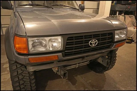

I used rustoleam flat black and cleaned all the parts with acetone before spraying.
Not mine, I believe this is @BoxRocket's grill. I downloaded the image because I want to do the same.

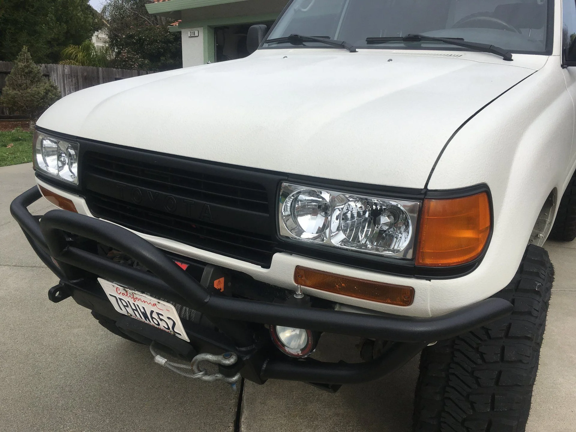

I put Painters tape over the letters and ran my thumbnail around the letters to basically cut the tape so it was only covering them. Then I sprayed it with 5 coats of black plastidip. I pulled the tape immediately after the last coat. It's kind of difficult since the letters are so narrow, it's very easy to smudge the wet paint. Only pic i have so far, I'm very happy with it.

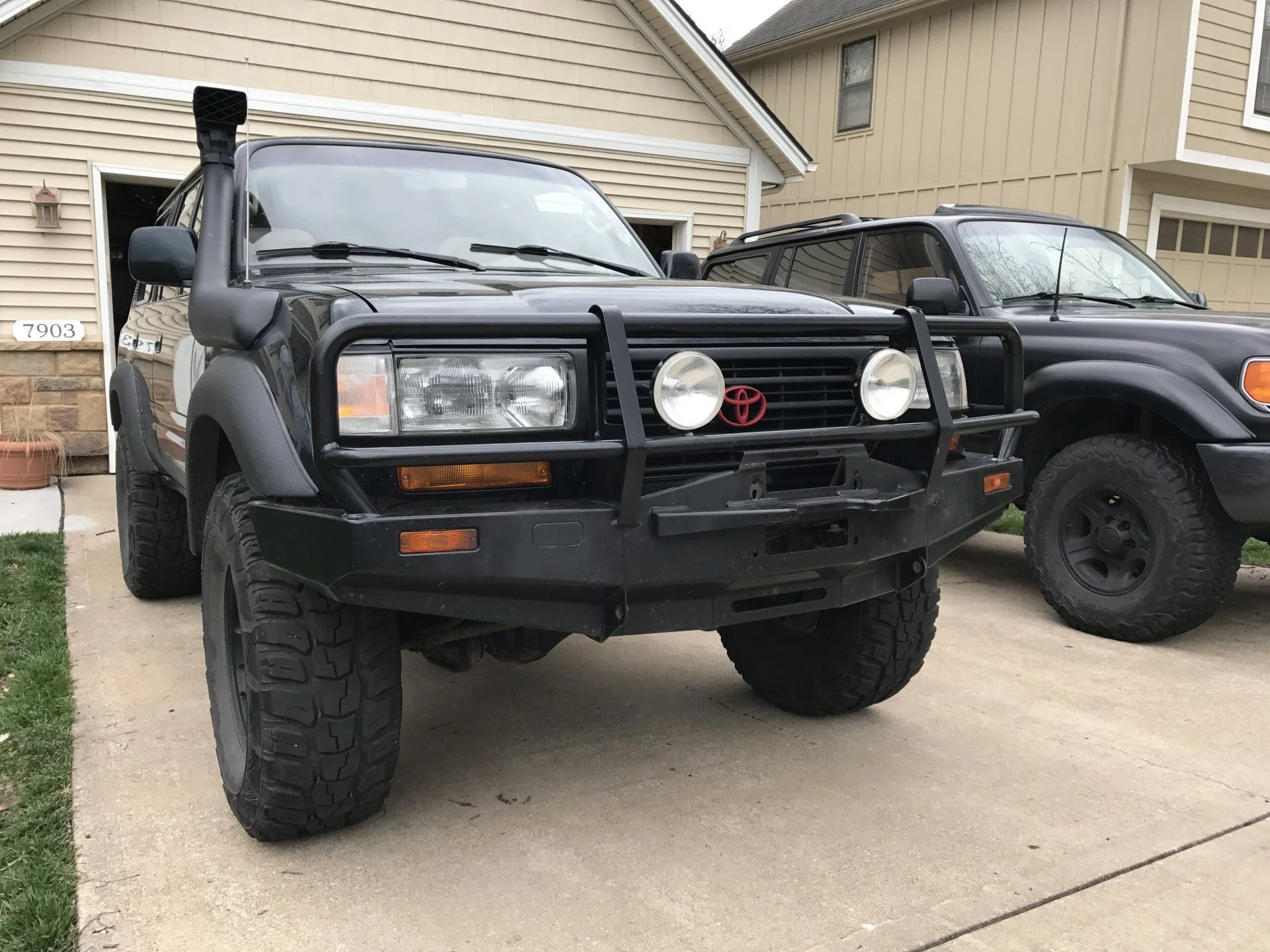

I dipped my front grill in anthracite and the emblem in black:
