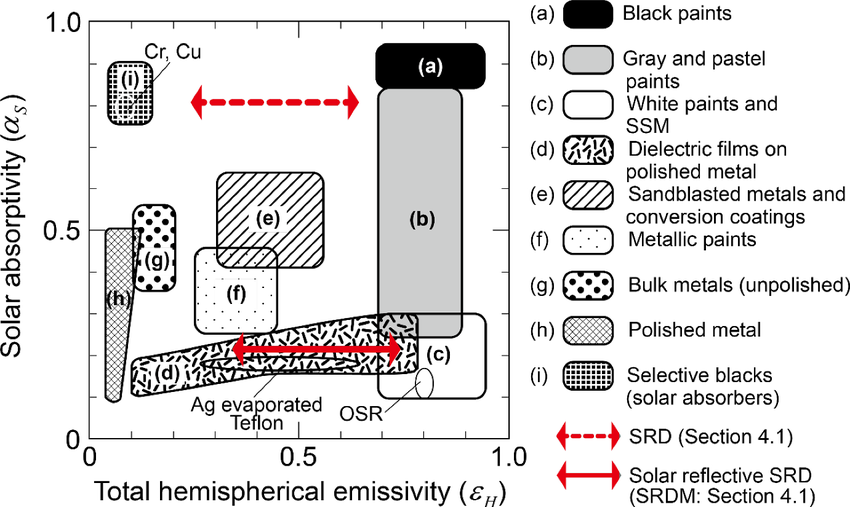

The trick is to get the right balance between absorptivity and emissivity...

The-total-hemispherical-emissivity-and-solar-absorptivity-values-for-various-conventional.png

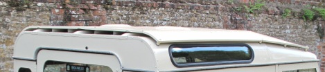

Landrover (I know, I know) safari roof offered a great solution you could rip off..
A secondary roof above the actual roof leaves an air gap. Your actual roof is then always cool in the shade...
That's cool, I've never noticed one of those (and sshhhh, I like Rovers too😉). I'm planning on having a roof rack similar to the one below made, was thinking it may make a little shade and offset the absorption of the black.
